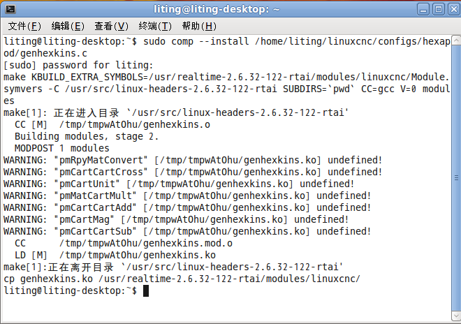

I have added posemath.h, it still told me undefinded?
the error picture in attachment~~

by PKM
Replied by PKM on topic recompile error, genhexkins.c
I'm afraid that you can not use comp for genhexkins.
You have to install run-in-place version of LinuxCNC from source.
Get the source with git wiki.linuxcnc.org/cgi-bin/wiki.pl?Instal..._the_source_with_git
Then resolve build dependencies (2.4) and compile realtime version (2.5)
If everything went OK and you can start RIP version, change genhexkins.c or genhexkins.h at the source tree (/src/emc/kinematics/)
Then just run make in src/ directory and your changes will be applied.

by tiffany
Replied by tiffany on topic recompile error, genhexkins.c
thank for your reply~~~
I have install all git; the error is still~~
and I don't understand your words "If everything went OK and you can start RIP version, change genhexkins.c or genhexkins.h at the source tree (/src/emc/kinematics/)
Then just run make in src/ directory and your changes will be applied."
could you tell me the details? thank you very much~~
forgive me for a newbie~~

26 Dec 2013 15:56 #42023
by ArcEye
Replied by ArcEye on topic recompile error, genhexkins.c
He just means build linuxcnc from sources, then when that builds OK, substitute your new files for the old ones and rebuild

by tiffany
I have install all the things, and I find this could be done by another computer
if I deleted some files without conscious?
I still didn't known what's it~~~

26 Dec 2013 18:32 #42028
by PKM
Did you install LinuxCNC from source?
I don't understand what error you have now.
I mean when you installed LinuxCNC for example to linuxcnc-dev directory, you can go to linuxcnc-dev/src/emc/kinematics and edit genhexkins.c and genhexkins.h or replace them with your versions. Then you should
cd linuxcnc-dev/src/
make
After that you'll have LinuxCNC with your kinematics.
Run it from terminal
cd linuxcnc-dev/
. ./scripts/rip-environment
linuxcnc
make
cd linuxcnc-dev/
linuxcnc

by tiffany
I actually did as what you said, and I can open the hexapod interface by terminal;
but if I recompile genhexkins.c it will show error about undefined
or if I open cnc by application->cnc->linuxcnc->hexapod/hexapod_sim
also has the error about unkown symbol in modules~~
