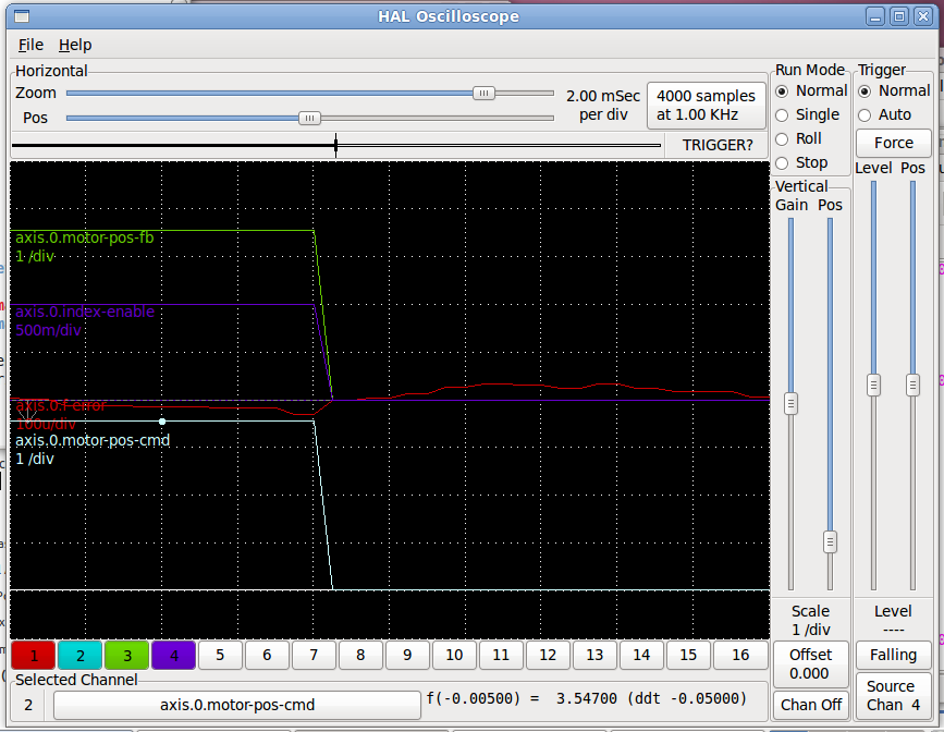

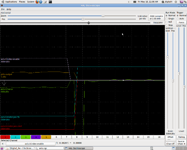

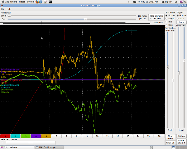

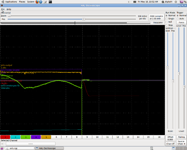

16 May 2014 23:17 - 16 May 2014 23:21 #46986
Replied by Todd Zuercher on topic Linear scale correction: homing to index
Here are the interesting bits of data from the halscope log files
first home
2nd home
first home
axis.0.motor-pos-cmd -0.90056175865191 axis.0.motor-pos-fb -0.90026276480807 axis.0.f-error -0.00032023879384 axis.0.index-enable +1.00000000000000 pid.x.output +0.75501974447387 (null) +0.00000000000000 (null) +0.00000000000000 (null) +0.00000000000000
axis.0.motor-pos-cmd -0.90054051370191 axis.0.motor-pos-fb -0.90026276480807 axis.0.f-error -0.00029899384384 axis.0.index-enable +1.00000000000000 pid.x.output +0.75501974447387 (null) +0.00000000000000 (null) +0.00000000000000 (null) +0.00000000000000
axis.0.motor-pos-cmd -0.90051926875191 axis.0.motor-pos-fb -0.90021367741631 axis.0.f-error -0.00032683628560 axis.0.index-enable +1.00000000000000 pid.x.output +0.68332437153908 (null) +0.00000000000000 (null) +0.00000000000000 (null) +0.00000000000000
axis.0.motor-pos-cmd -0.90019604324952 axis.0.motor-pos-fb -0.90021367741631 axis.0.f-error +0.00000000000000 axis.0.index-enable +0.00000000000000 pid.x.output +0.70568971392504 (null) +0.00000000000000 (null) +0.00000000000000 (null) +0.00000000000000
axis.0.motor-pos-cmd +0.00004908739176 axis.0.motor-pos-fb +0.00004908739176 axis.0.f-error -0.90024513064127 axis.0.index-enable +0.00000000000000 pid.x.output +0.00000000000000 (null) +0.00000000000000 (null) +0.00000000000000 (null) +0.00000000000000
axis.0.motor-pos-cmd +0.00004908739176 axis.0.motor-pos-fb +0.00004908739176 axis.0.f-error +0.00000000000000 axis.0.index-enable +0.00000000000000 pid.x.output +0.00000000000000 (null) +0.00000000000000 (null) +0.00000000000000 (null) +0.00000000000000
axis.0.motor-pos-cmd +0.00009817478351 axis.0.motor-pos-fb +0.00009817478351 axis.0.f-error -0.00004908739176 axis.0.index-enable +0.00000000000000 pid.x.output +0.00000000000000 (null) +0.00000000000000 (null) +0.00000000000000 (null) +0.00000000000000
axis.0.motor-pos-cmd +0.00009817478351 axis.0.motor-pos-fb +0.00009817478351 axis.0.f-error +0.00000000000000 axis.0.index-enable +0.00000000000000 pid.x.output +0.00000000000000 (null) +0.00000000000000 (null) +0.00000000000000 (null) +0.00000000000000
2nd home
axis.0.motor-pos-cmd -0.00019936658560 axis.0.motor-pos-fb -0.00009817478351 axis.0.f-error -0.00012243675208 axis.0.index-enable +1.00000000000000 pid.x.output +0.59577809168124 (null) +0.00000000000000 (null) +0.00000000000000 (null) +0.00000000000000
axis.0.motor-pos-cmd -0.00017812163560 axis.0.motor-pos-fb -0.00004908739176 axis.0.f-error -0.00015027919384 axis.0.index-enable +1.00000000000000 pid.x.output +0.69876745628810 (null) +0.00000000000000 (null) +0.00000000000000 (null) +0.00000000000000
axis.0.motor-pos-cmd -0.00015687668560 axis.0.motor-pos-fb -0.00004908739176 axis.0.f-error -0.00012903424384 axis.0.index-enable +1.00000000000000 pid.x.output +0.69876745628810 (null) +0.00000000000000 (null) +0.00000000000000 (null) +0.00000000000000
axis.0.motor-pos-cmd -0.00013563173560 axis.0.motor-pos-fb +0.00000000000000 axis.0.f-error -0.00015687668560 axis.0.index-enable +1.00000000000000 pid.x.output +0.64174430191708 (null) +0.00000000000000 (null) +0.00000000000000 (null) +0.00000000000000
axis.0.motor-pos-cmd +0.00001763416680 axis.0.motor-pos-fb +0.00000000000000 axis.0.f-error +0.00000000000000 axis.0.index-enable +0.00000000000000 pid.x.output +0.64174430191708 (null) +0.00000000000000 (null) +0.00000000000000 (null) +0.00000000000000
axis.0.motor-pos-cmd +0.00003165755039 axis.0.motor-pos-fb +0.00004908739176 axis.0.f-error -0.00003145322496 axis.0.index-enable +0.00000000000000 pid.x.output -2.58818630098118 (null) +0.00000000000000 (null) +0.00000000000000 (null) +0.00000000000000
axis.0.motor-pos-cmd +0.00004207015078 axis.0.motor-pos-fb +0.00004908739176 axis.0.f-error -0.00001742984137 axis.0.index-enable +0.00000000000000 pid.x.output -1.02336793814546 (null) +0.00000000000000 (null) +0.00000000000000 (null) +0.00000000000000
axis.0.motor-pos-cmd +0.00004887196796 axis.0.motor-pos-fb +0.00004908739176 axis.0.f-error -0.00000701724098 axis.0.index-enable +0.00000000000000 pid.x.output -1.05854957534516 (null) +0.00000000000000 (null) +0.00000000000000 (null) +0.00000000000000
Last edit: 16 May 2014 23:21 by Todd Zuercher.

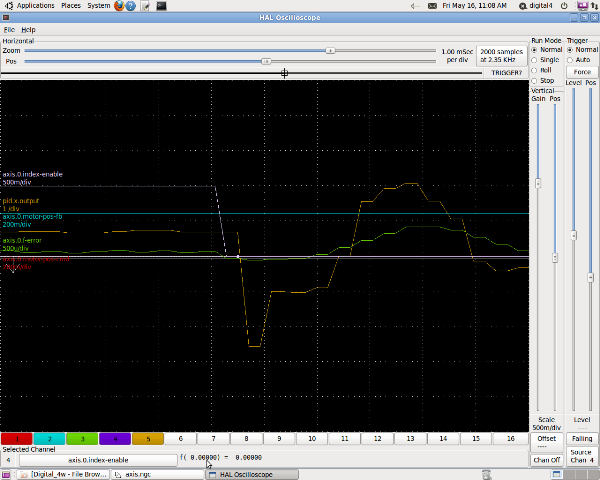

17 May 2014 02:52 #46993
Might this be as simple as an ordering problem in my hal file. or is it a deeper problem.
- Posts: 19104
- Thank you received: 5276
17 May 2014 03:41 #47001
Replied by PCW on topic Linear scale correction: homing to index
The basic thread ordering in the hal file you posted looks right (I assume this is the exact one you are using)
cradek on IRC suggested that you add the encoder position to the plot as this is a more direct indication of what
the hardware is doing.
On my test machine I tried linuxcnc 2.5.0, 2.5.4 and 2.7-pre0 and in all cases
index enable falling happens at the same time as the count is cleared (which is correct)

17 May 2014 03:56 #47002
by DaBit
Replied by DaBit on topic Linear scale correction: homing to index
I tried a fresh 'git clone git://git.linuxcnc.org/git/linuxcnc.git linuxcnc-dev' and build cycle. That is master, right?
Made no difference using the same HAL/INI; count is cleared one cycle after the falling edge of index-enable. Somehow I didn;t save the HALscope screenshot; will do that again.
I still have to try with a minimal config.

17 May 2014 03:59 - 17 May 2014 04:08 #47003
what hal file did you start with?
(and I dont think this is linuxcnc version dependent as I tried 2.5.0, 2.5.4, and 2.7-pre0 with the same (correct) results)
