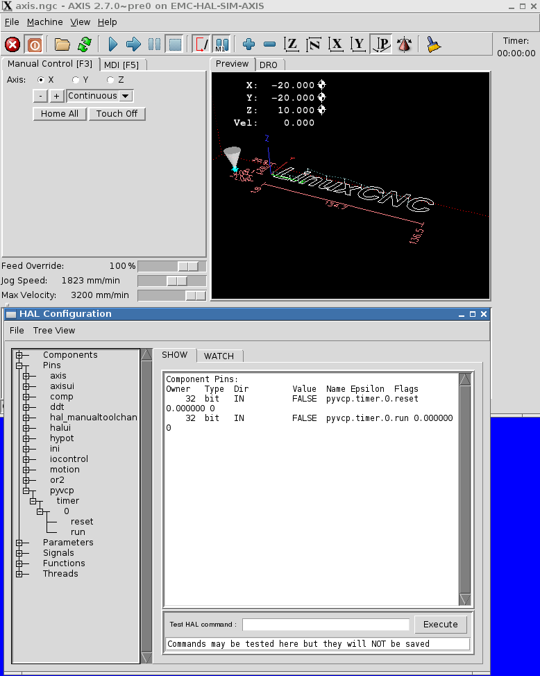

26 May 2014 18:27 #47339 by ArcEye
I am losing my marbles I think.
There is already a timer in pyvcp_widgets, it is just not documented
I had forgotten about it.

You just need to have something like this in your .xml file
<?xml version='1.0' encoding='UTF-8'?>
<pyvcp>
    <vbox>
	<label>
	    <text>"Timer:"</text>
	</label>
        <timer>
	</timer>
    </vbox>
</pyvcp>
and you will get this
As you can see there are two pins, run and reset, the header of the code describes how to use them
At some point I will get around to documenting it properly
regards
