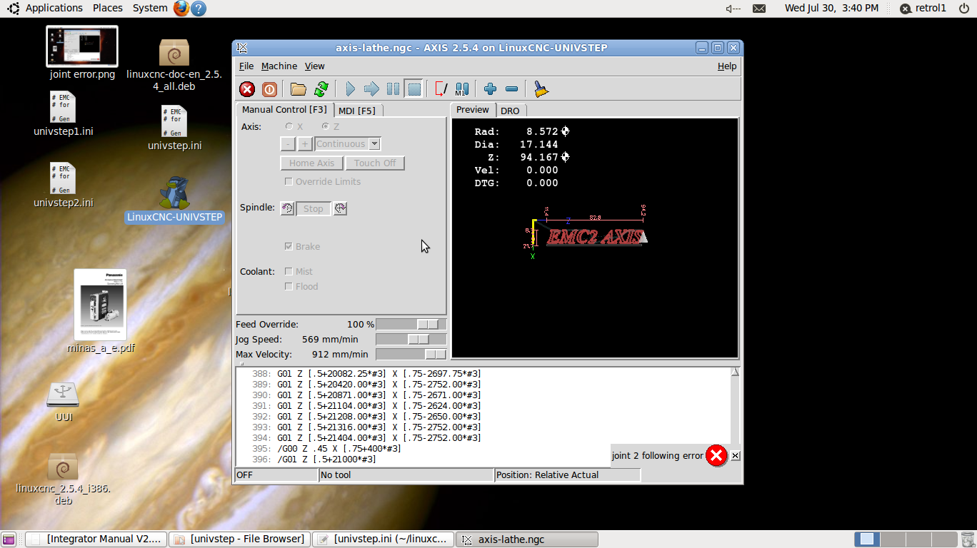

When i set my maximum velocity over 75 mm /min . i get this error message.
how do i rectify this?
thanks in advance
vallab
thanks in advance
vallab

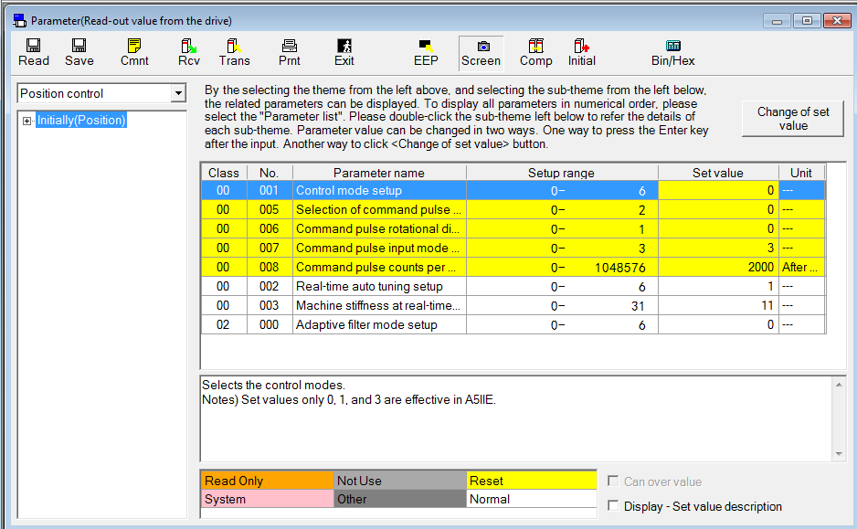

30 Jul 2014 17:43 - 30 Jul 2014 17:46 #49284
by skvallab
Replied by skvallab on topic Line 0 following error
thank you so much jon for your offer.
i am attaching my univstep.ini file with this post
and pics of error messages.
and servo pulse input screenshot
regards
vallab
regards
vallab

- skvallab
- Posts: 34
31 Jul 2014 14:09 - 31 Jul 2014 14:17 #49325
by skvallab
Getting joint 3 following error. I am not using that axis.
what might be the reason. i suspect EMI problem.
If i set P =2000
i am getting the joint following error at the start.
reduced it to 200 it is working ok.
getting occasional errors though.
regards
vallab
If i set P =2000
regards
vallab
Last edit: 31 Jul 2014 14:17 by skvallab.
- jmelson
- Posts: 820
- Thank you received: 157
31 Jul 2014 21:59 #49352
by jmelson
You would have to go through all the .hal files and remove anything that refers
to the 4th axis. But, a quick fix would be to set the MIN_FERROR on that axis
to a large number, like 1000.
You can also turn up the value of MIN_FERROR, it is currently set to .001, which is
pretty small in mm units.
Replied by jmelson on topic Line 0 following error
If you are not using the A axis, then you ought to remove it from the configuration.Getting joint 3 following error. I am not using that axis.
You need to learn how to use Halscope to view what is happening as you move the axes.
If i set P =2000
regards
vallab
