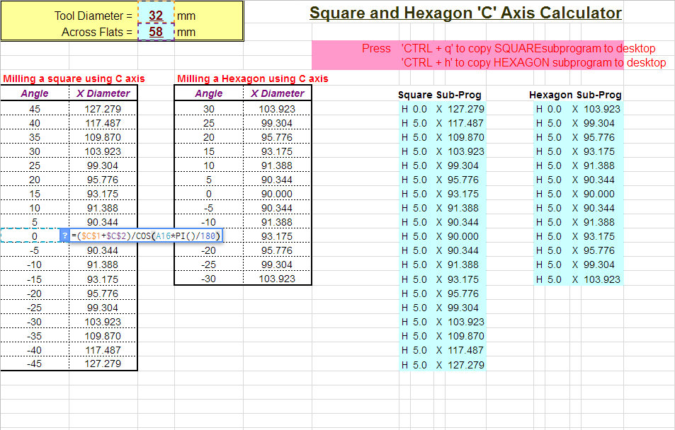

If you program a arc in XC plane with the right maths the result can be a straight line? as far i remember, to do a straight line the X axis moves upwards and downwards with constant rotation of C.
something like
btw, a couple years back I worked on a Okuma with C axis that have a XC to XY interpolation, and was very easy to program like this way, just like normal XY coordinates
João
something like
G1 X100 C0
G3 X100 C90 R"x"
