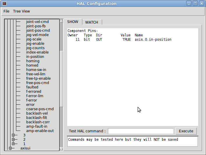

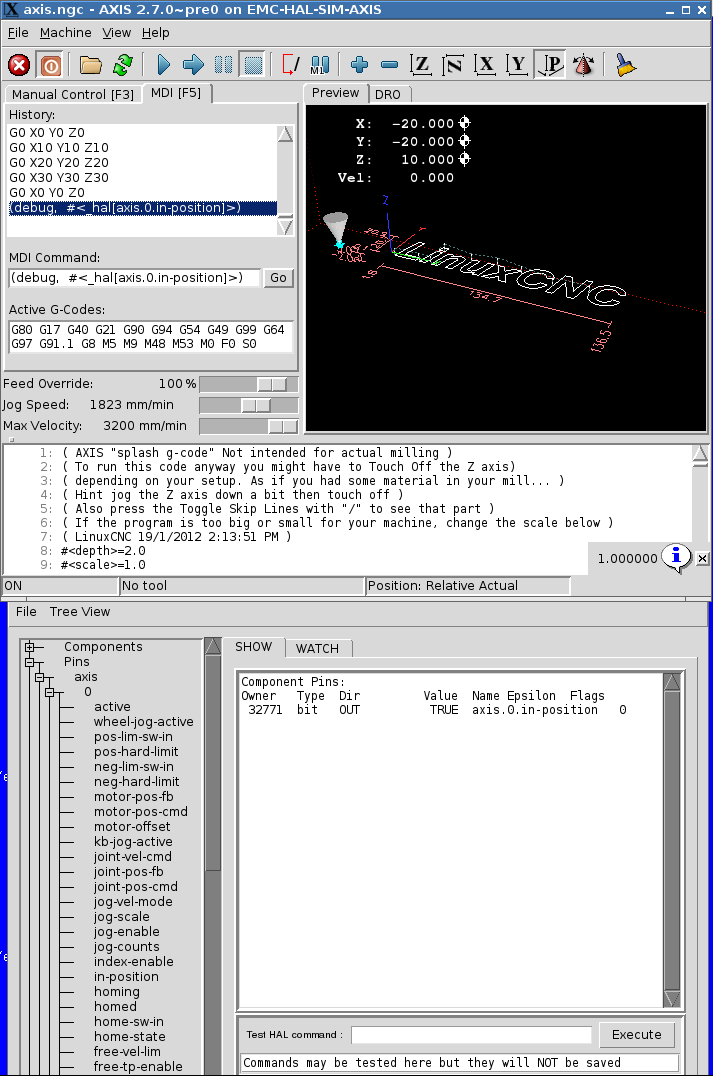

It works fine
Instructions are here
www.linuxcnc.org/docs/devel/html/remap/s...d_sub_ini_features_a
Add to the [RS274NGC] section of the ini file
FEATURES = 8
Below the result

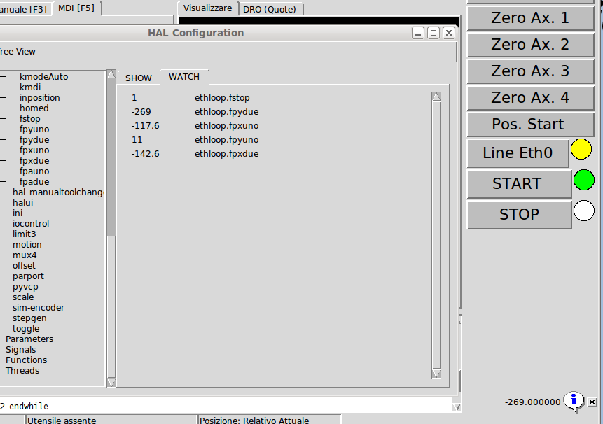

I try with your same pin.....
I try with my custom pin .....

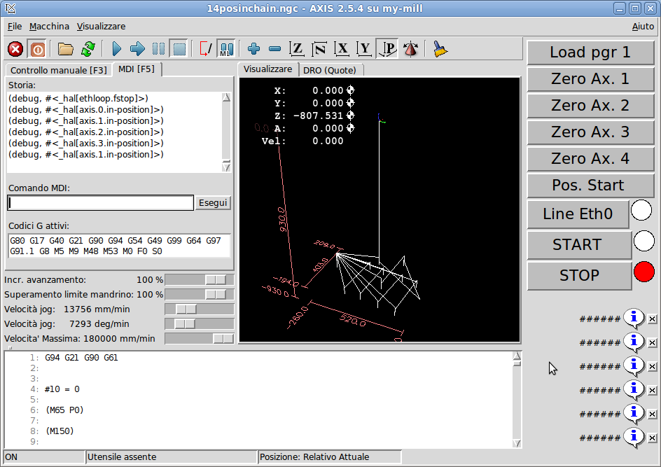

while [#<_hal[ethloop.fstop] EQ 1]

Which version of LinuxCNC are you using? G-code access to HAL only appeared in 2.6.
The predefined, named parameters ought to work in 2.6: www.linuxcnc.org/docs/html/gcode/overview.html#sec:parameters
But those were not there in 2.5: www.linuxcnc.org/docs/2.5/html/gcode/ove....html#sec:parameters
So perhaps you are running a 2.5 version?
Incidentally, you might want to look at the Machinekit project, that is completely re-working the internal communications of LinuxCNC which might make what you are trying to do a lot easier.
Replied by andypugh on topic c++ grab in position signal
... I get ######(debug,#<_hal[e.fstop]>... I get ###### with FEATURES=12 and 28 too(debug,#<_x>

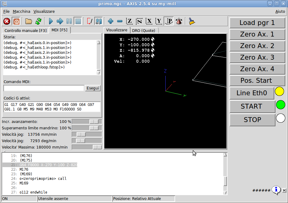

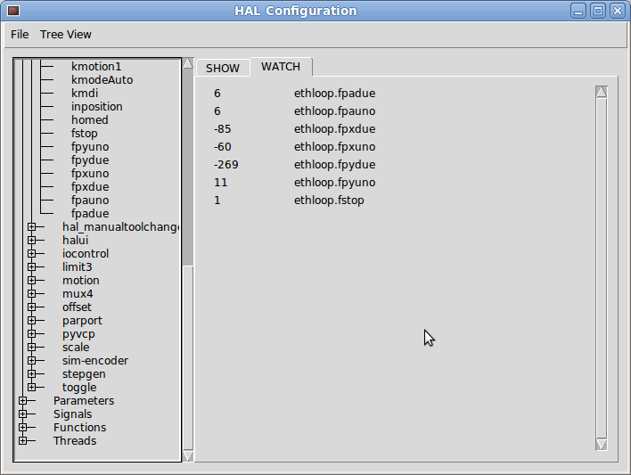

ok it works!
... new linuxcnc-dev compiler have found an error on one my comp .... nothing of special ... an unused variable
now with in ini file
one comment about infinite loop in gcode: Now I try it directly, but the same problem I had seen in the past. Linuxcnc trajectory planner (I don't now how it work....) but must have some sort of buffer. In fact, if I run an infinite loop with the variable X#<_hal[e.fpxdue]> that is updated with a command M160 UP and later a M170 DOWN command, must insert an M66 that says when the variable X#<_hal[e.fpxdue]> is updated. Otherwise the gcoge runs n times until for some magic trick decides to refresh the variable X#<_hal[e.fpxdue]> alone. I think that when its buffer is full deletes, and updates of new variables.
[RS274NGC]
FEATURES = 28 ##or 8 or 12 it is the same for my result, this is try.
PARAMETER_FILE = linuxcnc1.var
