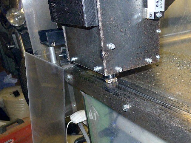

Totally offtopic: my scratch-built CNC machine made it's first cut yesterday, and I am sooooo happy!
Still far from 'finished'; I have a gazillion small issues to resolve and jobs to do.
Gantry style mill, 25mm indexed endmill, cutting steel. Some say that cannot be done on a gantry mill :P
Absolutely boring video, except for the person who is already spending a year on construction of that machine:
