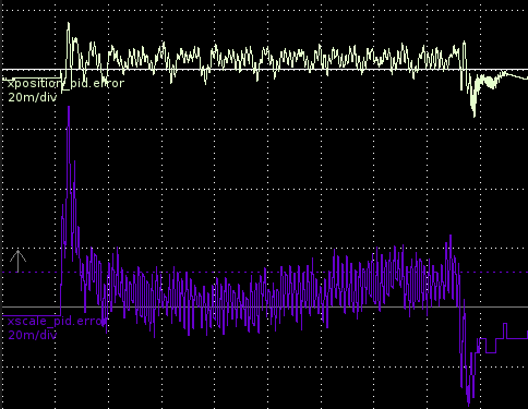

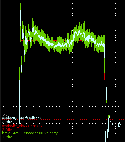

OK. so the answer to my original question is 'both'. I implemented an inner velocity loop, outer position loop, and used gain scheduling on the position loop based on position error.
Inner velocity loop, response to a small velocity step. That one is the worst case situation as PCW explained earlier. Resonances are mechanical; this servo uses a fairly long belt to drive the ballscrew.
I used a biquad filter on the velocity signal to smooth out the worst jitter without introducing much delay so I could use a bit more Dgain. Dgain is important in torque mode.
Current Fcutoff is 800Hz, Q=0,707 to get a flat response.
Positioning error when doing a 10 meter/minute (~400ipm) move. Scale is 0,02mm/division (0.00078"/div).
The cheap 5um Chinese scale on the X axis attaches it's carriage with a thin spring. That is clearly visible in the plot
With this low resolution and compliancy I decided to reduce the correction speed of the scale a lot.
When doing a slower move the error is much less.
www.icecoldcomputing.com/misc/xservopiv_ferror_10metermin.png
