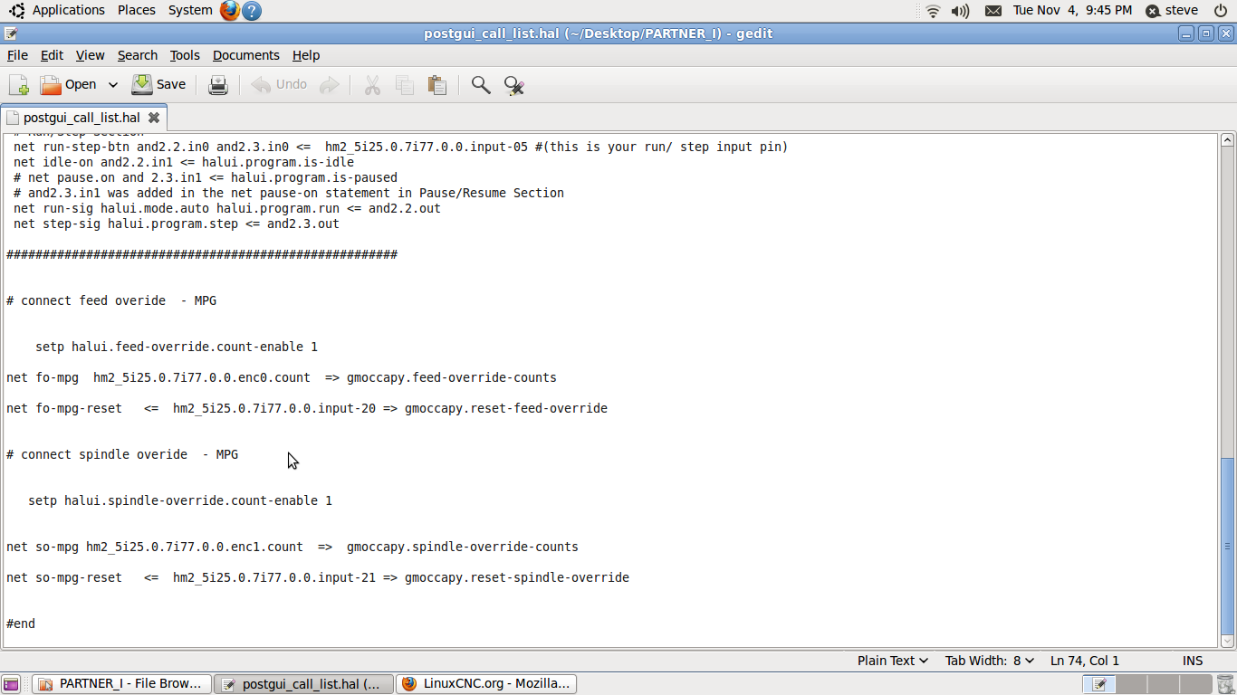

I'll check tomorrow night. I originally used pnc config and had feed and spindle overrides selected using mpg.
- Posts: 23377
- Thank you received: 4966
04 Nov 2014 21:06 #52764
the hm2_5i25.0.7i76.0.0.enc0.counts pin needs to be connected to halui.spindle-override.counts and you also need to set halui.spindle-override.count-enable to 1.
Replied by andypugh on topic aux spindle and feed overrides questions
I got nothing in hal like that do I need to assign those pins to something first
net spindle-override-from-mpg-thingy hm2_5i25.0.7i76.0.0.enc0.counts => halui.spindle-override.counts
setp halui.spindle-override.count-enable 1

does the actual hml_5i25.0.7i77.0.0.input-16 , 17,18,19 need to be connected to the encoder in hal? Or does mode 3 do that automatically?
- Posts: 23377
04 Nov 2014 21:26 #52766
Mode-3 does it automatically. The "enc0" counter runs in the actual software on the 7i76 rather than on the 5i25, and the counts value is passed back to the 5i25 by the serial link (and from there to HAL via the PCI bus)
You shouldn't need any encoder modules in HAL.

Thanks! I'll give it a try this afternoon.

I finally got it. Thanks!
