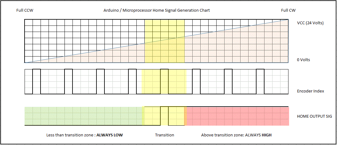

25 Dec 2015 14:45 - 25 Dec 2015 14:49 #67316
by Askjerry
Replied by Askjerry on topic Timing Signals and Home - PUMA
I made a chart to better show the timing...
To answer your question, likely you will need to add a second parallel port to get the proper number of input ports. Or you would need to migrate to a MESA card. Adding a second printer port is really cheap... I get them here in Austin for $10 to $15 typically, PCI style... 5 minutes to install.
Suggested Pin Assignments: askjerry.info/CNC/PUMA_PARPORT_Pin_Assignments.xls
The Spreadsheet above assumes that you would use a StainSmart Breakout Board... they are very easy to implement.
Jerry
