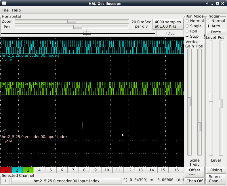

I want to do rigid tapping on the EMCO 120P lathe. It had a single channel plus index encoder which didn't work due to not knowing exactly when the spindle reversed. I replaced the encoder with a US Digital quadrature 1024ppr optical disk encoder. When I connected a scope to the pins and applied power I could see the three channels (A,B and Index) and they seemed to be clear and aligned as they should. I then wired the encoder to my Mesa 5i25/7i85s card and thought I'd rigid tap some air. The tap moves in, the spindle reverses, and just sits there for many (10-12) revolutions and then backs out. It is as if it isn't seeing the index pulse in order to back up the second the spindle reverses.
I ran Show Hal Configuration and try to watch hm2_5i25.0.encoder.00.input-index but never see it turn yellow as I turn the spindle by hand. hm2_...input-a and input-b flash yellow as I turn the spindle, so I assumed that input-index would as well. Should it? I then ran Halscope to watch these pins (plot below). Is this how it should look or is the index only appearing once in a while? Not sure what is going on. Is my config correct for wiring the encoder/spindle together? My .hal file is here: pastebin.ca/3145477 and custom.hal is here: pastebin.ca/3145518 and .ini here: pastebin.ca/3145480

That is all expected since with a high resolution encoder, the index signal itself may be much shorter
than the servo thread time. This means you will only seldom see it on halscope if your spindle speed is not very slow.
The way to check index operation is to "sets" the signal that carries the spindle index enable "true",
then hand rotate the spindle to see if this signal is cleared at the index position
Most commonly when spindle synchronized operations don't work its something wrong in the hal file
usually something wrong with these motion pins:
motion.spindle-revs
motion.spindle-index-enable
motion.spindle-at-speed
(man motion)

Thanks Peter. I see that index-enable is being reset at the index pulse so that must be working.
I also see that I have a bunch of cruft in my config from when we were trying to get the single channel encoder working. I removed that and tried to put the original config back but must have one of the signals you refer to wrong. Now my tapping operation just sits infinitely after the spindle starts and tool moves to position probably waiting on one of those...
The new .hal file is here: pastebin.ca/3145549
-Tom

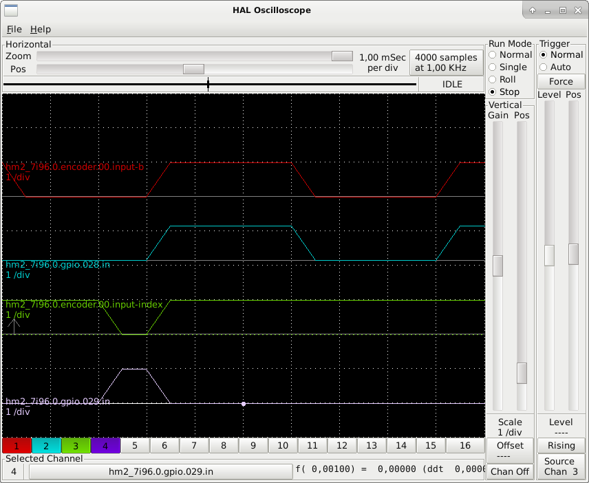

I bought an encoder for playing and learning. I was interested in the sentence:
Is possible set encoder.00.index-enable true only in HAL?
I tried it:but it didn't work because the pin is an I/O
The second thing that intrigued me was that hostmot2 negates the input index, but input-a and input-b are normal. See oscilloscope image.
Should I deal with this? I can fix it:
setp hm2_7i96.0.encoder.00.index-invert 1
Then it works the same as tome users.

All inputs are handled the same ( but all of our TTL interfaces invert A,B,I )
Note that inverting the index is usually a no-op since its edge detected
and changing the polarity will just change the active edge
If you want to set the index from a "out" pin, you can use the "tristate_bit" component
