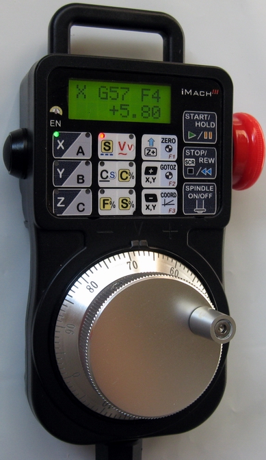

Good Day,
Recently I buy a Control Pendant to use with my retrofitting project. The robot is not yet operating, but I would use the pendant for teaching, in the vismach simulation for now.

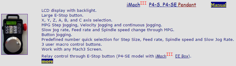

I want to configure the pendant for working with linuxcnc. This is the descrption of the device:
At the developer site, I can download config files for linuxcnc (99-vistacnc-pendant.rules, Makefile, vc-p4s, vc-p4s.hal). And some instructions for install the files. I attached them.
When I want to test with a some linuxcnc config example like Puma560, but some errors was generated:
libusb couldn't open USB deivce /dev/bus/usb/008/002: permission denied.
libusb requires write access to USB devices nodes.
vc-p4s.hal:74: Pin 'halui.mdi-command-05' does not exist
I did my config simulation in RIP mode, therefore I have to work in root mode. Will I try to work in my config folder (RIP mode) for test the pendant, or I can test and configure in normal user mode?
Thanks and regards.
