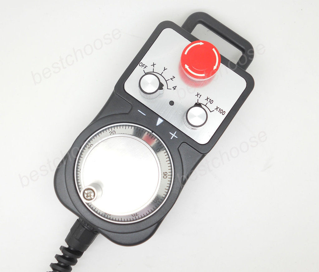

is an mpg .... single end mode encoder on mesa7i77 .... and 2 rotary switchesr .. 1 for mux4 and other for axis selection + I have make an security button .... if press these the output from rotary switches go to mesa card ... altrhought mesa card receive off signal from all selector.... encoder wheel is always active....
similar to these...
@AndyPugh Thanks for joint the post to my other ...

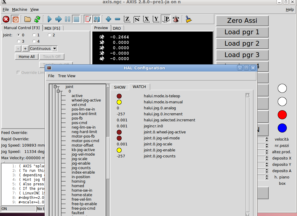

18 Nov 2015 12:45 #65422
Replied by andypugh on topic ubuntu 10.04 Lcnc2.7 JA??
I am not sure if this works or not. My own machine runs on JA(something) but with trivial kins and Touchy. The jogwheel connects to the touchy HAL pins so I don't know for sure that your setup will work.
Can you check with halmeter that the jog-enable inputs into motion are definitely being set? And that the counts increases/decreases.
It is possible that my translation script has slightly broken your config.

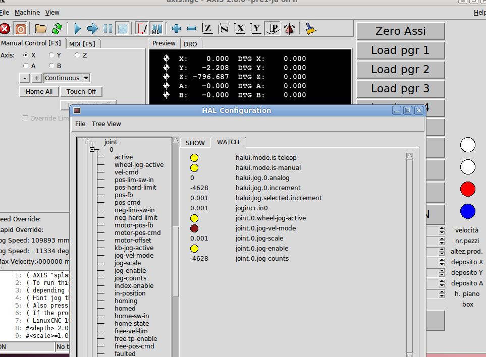

Image of jog mode and teleop mode ..... you see all halui pin move right but in world mode axes is stopped ....
you see anythings broken??
Warning: Spoiler!

18 Nov 2015 14:19 #65428
by bkt
Replied by bkt on topic ubuntu 10.04 Lcnc2.7 JA??
@ ANdyPugh .... in motion not have jog.select pin .....
I summarize: i
in joint mode->
halui.mode.is-teleop off
halui.jog.0.increment -257 (go to negative)
halui.jog.selected.increment 0.01
joint.0.wheel-jog.active on
joint.0.jog.scale xxx(not remember
joint.0.jog.enable on
joint.0.jog.increment -257 ALL WORKS 1JOINT AT TIME
in world mode->
halui.mode.is-teleop on
joint.0.jog.increment -257 AXIS/JOINT IS STOP WITH EXTERNAL MPG. With axis button all works!!
I made some mistakes in the use of commands halui ?? I forgot to set something ?? I had to set halui.jog-speed or halui.jog.0.analogue ??
I summarize: i
in joint mode->
in world mode->

Is c32f a conversion function?
So, you are converting jog-counts to float then sending that to halui.analog-jog?
That doesn't seem like the right way, at all.
The joint jogging pins are created here:
git.linuxcnc.org/gitweb?p=linuxcnc.git;a...82c603cf44aeeaecdb67
There seems to be a jog-counts and jog-enable for each joint.
Are you saying that these work in joint mode, but do not work in world mode?
The following user(s) said Thank You: bkt
