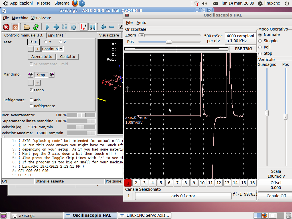

Dear, I'm tuning the PID's values to control a servo (DC motor driven by www.isel.com/hu/downloads/dl/file/id/4287/dc_setup_eng.pdf), I have read the good tutorial written by John Thornton (gnipsel.com/linuxcnc/tuning/servo.html), I have an acceptable result, but the axis is very "nervous" and at start and stop it have a BIG error :(
This is in .ini file:and this in .hal:
Please indicate me what I have to tune for eliminate this error!

Is the drive programmed for velocity mode operation? its not clear that this is the case
The plot is not of much use unless you plot what motion is happening (at minimum plot following error plus commanded velocity )
I would set the minlimit and maxlimit and output scale all to 10 (this is in volts unless you scale the output into machine units per second)
edit: (minlimit would be -10)
With initial tuning set D and I and FF2 to 0. Only when tuning is very close should you even think about touching these.
If you cannot get _very_ close to correct with just P and FF1 something is wrong elsewhere that needs to be fixed.

The drive is programmed for velocity mode, I try to tune it with the instructions linked, But I have a doubt, MAX OUTPUT, OUTPUT SCALE, OUTPUT_MIN_LIMIT and OUTPUT_MAX_LIMIT must have the same values except for the sign? and what value, 10? (V)
