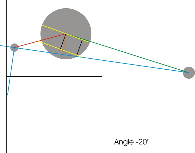

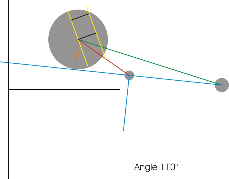

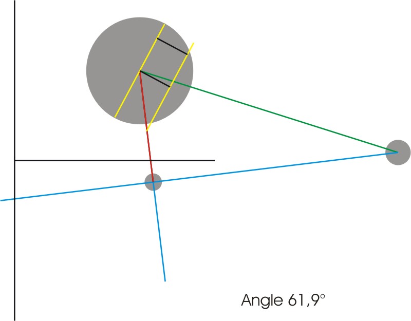

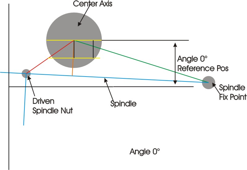

Dear Linuxcnc professionals
Since I was in many prosecute always good advice to the Forum I turn back to you.
This time with a new problem of kinematics.
My colleague and I have been refurbished on several machines and converted to cnc and rebuilt. But with electronics and software our limits are soon reached o as in this case.
Here e is a 5 axis machine with a swiveling axis with a spindle drive and an axis of rotation. So X Y Z A C. The A axis is precisely the pivot axis is a lever with a spindle driven. The A axis is -20 to +110 degrees taverns can and the turntable in 360deg +.
I've read something in the forum
Link:
forum.linuxcnc.org/forum/10-advanced-con...tup-for-linear-delta
and am going to
Link:
buildbot.linuxcnc.org/doc/scratch/v2.8.0...tion/kinematics.html
encountered.
What I have found is that needs to be rebuilt or expanded kinematics.
I have a few pictures uploaded to the illustration. Whereas, since indeed changes the length of the traveling path with each angle must kinematics adapted so Gcode commands of A50 C100 at all can be performed. Is this at all possible as I introduce myself?
Unfortunately, my software and mathematics is understanding here exhausted I'm looking for someone who wants to help us with the project and we will change the kinematics and we will assist in configuring. would also very nice if you could embed the kinematics simulation shown the machine. This is not a must.
We have tried to understand the English lyrics but I do not look through and translated in Google that is of little use because English is not my native language.
I look forward to reply and for your help
Kind regards
Roland
PS: This text has been translated using Google Translator into English.

This system looks a lot like the B-axis of a Centroid milling machine:
www.centroidcnc.com/cnc_porting_machine.html
As far as I can see you need to solve for the angles of a triangle with two fixed-length sides and one variable-length.
www.mathsisfun.com/algebra/trig-solving-sss-triangles.html
You only ever need to solve for one angle, the others do not matter.

Hi Andy!
Thanks for your answer.
The Machine will look like Hermle C30U with Swinging C axis and Rotating A axis
Only the the A-Axis will not driven with Cyclo Gear about the pice in the size Outputtorque 3500n.m they are to Expensive.
The triangle with the calculations was already clear to me. But just where and how do I get Linuxcnc at it this triangle in the A-axis then charged if I motion G1 A +100 F500 to do.
I have the 5axiskins.c to elicit on github trying times how this works but I'm with my knowledge no solution so I'm looking for help.
I'm really just machine operators Simple 3 axis machines I have already established with Step and PNCCONF but at the special functions I had to always get help.
I have somewhere the two start angle and leg lengths to define the need to be accessed when the machine is referenced.
Of course you could always calculate every corner in the program but that is little sense I guess and uncomfortable.
Furthermore, I also do not know where this kinematics find file, then must pass and as I must call them.
Due thus sees you there with a complete "low level user
" do the easy has just a few ideas.
I say thank you and best regards
Roland

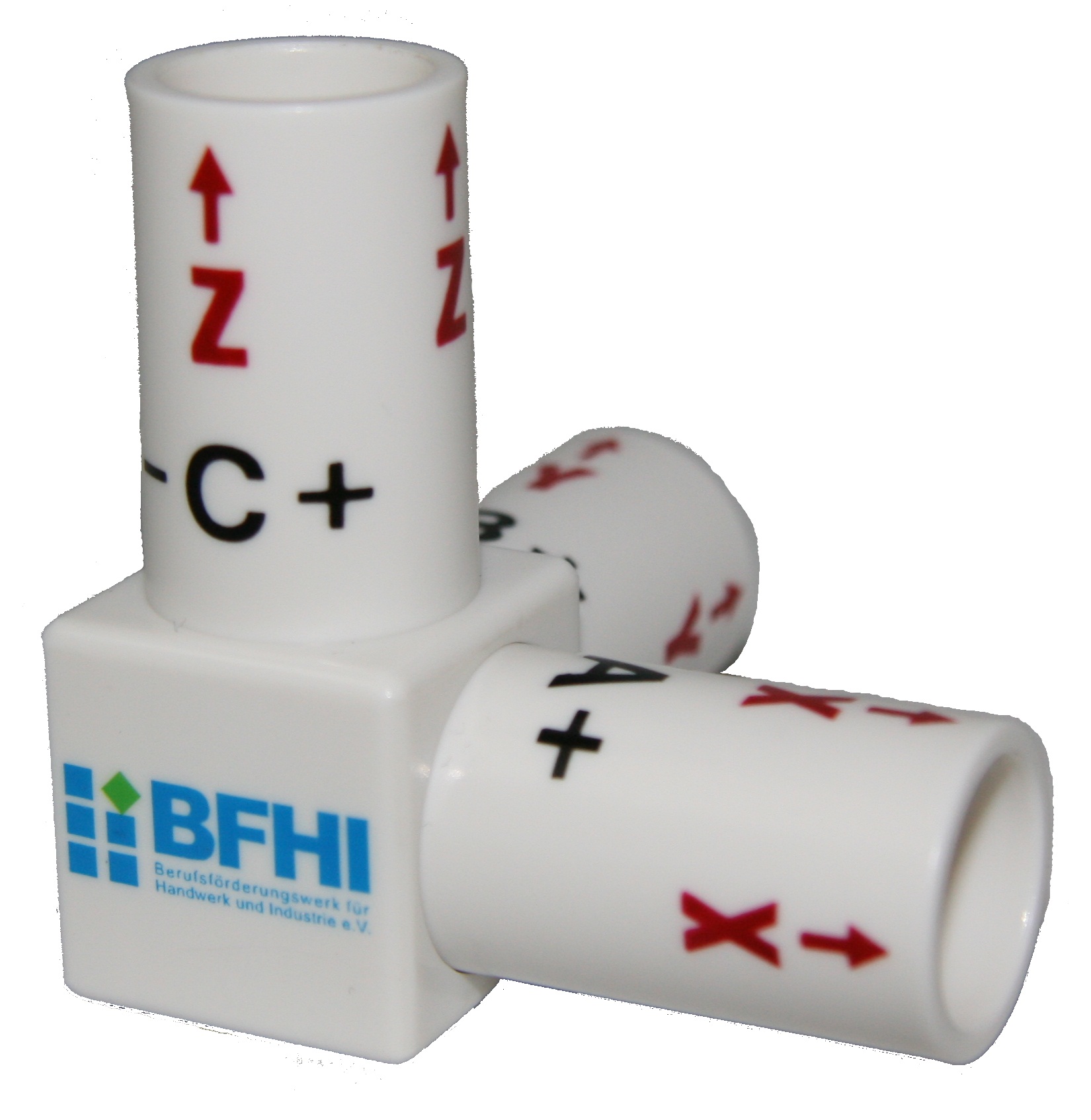

I think you misunderstood me. The Planned machine has in the normal fashion no B axis. Only when the table is therefore the A axis pivoted to the spindle would for B axis if you were installing a transformation.
Only X Y Z A and C, I refer to the model in the Annex.
So I think you mean the line 49 pos-> a = joints [3];
And again you think it is sufficient to calculate the row insert?
Have you done that before? I still do not. As you very well know your way in the theme you'd me the kinematics please describe for our needs? Unfortunately, there is here with us, although these professionals do not deal with Linuxcnc but only with the adults control systems.
Kind regards
Roland
This text has been translated using Google Translator from German to English.

- Posts: 19902
13 Apr 2016 14:33 #73234
Replied by andypugh on topic Help for Linearangular Axis in Kinematics
Have you read: linuxcnc.org/docs/2.7/html/motion/kinematics.html
- G0G53Z148
- Posts: 65
- Thank you received: 6
13 Apr 2016 15:38 #73237
by G0G53Z148
Replied by G0G53Z148 on topic Help for Linearangular Axis in Kinematics
yes, i have with googletranslator but not understood
no problem i will look for an other reason
