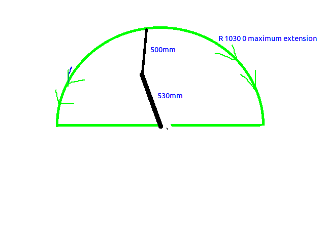

I do not understand very well what you are saying ... I remember very well a discussion in which PCW stated that the hal ini file and all part PID could be removed in case of command step / dir without encoder feedback .... I have not the encodel connected to LCNC but is connected only to the motor drive that has an internal control to closed loop. The motor drive is obviously at its pid adjustment or rather in this case only PI as the derivative is not covered as often happens in this type of motor drive .
in each case I enclose the kinematic (which seems to me correct ) the ini file and hal with correzzioni you suggested .
minferror 0.1 is too low for a robot generally believe ..... I agree , however, that 10 is too high .... but with the gearboxes on board that I can not do better than what you see in your files anyway ... I lowered all ferror except joint1 riding a reducer that " eats " too much torque ...
What if you could have a better explanation of what used P in my case ..... thanks in advance
in the IP parameters of the motor drive / servo drives I have already put a very high P .... P = 2000 (maximum value 4000 ) if I have to put sun P = 1000 on LCNC I have to lower the P on the servo drive would otherwise have too many oscillations only when I move along the semi-circle of maximum extension .... check the design for this

anyway now if I make a straight line at 70 m / min to 250 x500 x500 y y - 750 the gap was reduced to 20mm ... there is only the J3 that moves too much and does not follow the correct angle during the trajectory ... mistaken 5/8 ° .... I realize why it took me a 400mm bar to mark the 0 ° of its movement attacked with a pen that draws the trajectory which stands along .
