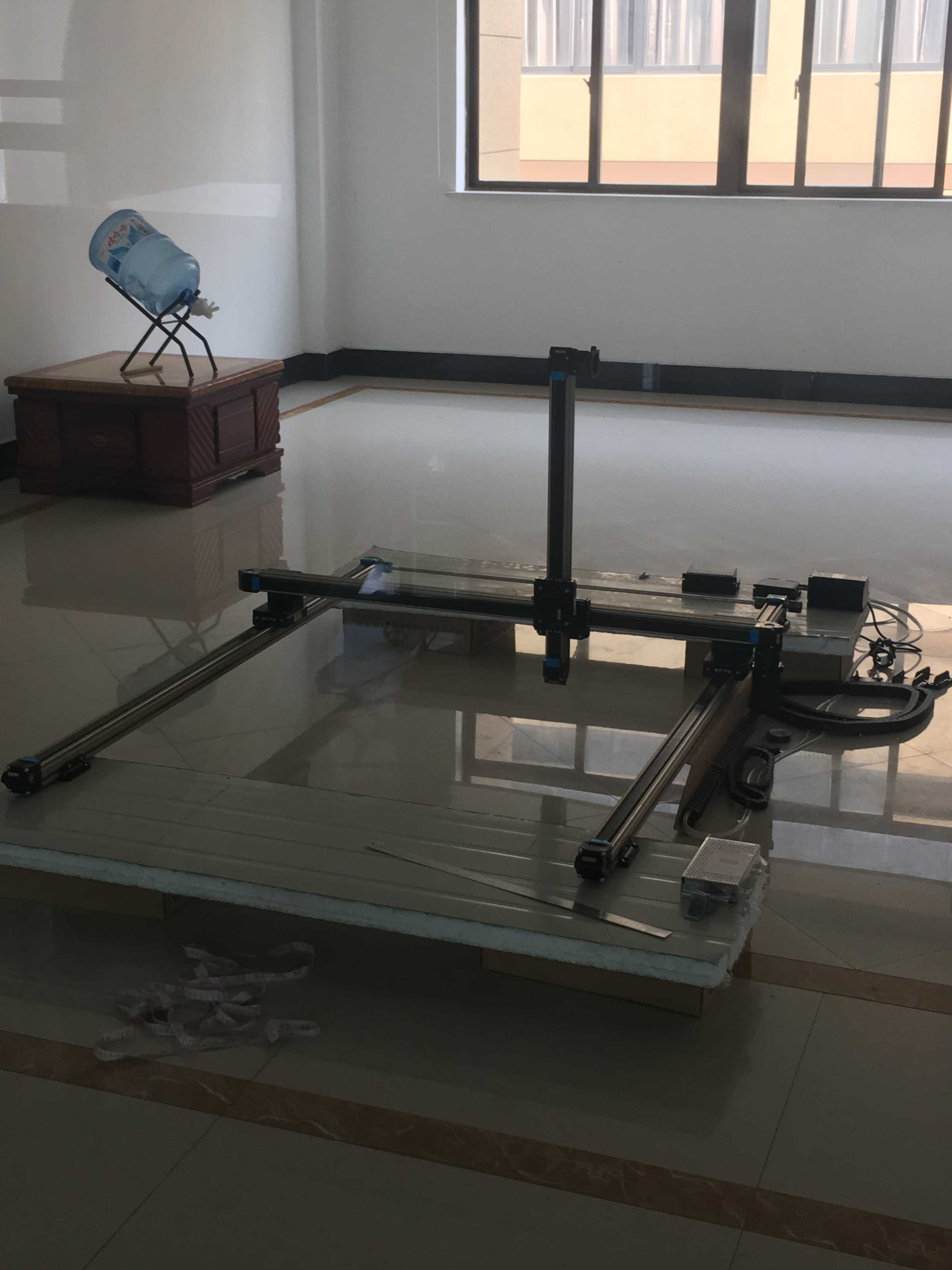

- giantstone
- Posts: 55
20 Aug 2016 02:34 - 20 Aug 2016 05:05 #79112
by giantstone
Replied by giantstone on topic How to write HAL logic with Motion and Offset pin?
Hey Tom, I spent quite some time to try linuxcnc, i think it's really useful,
the hardware I'm using changed to a desktop with ASUS Z170-AR board and an iI6700K CPU, I bought a PCIe to Parallel and a PCI to Parallel card(MOS 9865) , the stepper controller board is a TB6560 board (AL-ZARD)
however Im having another problem, I failed to make ROS and Linuxcnc run together.
<edit> problem being solved, hhaha, i was building a wrong ros version with debian wheezy;
I tried to install ROS in a Debian system (Debian Jessie and Debian Wheezy, and Ubuntu Precise ) with linuxcnc already installed, I failed, because " the system holds broken packages ,,, can not install package xxx etc"
I tried to install Linuxcnc alongside with ROS in a Ubuntu system (ubuntu 14.04 trusty, ROS already installed) , I succeeded installing Linuxcnc and I was able to start it, but it can't be run in a non-simmulation mode (some errors such as command timeout and configuration errors occured that stopped linuxcnc; however I was able to run non-sim mode with the same configuration in Debian systems with the same desktop).
I tried to change my ubuntu 14.04 's kernel to RTAI kernel, but the system didn't boot properly, an error says INIT file not found.
Could you tell me how to make ROS and Linuxcnc run together?
The machine I'm building is to cut fur coats etcs. not skinning cats btw.
The gears haven't been installed properly, what I have is only a frame right now. see my picture.

- Posts: 22018
- Thank you received: 7496
20 Aug 2016 13:26 #79124
Replied by tommylight on topic How to write HAL logic with Motion and Offset pin?
That looks neat !
I have not used ROS, so i can not help with that, although i can not figure out why you would use that for a 3 axis machine.
As far as i understood you, there is no need for ROS, you need a normal 3 axis machine, the only difference being that you need to change the Z axis values during work, all that is already implement in several versions of THC control for plasma cutters.
Moving on
Moving on
