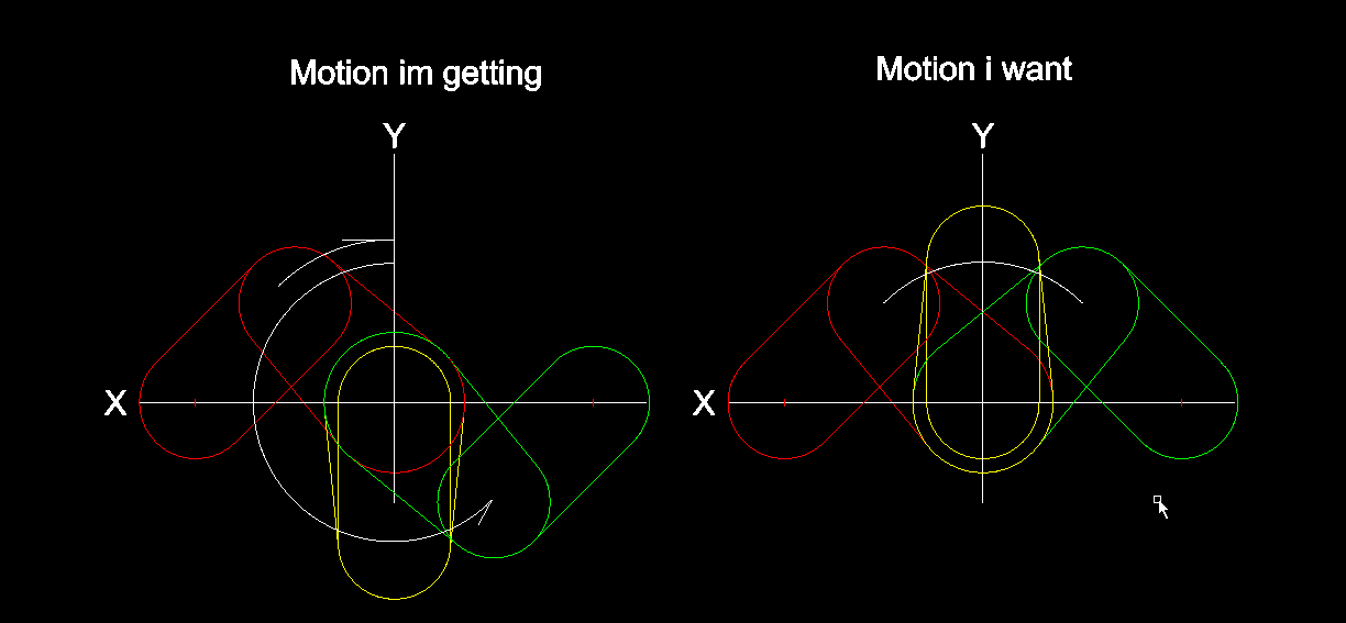

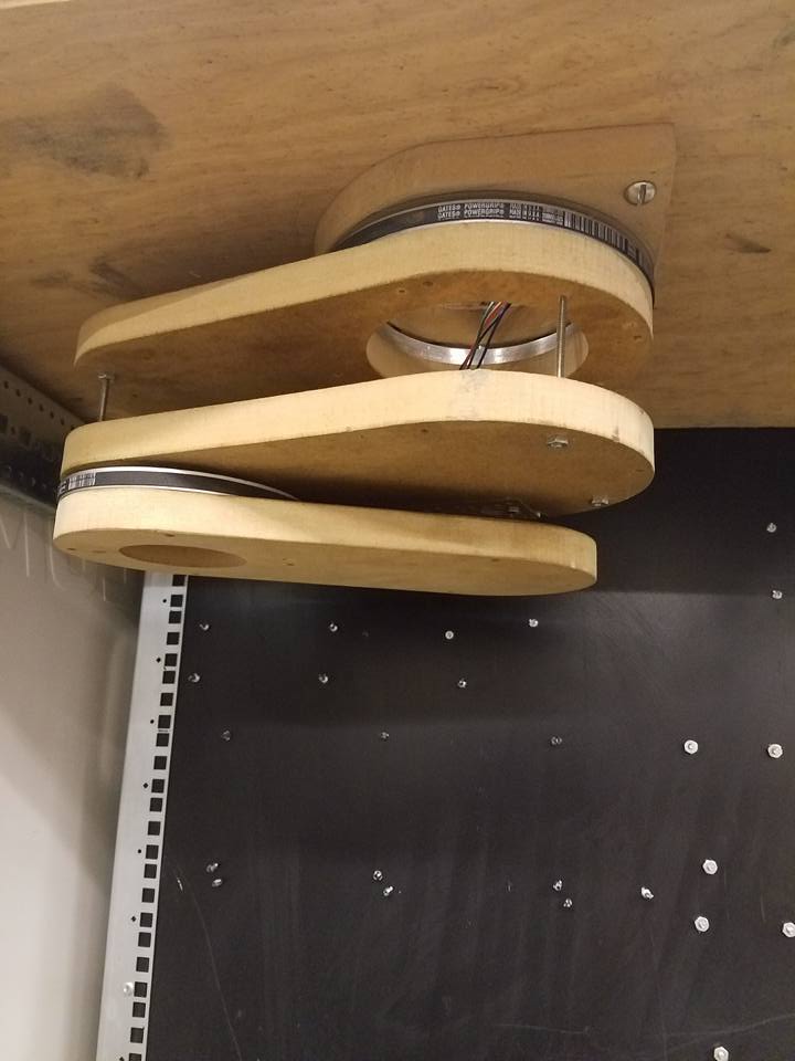

playing with a scara type motion but the kins force the arm to rotate the axis_0 180deg on the crossing of the X 0 line(or Y 0). normally not a problem because your arm would hit something before this happened. so i know i need to edit the scarakins.c file then recompile, but im not sure how to change the math to let the axis_1 continue to rotate in sync with the axis_0. i have attached a pic of the arm
And a diagram of the motion
but not sure what i need to edit in the scarakins file to make that happen

I guess you are passing through a singularity.
It probably comes down to an inverse trigonometric function that chooses one root rather than the other.
Perhaps the scarakins code needs to reject solutions that result in a large deviation from the current position.
github.com/LinuxCNC/linuxcnc/blob/master...ics/scarakins.c#L153

so been playing around with that, nothing promising yet. looks like it is only a problem when an axis is close to zero and the speed makes the affected radius larger. A workaround maybe to slow the feed as it gets close to X 0 or Y 0. Don't really like this idea. think it is a problem with quadrant math, still hard to get my head around.

Possibly because the units of q0 are radians at that point, but joint[0] is degrees.
