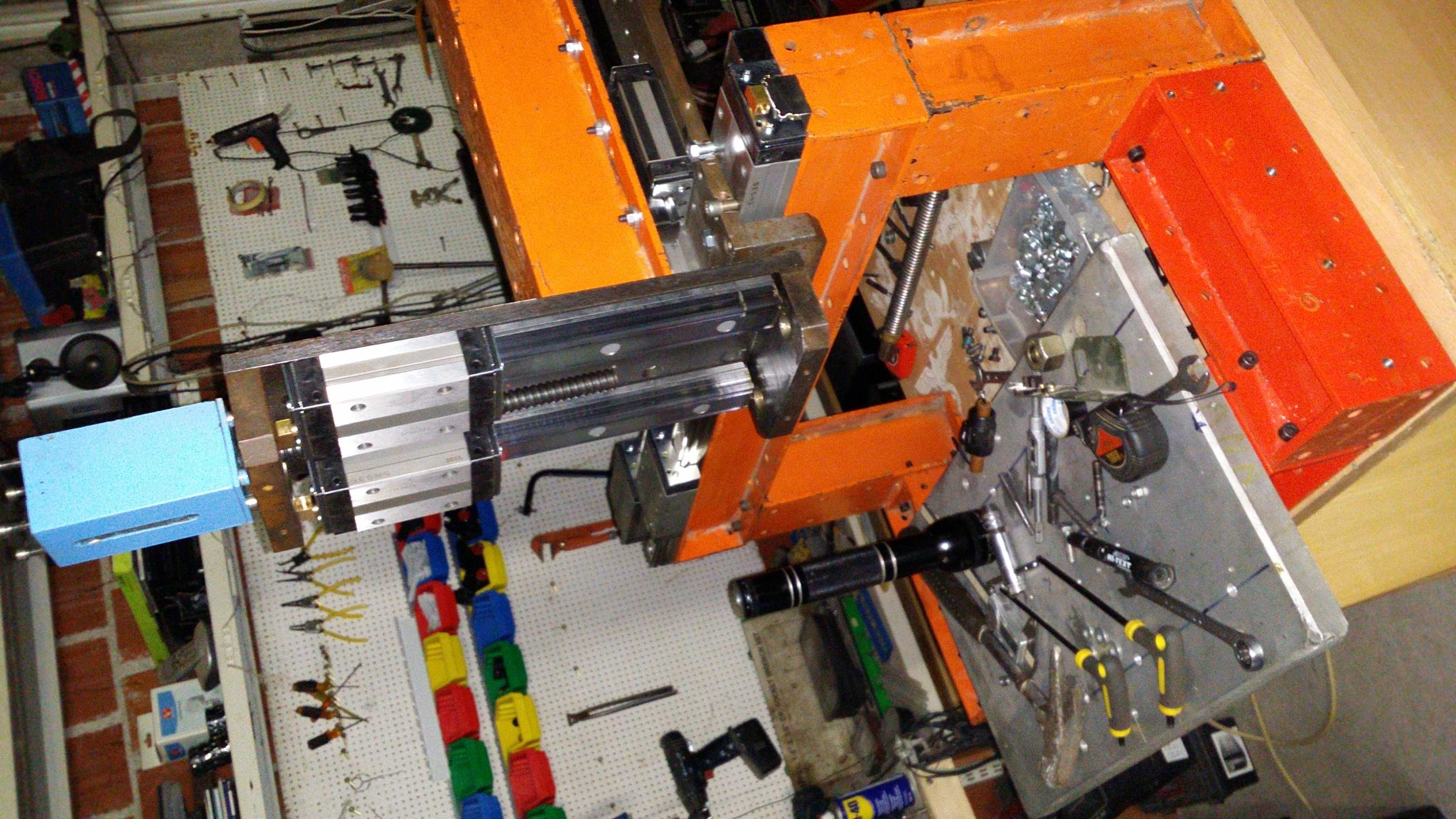

I have been thinking about building a mini mill (X=250mm Y= 150mm Z=100mm) This would run LinuxCNC with Mesa cards and Fagor SSI absolute encoders. It would be nice to have in my garage, and would act as a very good test platform.
Tero
Tero
- Posts: 22018
- Thank you received: 7496
02 Sep 2016 20:58 #79936
Replied by tommylight on topic Getting soft limits to work without homing
Something like this ?
