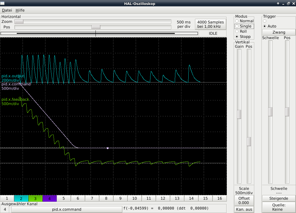

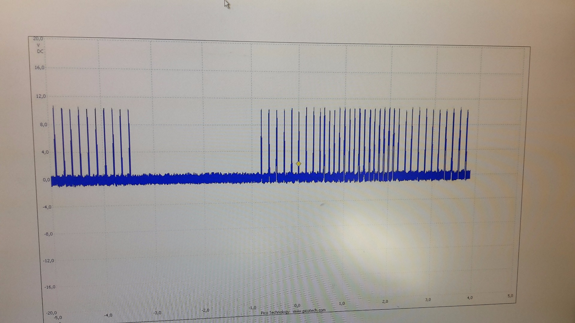

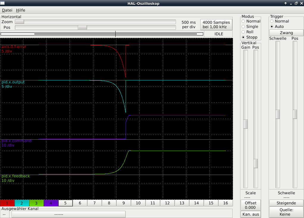

Hey guys,
a colleague and I are currently repairing a milling machine ("Heller CNC PFH 10-1000"). We are using LinuxCNC 2.7.7 and the engines are controled by MESA Cards (5i20, 7i37 TA, 7i48) with a svst6_6_7i48 firmware.
The problem we are facing is, that LinuxCNC tries to compensate the drifting of the x- and y-axis with lots of short peaks of voltage in the output, so the machine starts to cog while holding its position or moving against the drifting direction. Moving the axis in drifting direction in not a problem. You can see the voltage output signal in the attached picture.
We have been trying to figure out the correct PID values to fix this, but couldn't really. So we would appreciate your help. If you have problems understanding or need further information, please ask.
Thanks in advance!

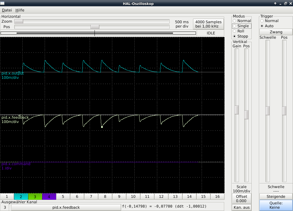

07 Nov 2016 15:24 #82545
Replied by PCW on topic PID Setting for drifting axis

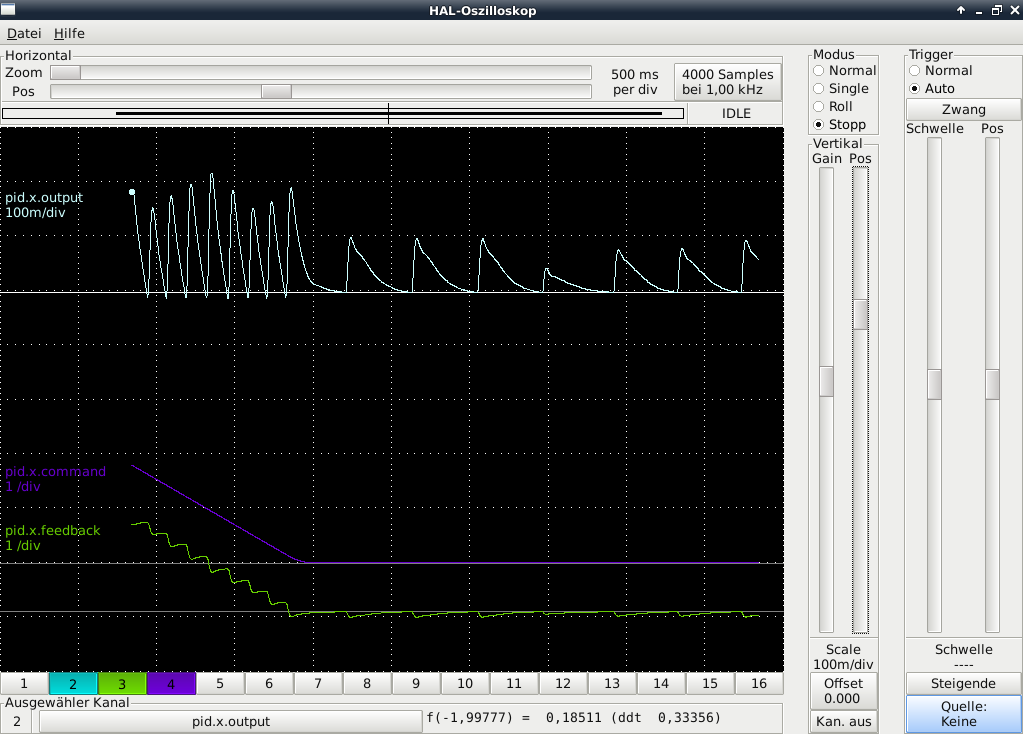

Do the axis move smoothly both ways open loop? say with 100 mV/-100 mV of analog signal
(that is, is this possibly a drive issue?)
Can you send any output voltage open loop (via setp) (try +5 and -5)
(that is is this a hardware interface problem)
Does the encoder read accurately?
A 10V output with a P gain of 1.5 means an error of 6.66 mm (assuming mm)
is this much error really present?
(In addition I should almost always be 0 when doing initial tuning )
Halscope plots of the PID output value, commanded and feedback position would be helpful
Also posting the HAL and INI files may help

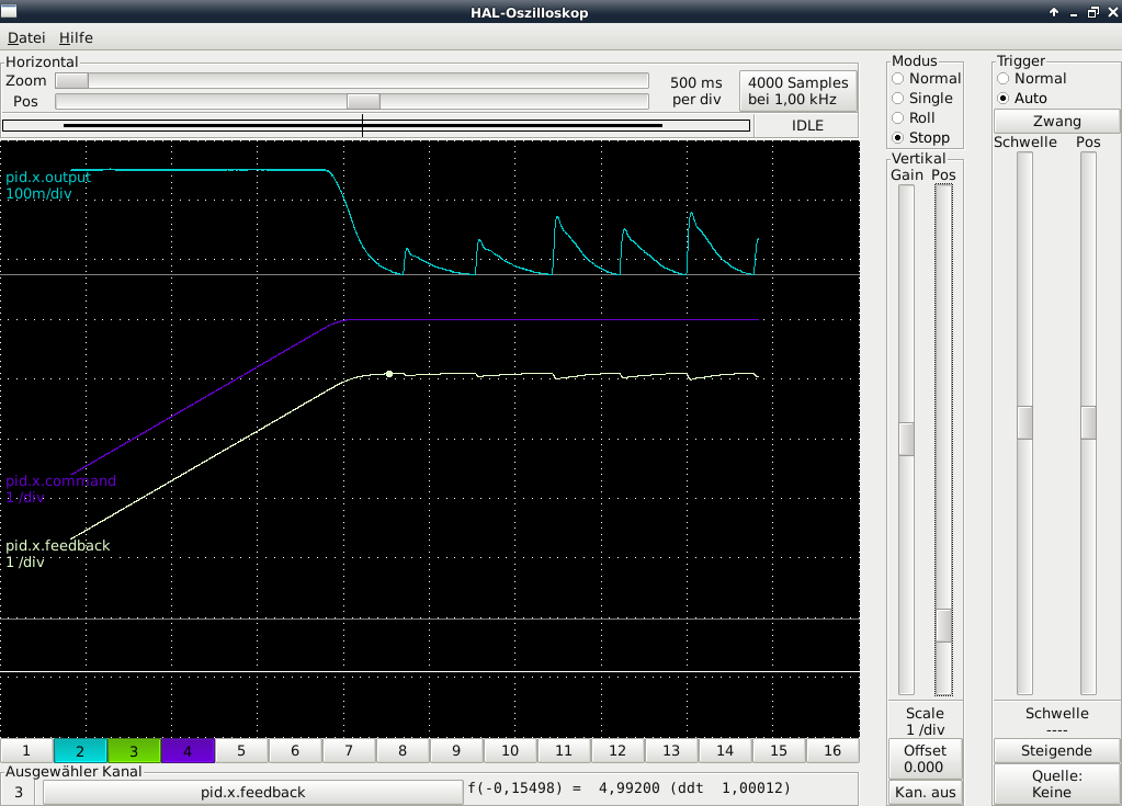

- Chre9
- Posts: 24
08 Nov 2016 14:28 - 08 Nov 2016 14:31 #82587
by Chre9
Replied by Chre9 on topic PID Setting for drifting axis
Last edit: 08 Nov 2016 14:31 by Chre9.
- Chre9
- Posts: 24
08 Nov 2016 14:33 #82588
by Chre9
Here you can find the .ini and .hal document:
We already fixed one of the encoders and they all work properly. Furthermore we have been testing the axis with an external power supply and they move smoothly this way.

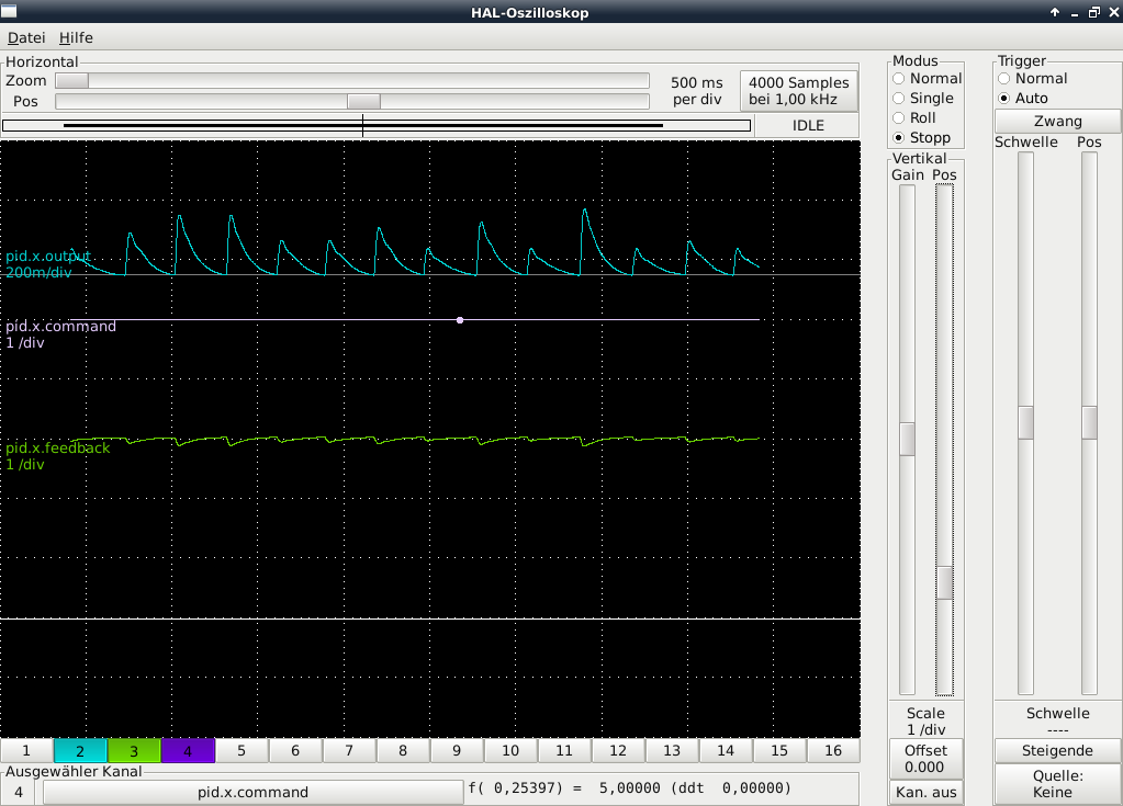

08 Nov 2016 14:41 - 08 Nov 2016 19:23 #82589

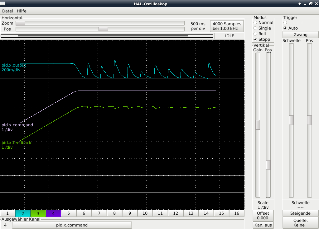

Wrong PWM output type
So what's happening is this:
The 7I48 is designed for UP/DOWN PWM mode (output type 2)
where positive outputs are generated by a PWM signals on the UP pin
and negative outputs are generated by PWM signals on the DOWN pin
the absolute analog voltage in either case is proportional to the PWM duty cycle
If you instead run the 7I48 with the PWM generator in PWM / DIR mode (output mode 1)
it works fine in the direction that the direction pin is 0, but you get a immediate full scale
output (10V) when the PID output sign changes making the direction pin high
setp hm2_5i20.0.pwmgen.04.output-type 1
Last edit: 08 Nov 2016 19:23 by PCW. Reason: clarify

10 Nov 2016 18:48 #82684
by Chre9
- Posts: 18104
- Thank you received: 5328
10 Nov 2016 18:56 - 10 Nov 2016 18:57 #82685
That's expected (it means the loop feedback is positive instead of negative)
The fix is to reverse the PWM output scale, that is change:
OUTPUT_SCALE = 10.0
to:
OUTPUT_SCALE = -10.0
in the per AXIS sections of the .ini file
OUTPUT_SCALE = 10.0
to:
