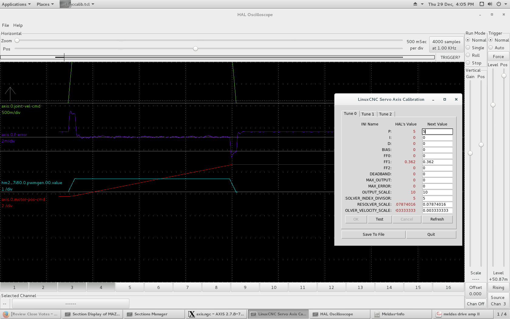

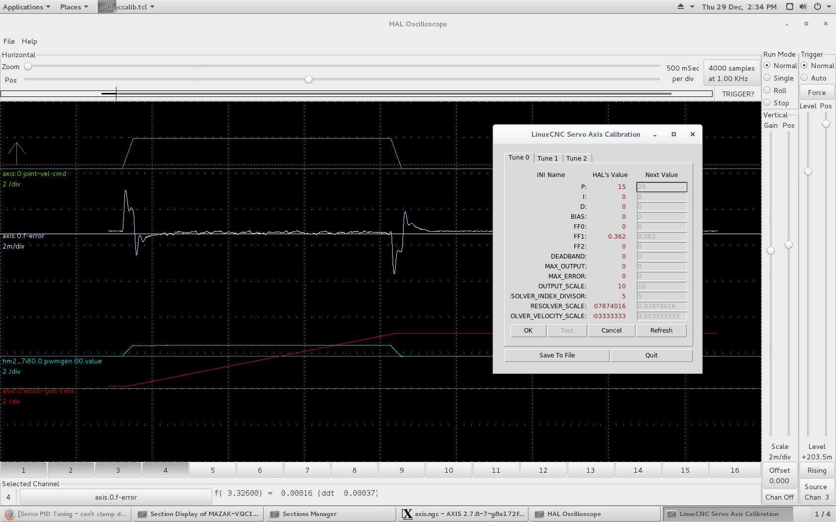

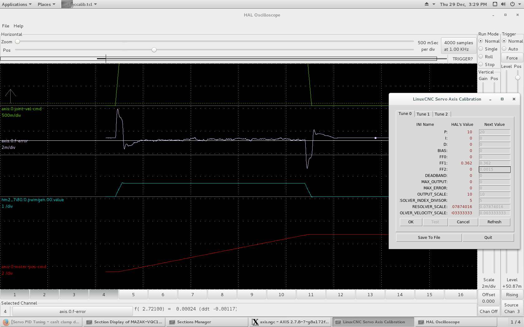

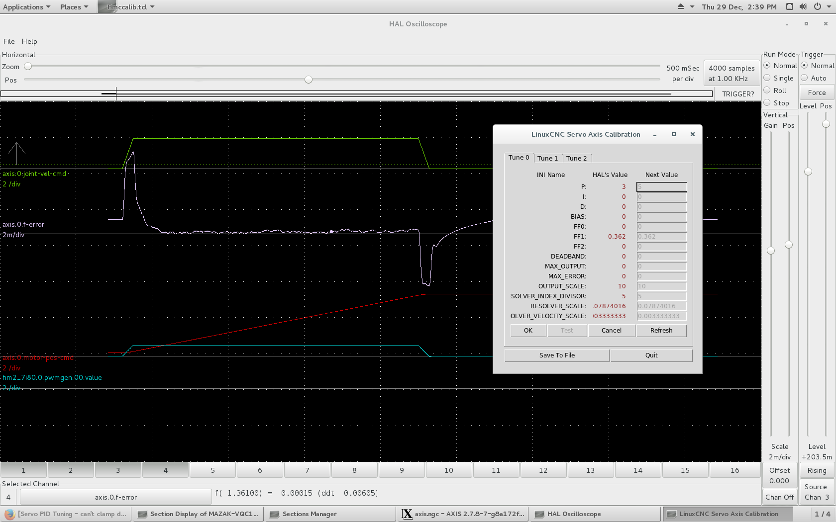

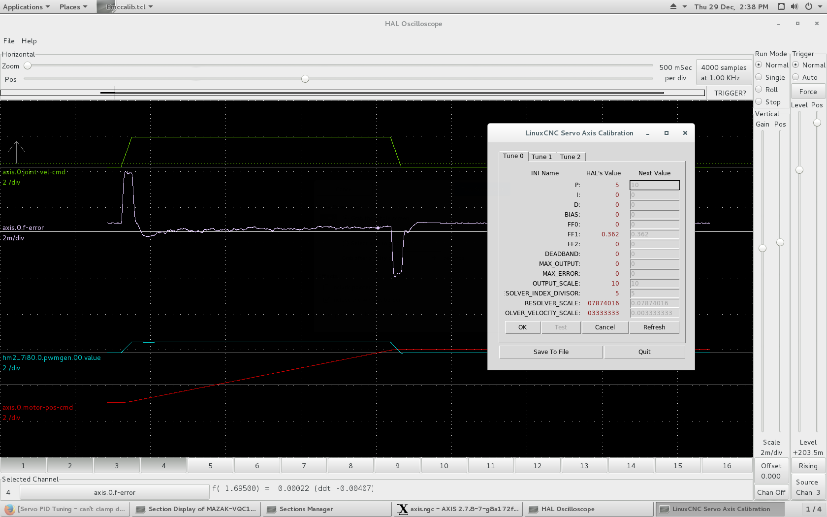

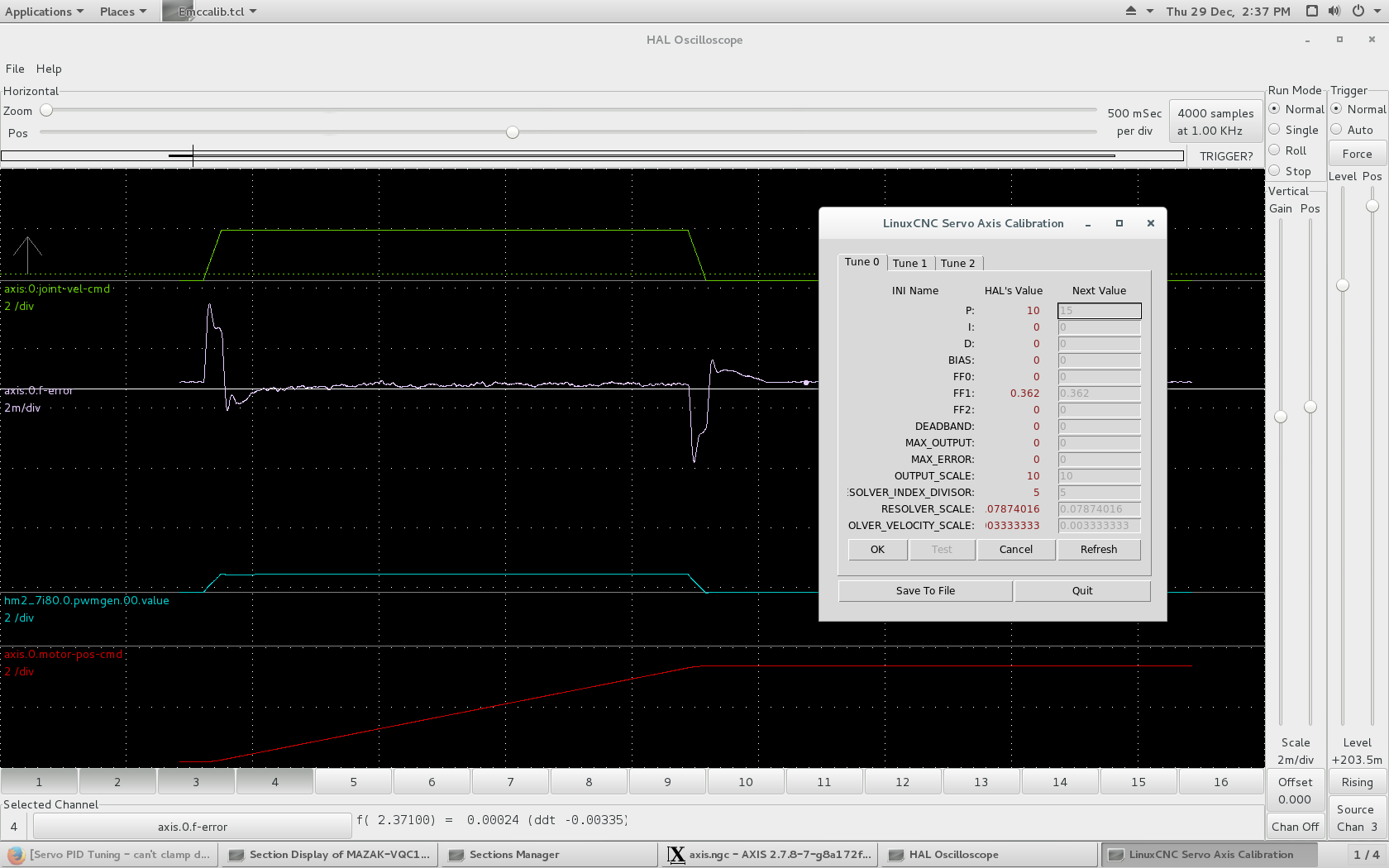

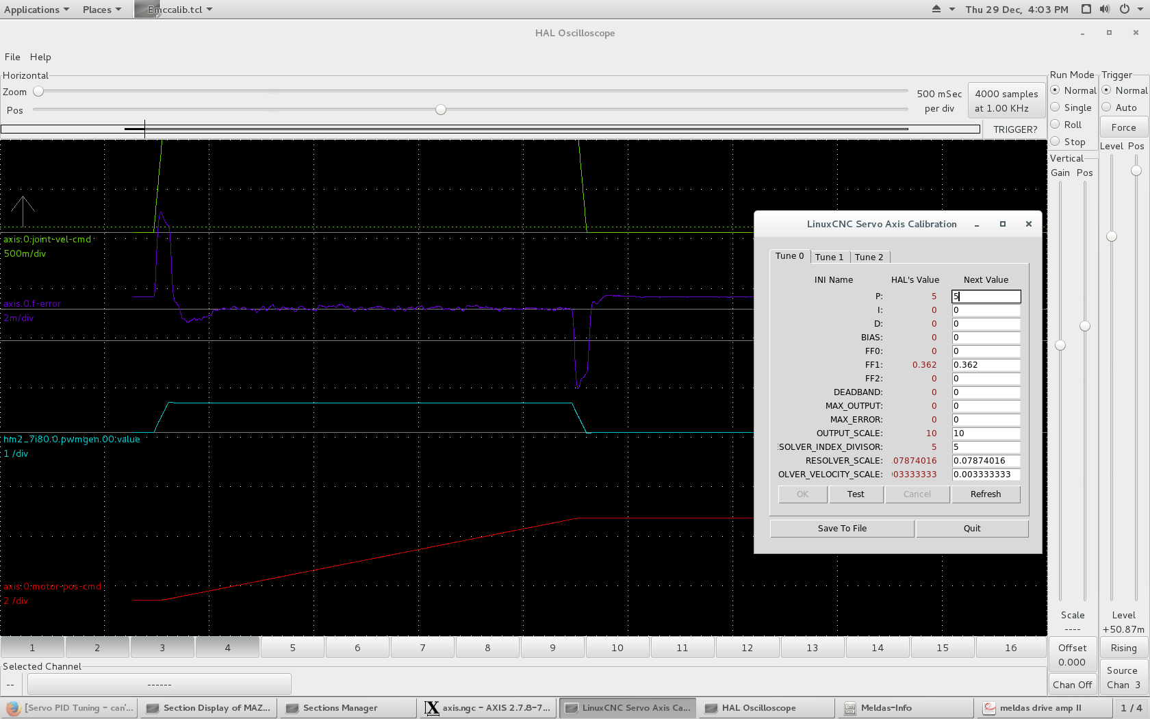

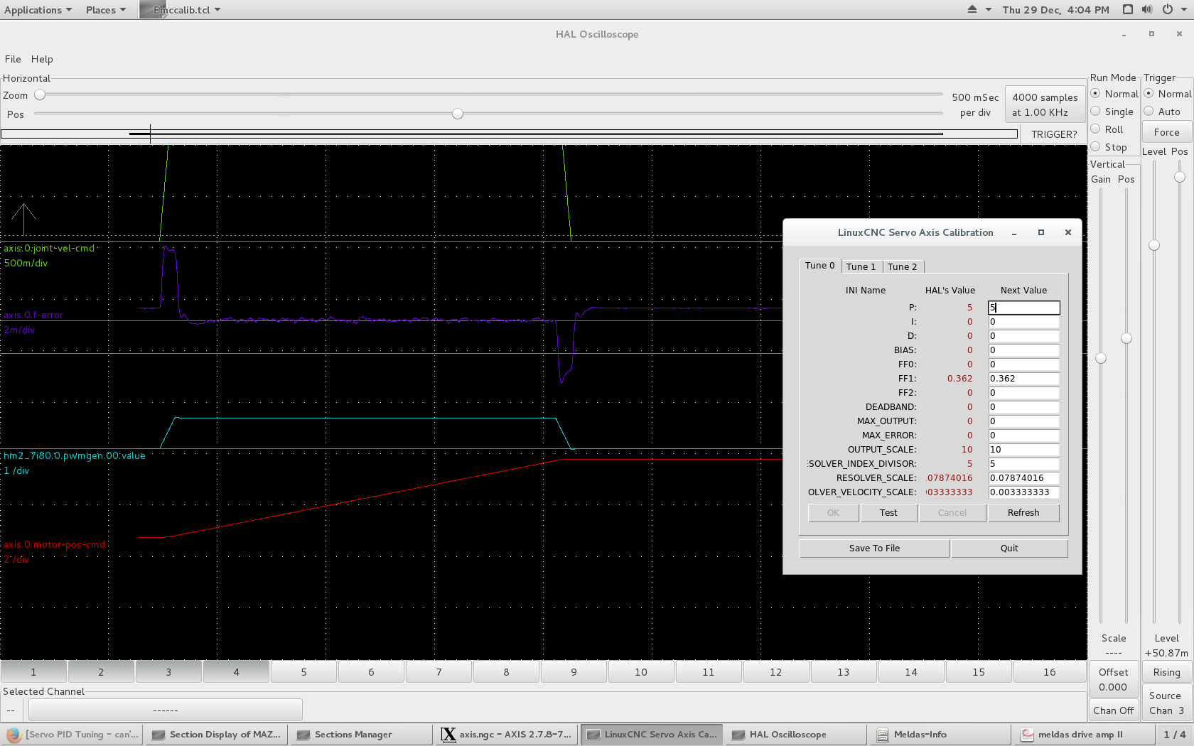

Here are more screenshots
I was able to recenter before & after with Igain after these screenshots, but nothing seems to really help the initial lag at all.
- same acceleration (10in/s^2)
- no FF2
- just dropping P from 20 to 15 to 10 to 5 to 3 (see the file names)

29 Dec 2016 21:24 #84876
Replied by PCW on topic Servo PID Tuning - can't clamp down on overshoot
Hmm if accceleration doesn't affect the overshoot then its not likely to be lag in the resolver
mechanical?
mechanical?

29 Dec 2016 21:32 #84878
by SRDC
Replied by SRDC on topic Acceleration doesn't change things...
Just to make sure the acceleration wasn't a problem at all, we dropped the acceleration down to 3 in/s^2. Halscope screenshot is attached -- no real change. The initial lag is still around 0.002-0.003 inches.
It exactly matches the acceleration time period, and then jumps into position almost vertically. It's almost like something is holding the motors back during acceleration.
- Posts: 18104
- Thank you received: 5328
29 Dec 2016 21:56 #84879
Replied by PCW on topic Acceleration doesn't change things...
You might try increasing the drives velocity loop gain (increase till it oscillates then back off 20% or so)
while linuxCNCs P term is low to see if that helps the lag.
the fact that its unaffected by acceleration does suggest mechanical issues though
- SRDC
- Posts: 19
29 Dec 2016 22:09 #84882
by SRDC
Just tried increasing "speed loop gain adjustment volume." It did help a teeny bit. We increased it 2 'gradations.' On the 3rd gradation, it started buzzing as soon as the drive was enabled, so we backed it back down to 2 gradations.
Still not changing the basic problem.
What mechanical issues would you look at?
