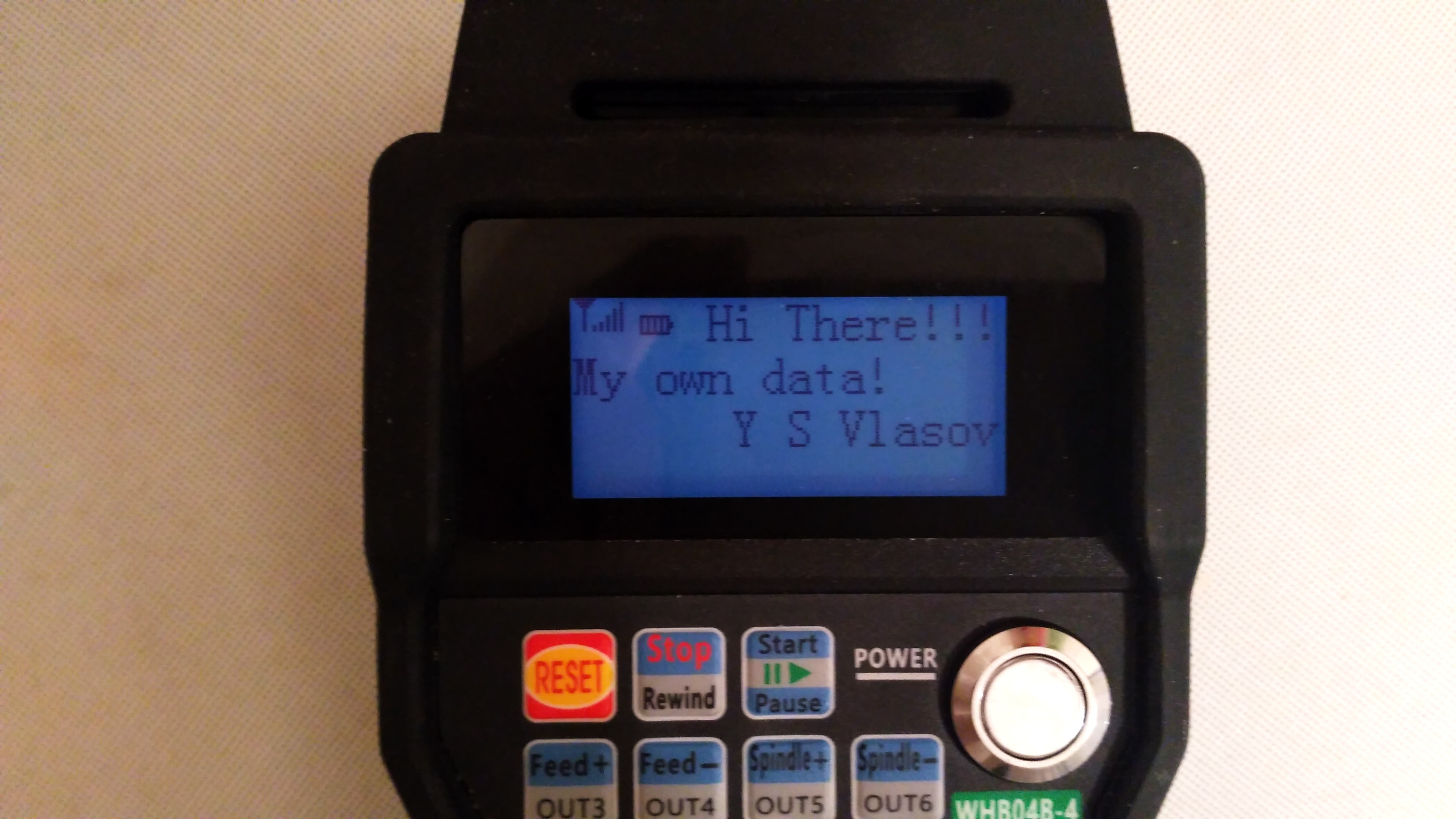

Several additional important things:
I.
MPG:
04 XX XX XX XX XX 02- XX - MPG +2
04 XX XX XX XX XX 03- XX - MPG +3
04 XX XX XX XX XX 04- XX - MPG +4
04 XX XX XX XX XX FF- XX - MPG -1
04 XX XX XX XX XX FE- XX - MPG -2
04 XX XX XX XX XX 00 XX - MPG idle
II.
when usb radio module is pluged in:
04 XX 00 00 00 00 00 XX
04 XX 00 00 XX XX 00 XX (if pendant is on)
when usb radio module is pluged out:
00 00 00 00 00 00 00 00
III.
Buttons:
04 XX 00 XX XX XX XX XX - no button is pressed
IV.
Buttons if "Fn" is pressed:
04 XX 0C 01 XX XX XX XX - Reset
04 XX 0C 02 XX XX XX XX - Rewind (Stop)
04 XX 0C 03 XX XX XX XX - Start/Pause
04 XX 0C 04 XX XX XX XX - OUT3 (Feed+)
04 XX 0C 05 XX XX XX XX - OUT4 (Feed-)
04 XX 0C 06 XX XX XX XX - OUT5 (Spindle+)
04 XX 0C 07 XX XX XX XX - OUT6 (Spindle-)
04 XX 0C 08 XX XX XX XX - OUT7 (Morigin <-)
04 XX 0C 09 XX XX XX XX - Safe-Z (/2)
04 XX 0C 0A XX XX XX XX - Probe-Z (Worigin <-)
04 XX 0C 0B XX XX XX XX - Spindle On/off
04 XX 0C 0D XX XX XX XX - Switch Coorinate
V.
from computer to device:
06 FE FD 09 XX XX XX XX
06 XX XX XX XX XX XX XX
06 XX XX XX XX 00 00 00
for example:
06 FE FD 09 52 45 53 45 //.??.RESE//
06 54 20 20 20 20 31 58 //.T 1X//
06 58 3A 30 2E 34 35 32 //.X:0.452//
06 30 20 20 20 20 20 20 //.0 //
06 20 20 46 3A 36 20 20 //. F:6 //
06 53 3A 30 20 20 20 20 //.S:0 //
06 20 20 20 20 00 00 00 //. ...//
(2 ascii characters instead "??")
I suppose, you can put there any infirmation.
1st string 11 signs,
2nd string 16 signs,
3rd string 16 signs.
(in mach3: RESET(or several spaces), several spaces, step rate, current axis position, several spaces, feed, 2 spaces, speed, several spaces)
("RESET 100XY:-10.3400 F:1000 S:500 ")

Can You make use of the 4th row? It seems that I cannot send any data to the 4th row, so there is an empty row.
- nebelnoir
- Posts: 12
- Thank you received: 4
12 Jul 2017 11:06 #95717
by nebelnoir
Replied by nebelnoir on topic WHB04B-6 Manual Pulse Coder
1st row 11 signs,
2nd row 16 signs,
3rd row 16 signs.
4rd row - not supported (I think)
WHB04B has a certain format of sent data
2nd row 16 signs,
3rd row 16 signs.
