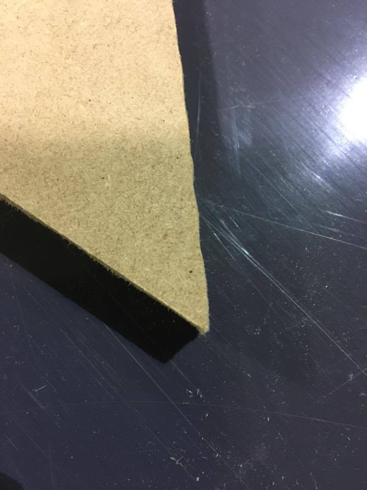

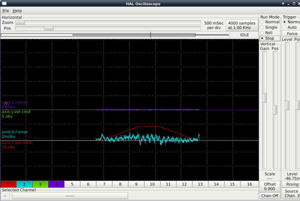

I have a few pics I would like to share. I have a problem where when the machine accelerates and decelerates it makes waves in the material. I see the bit moving when it is doing this and it is not in the gcode. I have a feeling it is vibration of the whole assembly. Not sure.

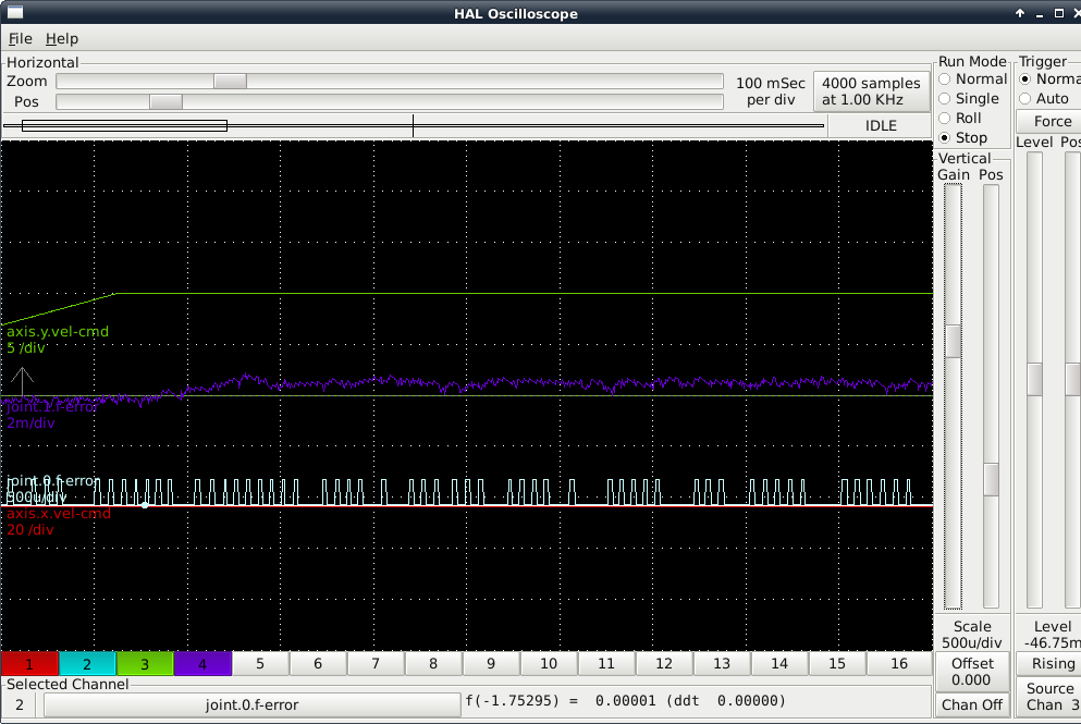

But I have a weird pule train when the axis are not moving and would like to know if anyone can shed some light on it. IT is a stable symetrical pules train.
And the other is upon acceleration and deceleration there is a bit of a spike as you can see in the images.

Well, you don't say what hardware (motion interface and motor drives) you are using. It looks like you probably have encoders, but you don't say.
The following error plots are showing very small errors, so PID tuning is not the problem. The gear tooth pattern on your first chart looks like the servo is just dithering one encoder count +/-, which is pretty normal for any servo. The scale of these ditherings is about 1/2 of 500u, so something like .00025 user units. pretty small if your user units are inches, really tiny if mm. (That's for joint 0, axis X)
Your axis Y error is a bit bigger, but still not exceeding .001 user unit, so still not the cause of your gouges.
But, that is all the computer can control, either step pulses or encoder position. If you are seeing greater divergence from the commanded position, it has to be mechanical. Is there backlash in the leadscrews? Can the axis slides move sideways due to looseness in the slides? You have to remove all of that slack before the computer can accurately control position.

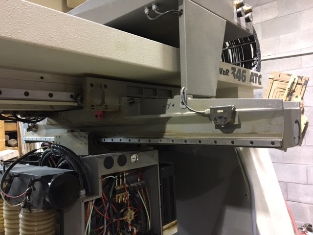

oops, yeah sorry Jon. IT is a large Biesse machine. I have pics in my thread, but it is running yaskawa ac servo drives large ac servo's and the gantry weighs over 1200 lbs.
There is no loose slack in the mechanics. I think it may be vibration of the head itself. not sure.

I tried to reproduce the problems and I can a bit, but I do not see the X axis where it connects on the bearing move when I see the spindle vibrate back and forth, and it is usually at decelerating for corner or accelerating and/or raising up for tabs. Those are the places it is doing it.
Maybe it is mechanical vibration. I don't know, hard to tell.
The halscope traces look ok to you? I shave spent hours upon hours tuning it to get it the best I can.

I looked more closely and dont see the x and y movements whenthe wave occurs. When i look at the tool spinning, i can see it wobble. I have more than one spindle and it happens on all of them not as bad on one i think but hard to tell.

Whew, that's a BIG machine! But, the Halscope traces do NOT show the errors. Now, one big thing is, were these traces made while the spindle was running? Were they made while cutting was taking place? I'm guessing the answer is no. So, you are going to have to take some Halscope traces while it is actually under cutting loads.
But, first, as Todd says, follow the entire chain of components from the motor to the linear axis. At least when you made the Halscope traces, the motion at the encoders was smooth and had little error from the commanded position. Your test cut showed the spindle was not following the commanded position by a MUCH larger amount.
So, it seems to ME that there is a mechanical issue somewhere between the encoders and the spindle.

There is three spindles on the Z axis. They all go up and down when the Z is moved.
I cannot see the X or ZY axis move when gett this on the piece of wood. It seems to move as commanded by Linuixcnc, so I guess it is in the Z or something loose. I will look into it in more detail.
This thing is a monster. The Gantry weighs over 1200lbs, so that is a lot of mass to move and if it is move in tiny increments it shakes so something is a miss on the Z I think.
Those traces were done with the spindle running at 24000 RPM and cutting air. No real load on it, but you can see the spindle wobbel in the X direction.
