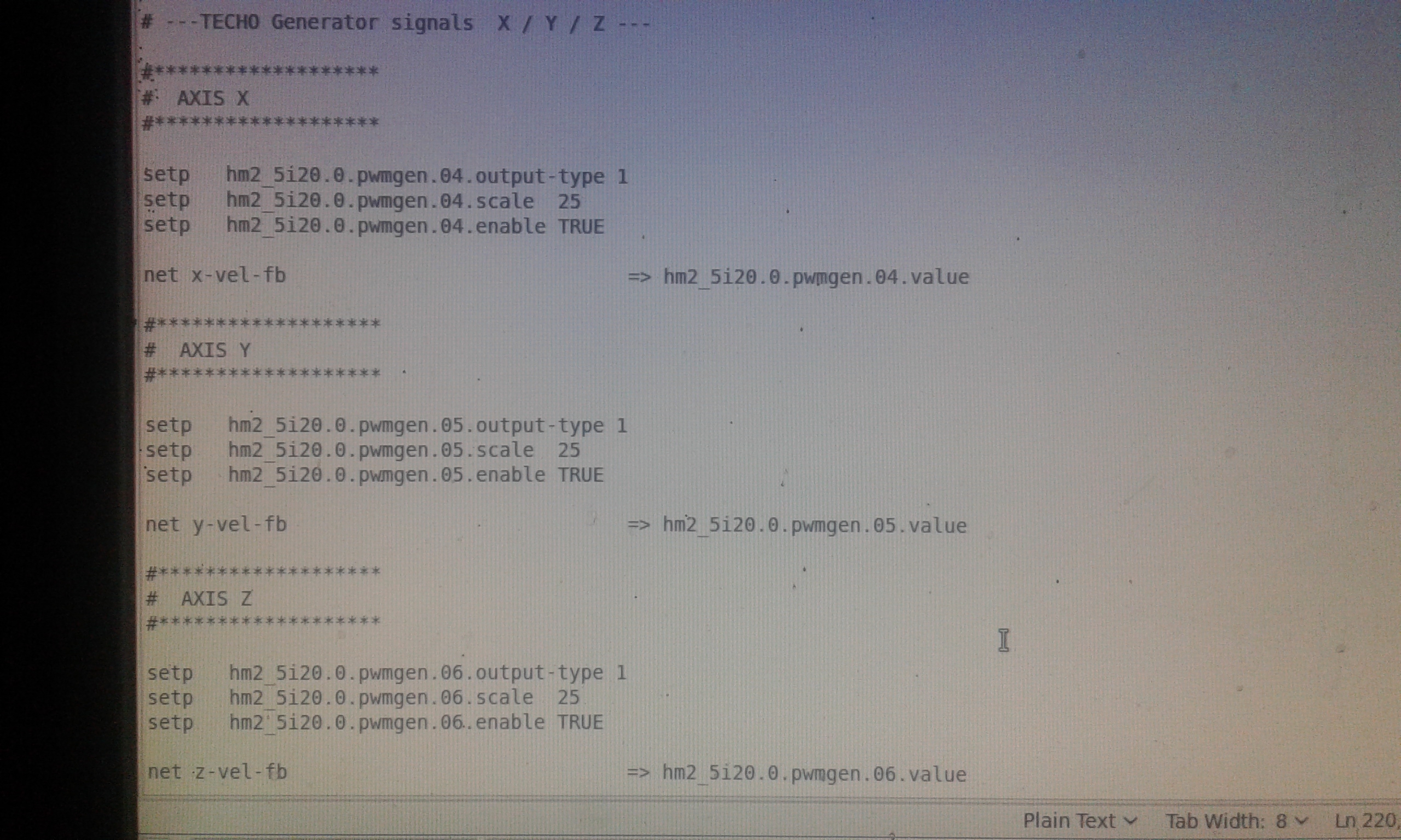

simple way to generate techo signal
mesa 5i20 + 7i33
setp hm2_5i20.0.pwmgen.04.output-type 1
setp hm2_5i20.0.pwmgen.04.scale 25
setp hm2_5i20.pwmgen.04.enable true
net x-vel-fb => hm2_5i20.0.pwmgen.04.value
mesa 5i20 + 7i33

- ditechcnc
- Posts: 16
30 Nov 2017 12:57 #102527
by ditechcnc
Replied by ditechcnc on topic Fanuc DC servo + 7i77
i am using 24vdc small motor mount 100ppr encoder
with amc 12a8 servo amp.
working perfect with scale 25
