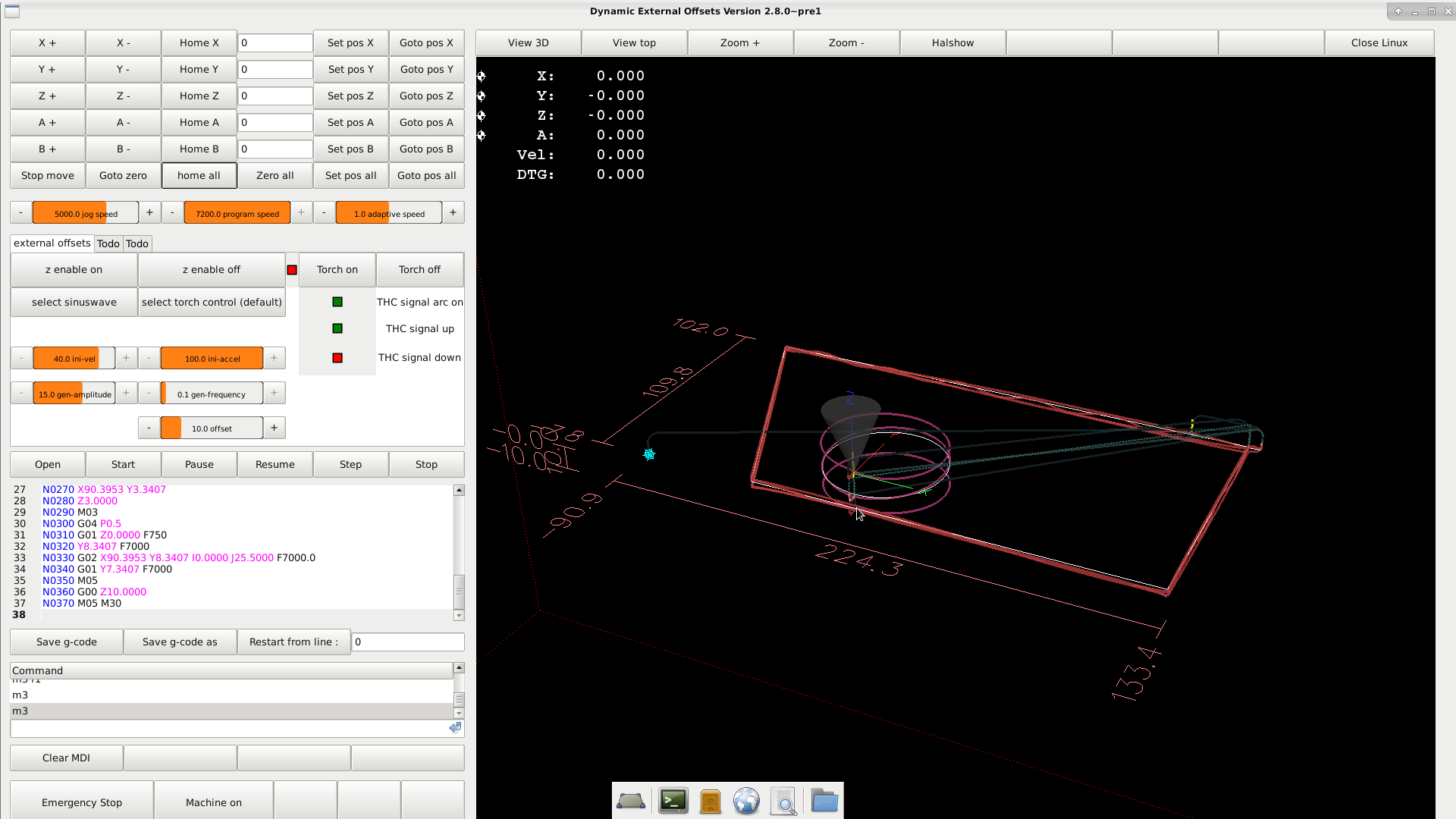

@Hi Rod,
Thank you for your input.
I was thinking about your steel parts. For 8mm you need 65 amps to cut easy.
This morning i finally get the external offsets working with proma thc.
I inserted a hal side mux2 to switch between :
- orginal sinusgenerator z axis output, for milling machines, for milling sandwich panels with metal top plates, this is fantastic for tool stand time.
- A glade offset control balk that you can adjust z axis heigt when you want, on top off that item i have build the thcud function. It works amazing !!
You can choose now with a screen button. Now i need to finalize the screen design.
My postgui.hal file stay's very short in code.
