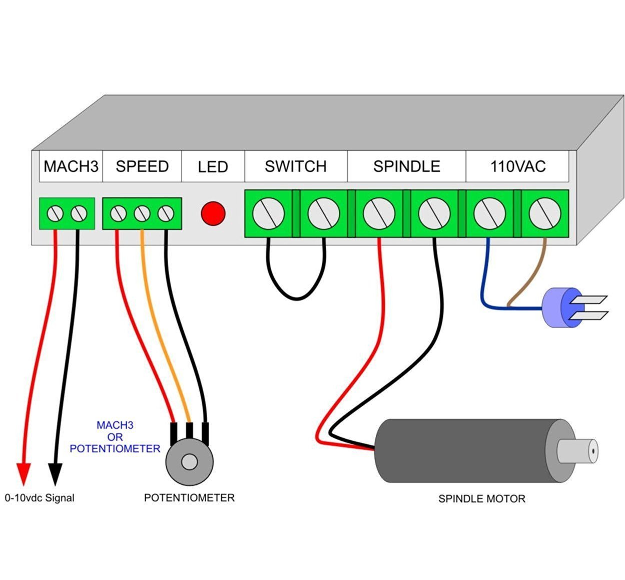

I am rebuilding a tiny router for PCB milling and I grabbed this motor and controller
www.amazon.com/gp/product/B01LNBOCDA/ref...ages01?ie=UTF8&psc=1
I want to be able to control the speed from linuxcnc
The controller takes 0-10 analog for speed control.
it looks like I should be able to just connect there 0-10 + and - lines to the spindle + and -
does this sound correct ?
Thank You
Calvin

Yes, that ought to work.

Yes, the three cables from speed goes to the MESA Card and I suggest not to bridge the Switch, you may connect the cables to the Spindle enable signal of the MESA Card.

Just wanted to say thank you to everyone for the help
spindle works exactly as expected
the POT inputs are wired to the 7I76 and I used the spindle enable lines to turn it on and off
Thank You
