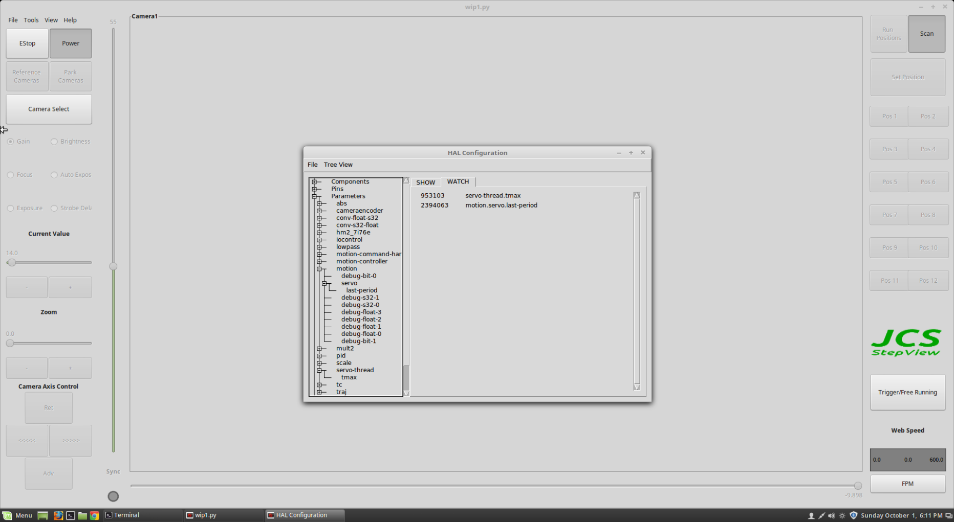

I'm working with a mesa 7i76e with a stepper driven machine with only 1 axis at this point (will have at least 2). The program and GUI is completely custom. Currently I'm getting some crashes and freezes while the program is running automated movements but I'm realizing this is likely due to a camera and how it's being displayed in the GUI using up too many resources which is something we have to sort out anyway. Not using any Gcode stuff, just jogging between positions set in the python code.
I get slightly confused by the 7i76e as it only runs on servo-thread and alot of info I find revolves around the base thread. So I have to fix the GUI camera issue but I'm trying to see what are the realistic expectations of the system when that is sorted as I likely have to change the step rate as well to add a geared stepper and larger pitch belt to reduce some jerkiness. I'm calculating the step scale to be at ~1700 with 1 and 2 inch per second automated jog movements.
Running a latency test with the base thread disabled and a few GLXgears running nets about 30 msec jitter. The camera displayed properly in a separate program runs jitter up to almost 150 msec. I assume that LinuxCNC with the current GUI displaying the camera as is would net a higher jitter based on the latency of the image displayed and may be the cause of the crashes but I have not tested latency with the GUI running as is.
So assuming that the best I can do is 150 msec jitter with the PC as is (it's not really feasible to modify this PC much), I'm trying to figure out if I'm going to wind up with a reliable system when all is said and done. The servo-period is set at 1000000 and I'm wondering if I should change that as well.

This was pretty good troubleshooting advice, it allowed me to narrow some things down and verify a few things. Hopefully these screenshots aren't too outrageously large. I took some screenshots with my desktop PC controlling the machine PC over VNC. VNC obviously adds some overhead and ties up the other ethernet card as well.
This shot is with my GUI config with the camera not displaying anything. From what you've said, this should be plenty acceptable?

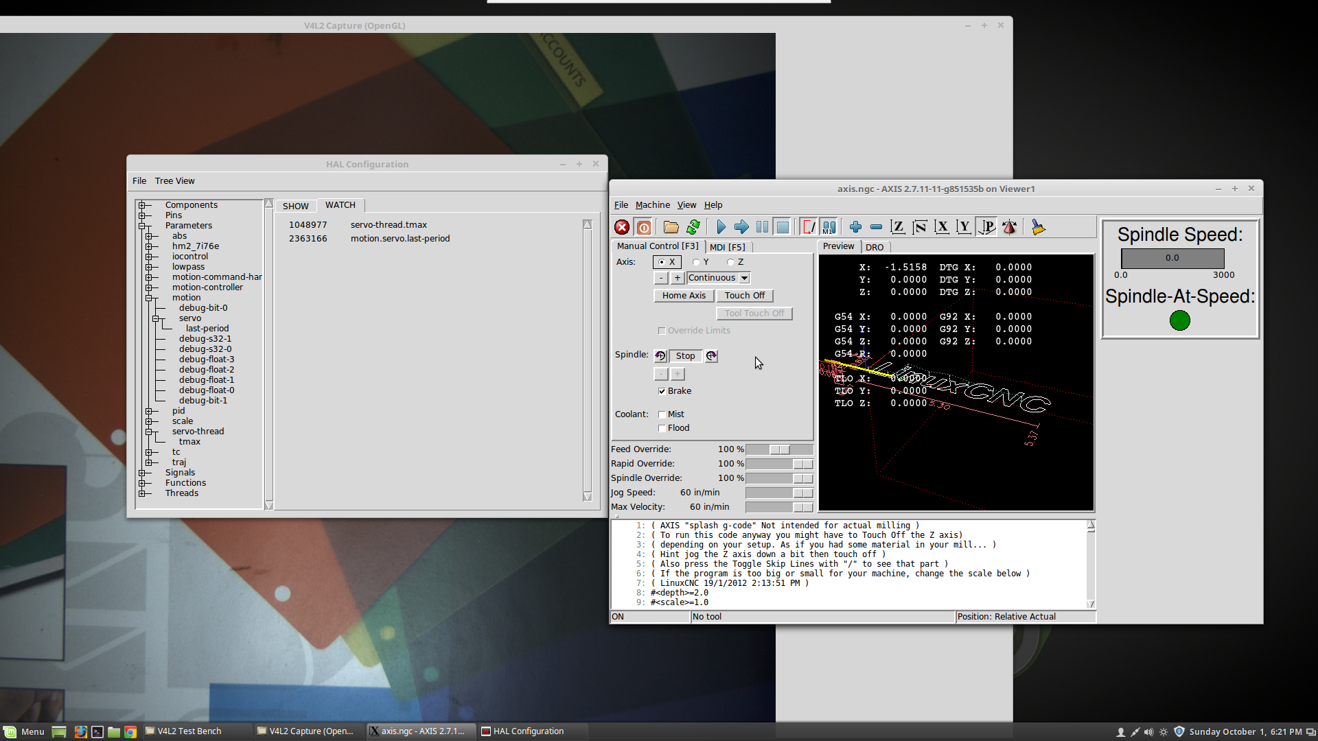

This shot is with an Axis config running and the Camera being displayed by the separate qv4l2 app which is also likely acceptable.

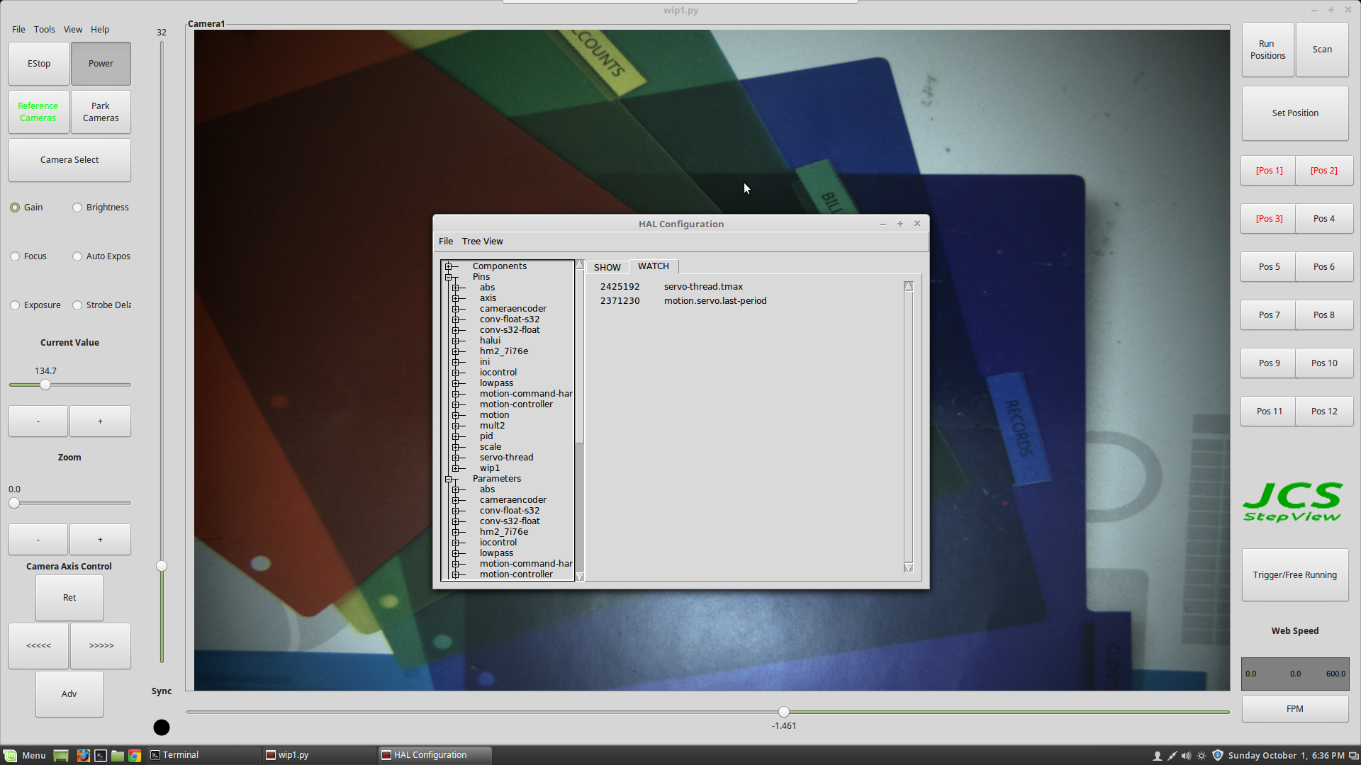

And this is the shot that's likely to be a problem. The image processing with in my program is causing the tmax to run much higher.
The thing is that I don't have any noticeable missed steps. Positional accuracy on this thing is important but it's not something that's going to cause out of tolerance parts. It basically runs either from end to end repeatedly or cycles through stored positions over and over, so accumulated errors could be an issue though I haven't seen them yet. Right now it's using a direct drive stepper on a 2mm belt, looking at 40mm/rev or a step scale of 508 and speed of 1-3ips (0.5-1.5khz?). I'm likely to change to a 5:1 geared stepper and 3mm belt to smooth it out a bit. Doing that to increase the step rate and hopefully eliminate the slow speed vibrations. That's still a relatively low step rate and I suppose a missed step in that case is even less critical since the output angle goes from 1.8*/step to 0.35*/step.
Would you say it's likely that the lockups and crashes are due to resource usage in the python code rather than LinuxCNC being unhappy about something?

02 Oct 2017 00:57 #99757
Replied by PCW on topic Mesa 7I76e and step rates and latency
I would not expect lost steps from timing violations unless they we really long (multiple milliseconds)
and caused a step motor stall due to a larger velocity step than the motors can follow.
If you do not have high accelerations you might try slowing the servo thread to say 500 Hz (2 ms)
and see if that eliminates the latency warning issues
My guess is that any hangs/crashes are more likely due to bugs than resource exhaustion
Have you run "top" when the system is running with video?
Your Ethernet MACs are Realtek PCIE chips so fine for realtime

Due to the beauty of Linux I was able to actually move the machine PC HDD to my desktop and run the ethernet cable into the 7i76e, with minimal changes I was able to boot the entire setup. LMDE2 was running in software mode so that was eating up some CPU and I still saw 1/3 the servo-thread latency.
Now I saw "motion.servo.last-period" at nearly 5000000 while servo-thread.tmax was around 1000000-1500000 iirc. So I'm assuming the higher the "motion.servo.last-period" the better?
It seems we can't change much about the camera usage and even though I may be able to work around the latency there are camera performance issues. So I think I'll have to retire this little PC until I build a CNC mill or something. Latency seems pretty decent with just LinuxCNC and some normal tasks.
- Posts: 18103
- Thank you received: 5326
03 Oct 2017 01:55 #99800
Both times are in CPU clocks so its the ratio that's important
(divide both by CPU clock frequency to get times in seconds) so
motion.servo.last-period should be about CPU CLOCK/1000
at 1 ms servo thread
