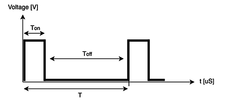

I am retrofitting a older 1995 Brushed Haas VF-2. The drive cards use a signal to enable them (High/Low), a direction pin (High/Low) and a velocity signal that is 100ns at holding power all the way up to 16us at full velocity with an update at 16khz. The signal is pulled low (pulse width is at zero volts and remainder is +5)
I am planning to use mesa hardware. Is there a method for creating a signal such as this in hal? I would like to close the loop as well as be able to tune it within LinuxCNC. I am hoping I can use these cards as it will make the retrotit much cheaper and faster to finish.

20 Nov 2017 19:57 #102100
by DaOne
Replied by DaOne on topic Outputting a pulse width for velocity servo control possible?
Andy, the wave for is very closely resembling that of a RC hobby servo. The "Toff" in this photo is what sets the velocity. It is liner with 100ns being idle and 16us being full speed (Velocity mode) The frequency of this is 16khz. I will need at least 4 output channels for XYZA channels that will be closed loop via the 2000 line encoders they have (8000 counts)
- Posts: 19888
- Thank you received: 4647
20 Nov 2017 20:04 #102102
Replied by andypugh on topic Outputting a pulse width for velocity servo control possible?
The Mesa PWM has enough resolution to work on a limited range of PWM. You just need to limit the PWM output between 1.6% and 25%. And you need to invert the output.
