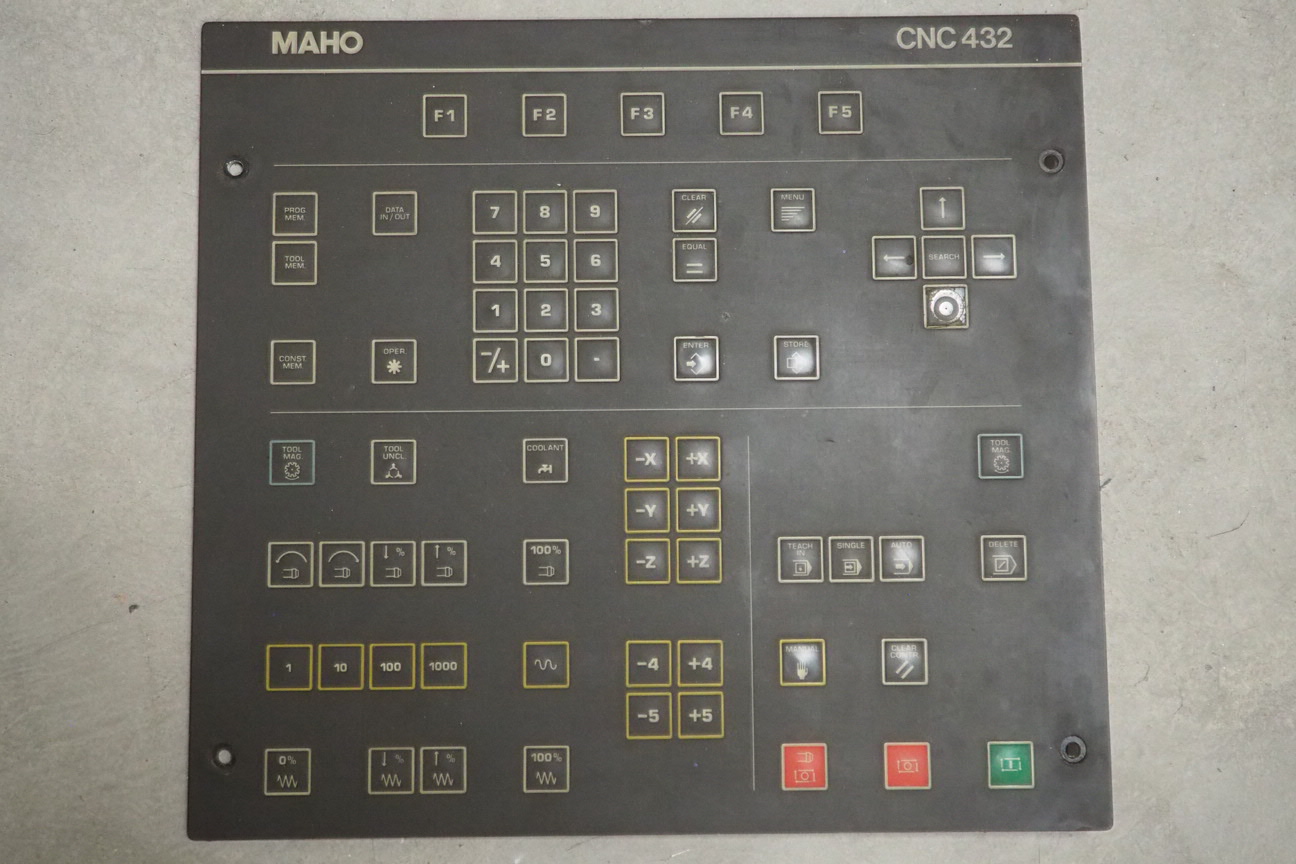

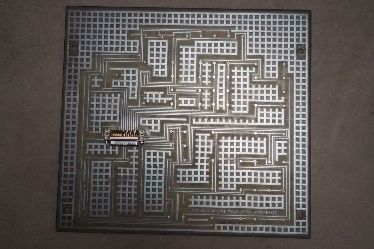

Questions on interfacing a MAHO Phillips 432/10 keyboard with mux_generic. was created by RotarySMP

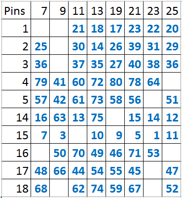

I was discussing interfacing the MAHO / Phillips 432/10 keyboard into LinuxCNC with Jens from Germany, who has a 600E.
The keyboard's 69 keys (numbered 1-80 with gaps) are multiplexed out on a simple 8x10 matrix of 18 pins of a 25 pin D-Sub connector.
The two attached pdfs Blatt1 and Blatt2 go together.
Jens already surveyed the pinout, and it looks like this. The blue numbers are MAHO's assigned key numbers.
Q1/ Can mux_generic do a non-square matrix like 8x10?
Q2/ Is this correct syntax?
loadrt mux_generic config="bb80” # Load rt component MUX-Generic configuered for bit in, bit out with 80 pin

Then we create some placeholder signals for the 18 input pins to connect to...
Net key_pin_01 <= hm2_5i25.0.7i84.0.1.input-01
Net key_pin_02 <= hm2_5i25.0.7i84.0.1.input-02
Then those signals are connected to the mux_generic input pins. This is the bit I dont understand from the documentation and other threads on the topic.
Q3/ How do I code it to make the rows and column assignments of an 8x10 matrix. Is it with some clever binary code at the end of the ...sel-bit command?
Net key_pin_01 => mux-gen.00.sel-bit000
Net key_pin_02 => mux-gen.00.sel-bit001
