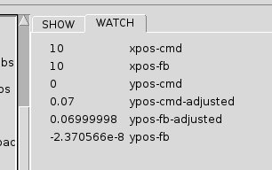

16 Feb 2018 21:54 #106047
by pgf
Replied by pgf on topic using HAL to correct axis errors
Your suggestions work(ed) well! Thanks again.
I realized that I also need to do a reverse transformation for the feedback path.
So now my component looks like this:
and my custom.hal looks like this:
and after an X traverse from 0 to 10, the signals look like this, which leads to one more question.
Should I be rounding off the math, perhaps to the nearest .0001, to ensure that I don't accumulate precision errors of some sort? Or is this kind of trace discrepancy eliminated elsewhere in the code? I don't want to someday get a "following error" because of floating point inaccuracy.

net ypos-fb nonsquare-table.0.y-fb-out => axis.1.motor-pos-fband after an X traverse from 0 to 10, the signals look like this, which leads to one more question.

16 Feb 2018 22:12 #106048
Replied by rodw on topic using HAL to correct axis errors
Great you got it going.
I don't believe that there is a need to round the numbers as you are not accumulating them in anything.

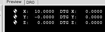

Just a thought. What do your DRO's say?
- pgf
- Posts: 127
- Thank you received: 25
16 Feb 2018 22:28 #106050
by pgf
