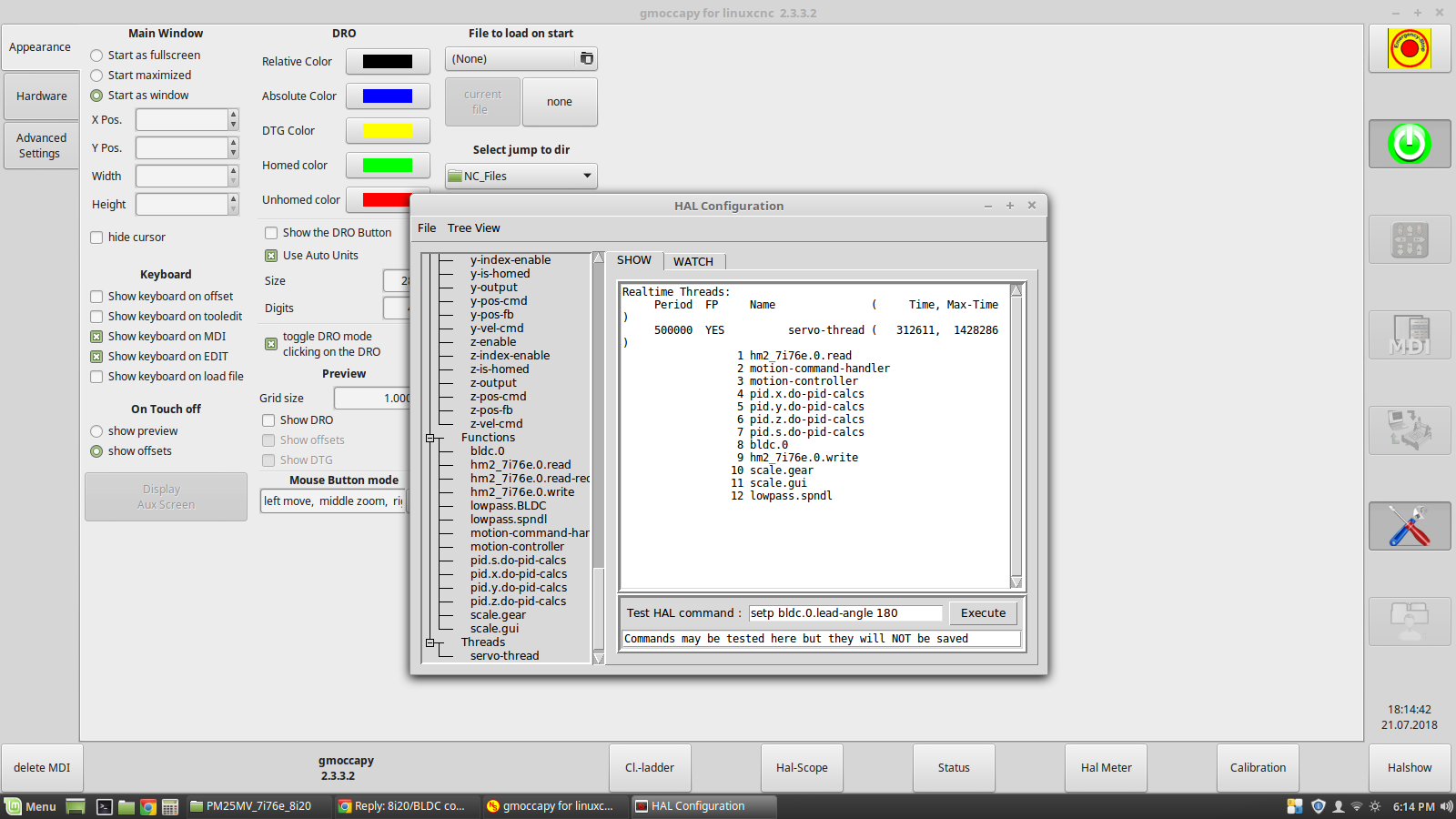

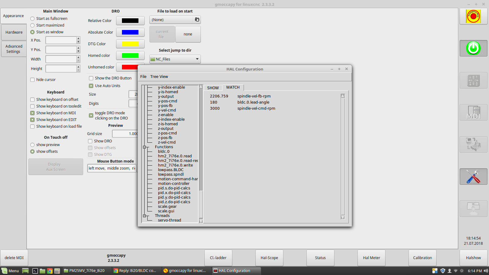

Alright, so setting the servo thread to 500000 and starting the gui, A requested spindle speed of 3000 nets only a speed of just under 2100.
The BLDC lead angle is set in the hal file to 90 (always has been)
if I setp the bldc lead angle while it's running at a speed below the requested (2100 vs 3000) I get no noticeable change in speed. It eventually starts to hover around 2200 rpms.
Replied by blazini36 on topic 8i20/BLDC component, limited spindle speed
The motor is no name-plate 750w 6pole BLDC with 3 hall sensors. I believe I figured the pole count by applying a voltage to 2 leads and counting 3 cogs in 1 rotation. The original drive was just a chinesium board with no transformer of any actual mass and a couple of big caps so I assume it rectified 120v AC to ~160v DC and this ran at 2500rpm. I have the 8i20 powered from a 120vAC-bridge rectifier-2,1000uf caps=160vdc. My mains is switched by 2 solid state relays and I can easily take the plug off the power cord, stick a 240v drier plug on it and the power supply will be at 320v, but I doubt the motor can take that (any thoughts?)We've run the 8I20 over 6000 RPM with a 4 pole motor and LinuxCNC/BLDC
I suggested tuning changes because you stated that changing the servo thread rate didn't make a substantial difference (which is quite surprising) and I thought it might be that you had a low inductance motor so the default current loop tuning parameters were too high. This can lead to oscillations/ringing on the steps in commutations
Can you try a 2 KHz servo thread again with no other changes?
Or as Andy suggests, adjusting the lead angle when its running at high speed to see if the commutation delay is really the issue
or there's something else limiting your speed (motor voltage encoder setting etc, etc)

- blazini36
- Posts: 972
- Thank you received: 167
22 Jul 2018 01:36 #114650
by blazini36
5-10 times, wow thats scary. I assumed the 8i20 limited the amount of current that went through it to the setting,is this not the case? There'2 no transformer in my 8i20 drive so I'm not sure what the winding resistance might be unless we're talking about the motors windings.
I didn't even know such a thing as a voltage doubler existed.
I hooked up a cordless drill to my spindle and set the 2:1 pulley. The drill rated a speed of 1300 so I estimated 2600rpms at the motor. I read 66v between 2 phases so I wasn't sure what to make of that.
