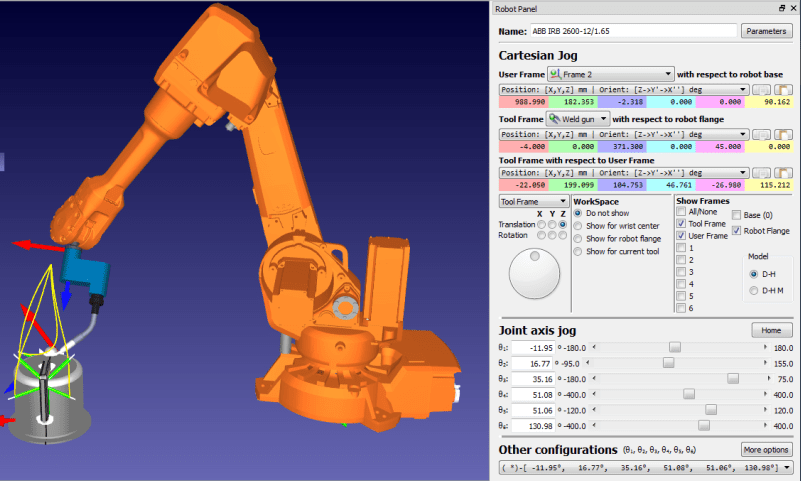

Hi Grotius!
Your custom robot interface sounds like a great development. It would be particularly good to have a way of visualising the basic kinematic chain of the bot in the GUI, and not just vismach, to ensure that the calculated joint angles match. As you probably know, with inverse kinematics there are multiple solutions to any positioning problem and the possibility of singularities (gimbal lock), so a way of making sure vismach and the controller agree would be very useful. Getting the 6DOF bots actual spherical work envelope would similarly be great for ensuring that the gcode sits in an accessible area.

Replied by andypugh on topic Genserkins failure with custom robot
It should be possible to write a Vismach model (which is a Python script) that interrogates the INI file DH parameters and adaptively models a matching robot.

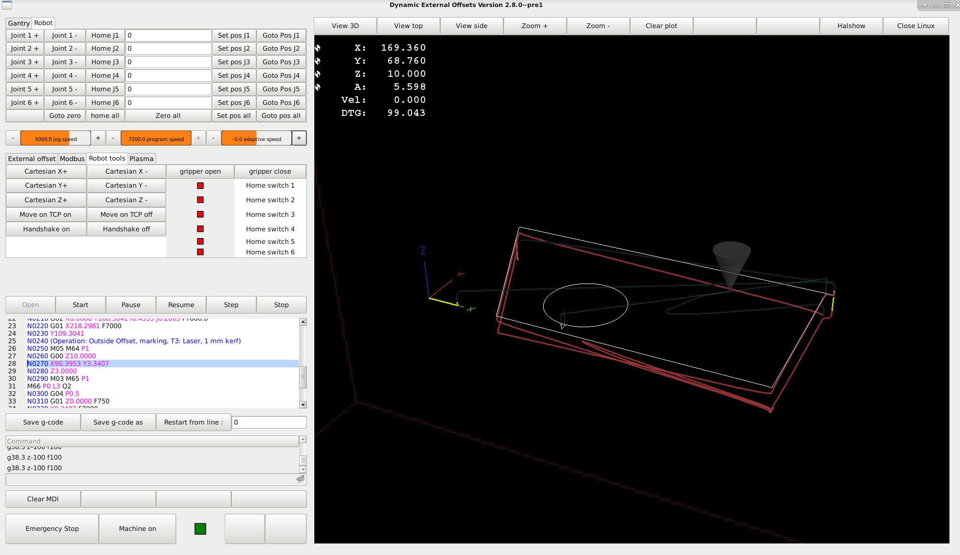

15 May 2018 18:32 - 15 May 2018 19:50 #110772
by Grotius
Replied by Grotius on topic Genserkins failure with custom robot
Hi Wireline,
I will start with the special robot interface screen today. I will show a first example coming time.
This will be based / expanded on the current grotius screen layout, and we will disqus this, improve this and test this.
At the moment great improvement is my github channel. Here you can download and compile your program example when program is ready to test.
Okey, i would by happy if you have time to make a gantry example in vismach. the most simple gantry model that can be loaded into
a basic configuration in minutes, with some guiding text how to do this. If you have tested this, please put the file's in the document secion of linuxcnc and report that it is done. I think for you this is not much work.
This i found on google :
Here you see a first attemp. I see a diffiulty, but maybe not. Is linuxcnc interpolating the cartasian movement? I guess yes...
Is that based on your ini file robot setup? The joint's with the mm distance between the joints in the ini file? So yes, then it is easy.
I think for most users the home switches are necesery. Because of stepper motors. A few users can use servo's with battery encoders. They don't need the limit switch. But Kuka would be better with automated home switches when robot is out of position.
The kuka tool to calibrate the robot is then not nessecery anymore. So what is your thought's about home sensors?
Think about what you want to see on the screen.
Tcp mode is for moving robot around tool center point. This is very nice fuction. But i don't know linux has that interpolation model at the moment, maybe you know.
Handshake is name to interpolate with external axis. For example when you are welding on rotary axis. I even don't know if linuxcnc has this interpolation model at this time.
The toolpath you see in red, is playing around with external offsets and negative adaptive speed.
What i want to say about vision systems.
Best is to start with cheap web cam. Mach3 and sheetcam has webcam plugins. I preferr to searc for an example python
web cam code. After you get this, it is easyer to implement into real code. We can do this with gcode parametric input or subroutine bases on variable gcode. I think that is not really a problem. The difficulty is to make the vector and position into gcode output.
If you use 2 camera's you can make calculation of dept'h.
I would say keep on cutting :
LinuxCNC can do tool centre point
There is an already-existing gantry Vismach model in LinuxCNC
sim->axis->vismach->5-axis->bridge mill
That actually does the tool-point-centre motion that you were asking about, once homed.
And there is already a Vismach tutorial here: linuxcnc.org/docs/2.7/html/gui/vismach.html
