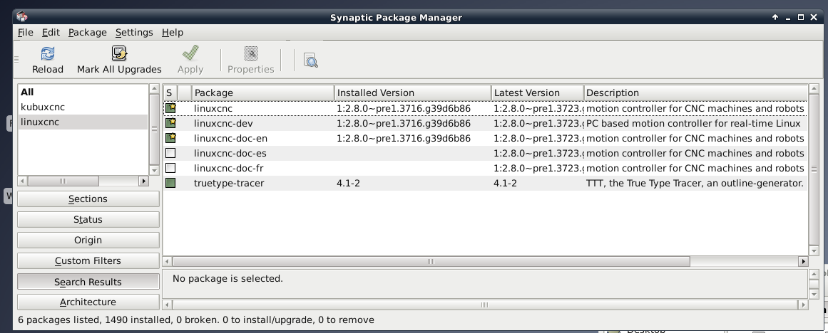

It looks like I am on master for my dev build, and on the old 2.7 for the realtime build, the one that the main installation wiki points to. You are right that the latter is different and has the axis definitions in the HAL file rather than the joint ones found in the master branch.
Do I need to upgrade my realtime install, and is this done via the realtime install itself? I am battling connectivity problems with my realtime install - the installation process seems to complete the DHCP checks fine but then cannot find any network once the OS boots up.
Additionally, should the version actually make any difference? My robot vismach sim works fine in the dev build. Are files created in this incompatible with the 2.7 wheezy? As far as I can see the current Installation Wiki links to a build with the same outdated "axis" hal file.

Reports that the installed realtime version is 2.7.0, which was downloaded from the wiki link above (with a very recent page update date), so it appears that is the version in the current iso.
Executing my config with linuxcnc -k (to ignore hal file errors) yields a number of error messages relating to undefined TRAJ AXES e.g
so it seems that 2.7.0 is looking for axis definitions in the ini and hal, and 2.7.13 (which I have in my dev build) looks for joint definitions.
Is it possible to get a 2.7.13 iso? Ideally I do not want to rewrite all my files
dpkg -s linuxcnc | grep -i versionReports that the installed realtime version is 2.7.0, which was downloaded from the wiki link above (with a very recent page update date), so it appears that is the version in the current iso.
INIFILE: ERR_TAG_NOT_FOUND, section=TRAJ, tag=AXES, num=1, lineNo=64so it seems that 2.7.0 is looking for axis definitions in the ini and hal, and 2.7.13 (which I have in my dev build) looks for joint definitions.

Master is 2.8 which is what you get by cloning the repo, you have to checkout the 2.7 branch if you want to build for 2.7.13.
To get 2.7.13 as a deb you have to upgrade linuxcnc by synaptic.

My mistake - the dev build is 2.8 (which I have installed in another linux install). You are right that came from the git master branch.
My realtime build, installed on a separate partition, is the 2.7.0 that the installation wiki links directly to as a direct iso download, no git involved.
If not downloadable, is it possible to create an iso out of the master branch git files? Getting 2.8 into its own separate partition seems to be the way to go. I cannot upgrade in place due to the connectivity problems in my partitioned install.

If you follow these instructions for building a 2.8 deb
forum.linuxcnc.org/9-installing-linuxcnc...install-or-deb#86438
I can't see why you can't uninstall 2.7 and install 2.8.......obviously you need the deps, but that's going to be an issue cos of the network problems.....
What are the details of your network device, wired ? wireless? make, model ? Might be able to suss that out for ya.
Does your device get mentioned if you run sudo ifconfig ?

Right, cracked it! It was device drivers. Once the right intel drivers were built and installed, I could connect and then update to 2.8. Bot is now happily scribbling away!
