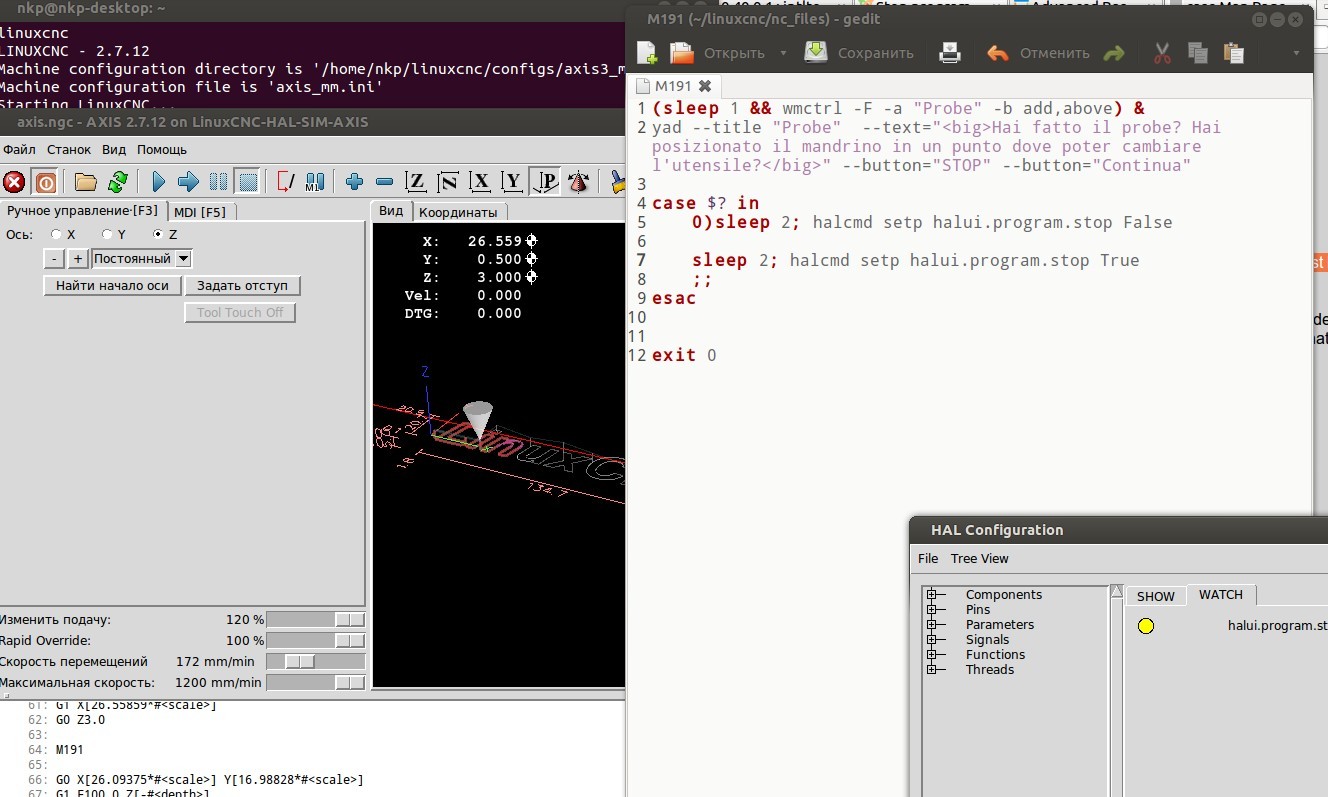

- nkp
- Posts: 143
- Thank you received: 39
27 Jun 2018 11:26 #112926
by nkp
Replied by nkp on topic Stop program from M-Code
It works for me
exit 0
(sleep 1 && wmctrl -F -a "Probe" -b add,above) &
yad --title "Probe" --text="<big>Hai fatto il probe? Hai posizionato il mandrino in un punto dove poter cambiare l'utensile?</big>" --button="STOP" --button="Continua"
case $? in
0)sleep 2; halcmd setp halui.program.stop False
sleep 2; halcmd setp halui.program.stop True
esacexit 0
