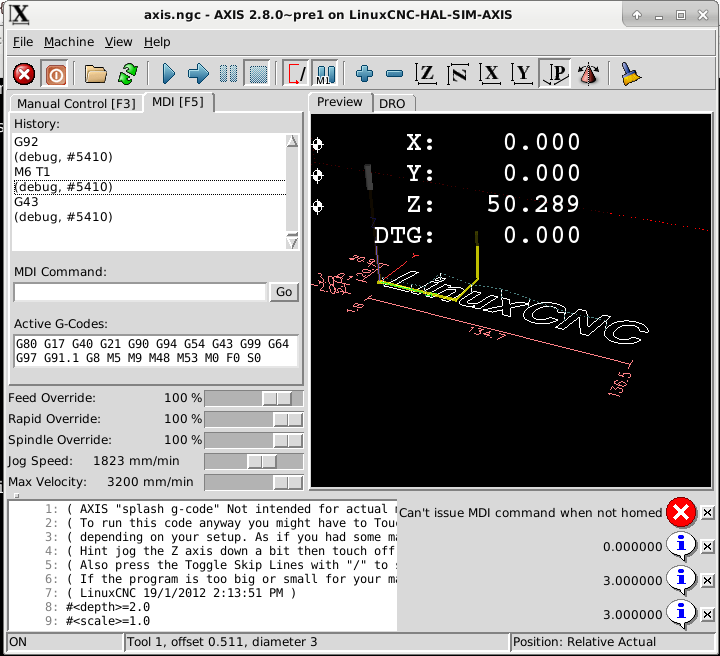

18 Feb 2019 18:50 #126721
by cahlfors
Replied by cahlfors on topic Automatic touchoff of face mill
I am having another go with this:
Ideas?
/Chris
It turns out that #5410 is always zero for me. I have added a non-zero diameter in the tool table for a specific tool, reload the tool table and change to that tool. Still zero.G53 G0 X[100 - #5410] Y100
Ideas?
/Chris

12 May 2019 14:25 #133557
by cahlfors
Had some more time to tinker with this. It turns out that #5410 et al contain information about the *current* tool, not the one we are changing *to* and so cannot be used in the remap code. I suppose that enabling cutter compensation would suffer from the same problem. Is there a way to find out the tool diameter in the remap code?
18 May 2019 11:45 #134174
G43 takes an optional H parameter, so you can issue a G43 to load the offsets for the next tool and read out the diameter from #5410 without physically changing tool.
You probably then want to zero-out the offsets (G49) before probing and finally load the new offsets at the same time as issuing the M6.
Replied by andypugh on topic Automatic touchoff of face mill
