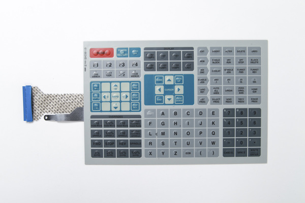

I am trying to create a custom keypad using an arduino to matrix the 130 key membrane keypad. I got the arduino side done sending each key as a code via serial. I plan to use the component that ArcEye created a while back as a base. I think I have all the pins figured as hal pins but I want the standard keyboard part to work as an actual keyboard for input. Is the a way in the .comp file to send a keystroke like if it was a real keyboard? Also if there is how would I handle "shift" commands? I can manage the shift key on the arduino side and just give every uppercase key a different key code.
