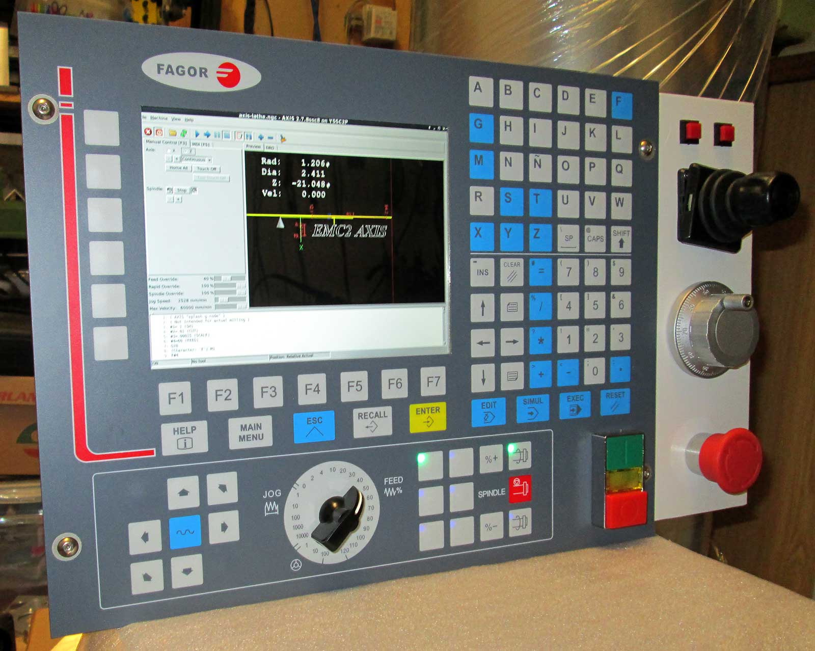

I am trying to create a custom keypad using an arduino to matrix the 130 key membrane keypad. I got the arduino side done sending each key as a code via serial. I plan to use the component that ArcEye created a while back as a base. I think I have all the pins figured as hal pins but I want the standard keyboard part to work as an actual keyboard for input. Is the a way in the .comp file to send a keystroke like if it was a real keyboard? Also if there is how would I handle "shift" commands? I can manage the shift key on the arduino side and just give every uppercase key a different key code.

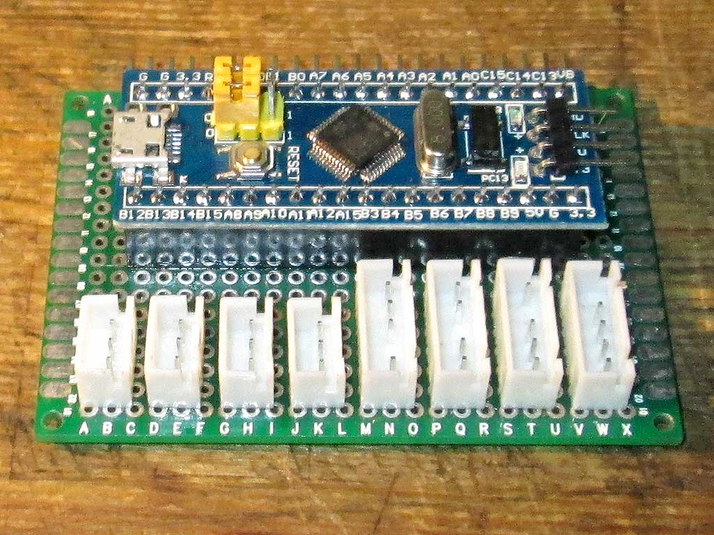

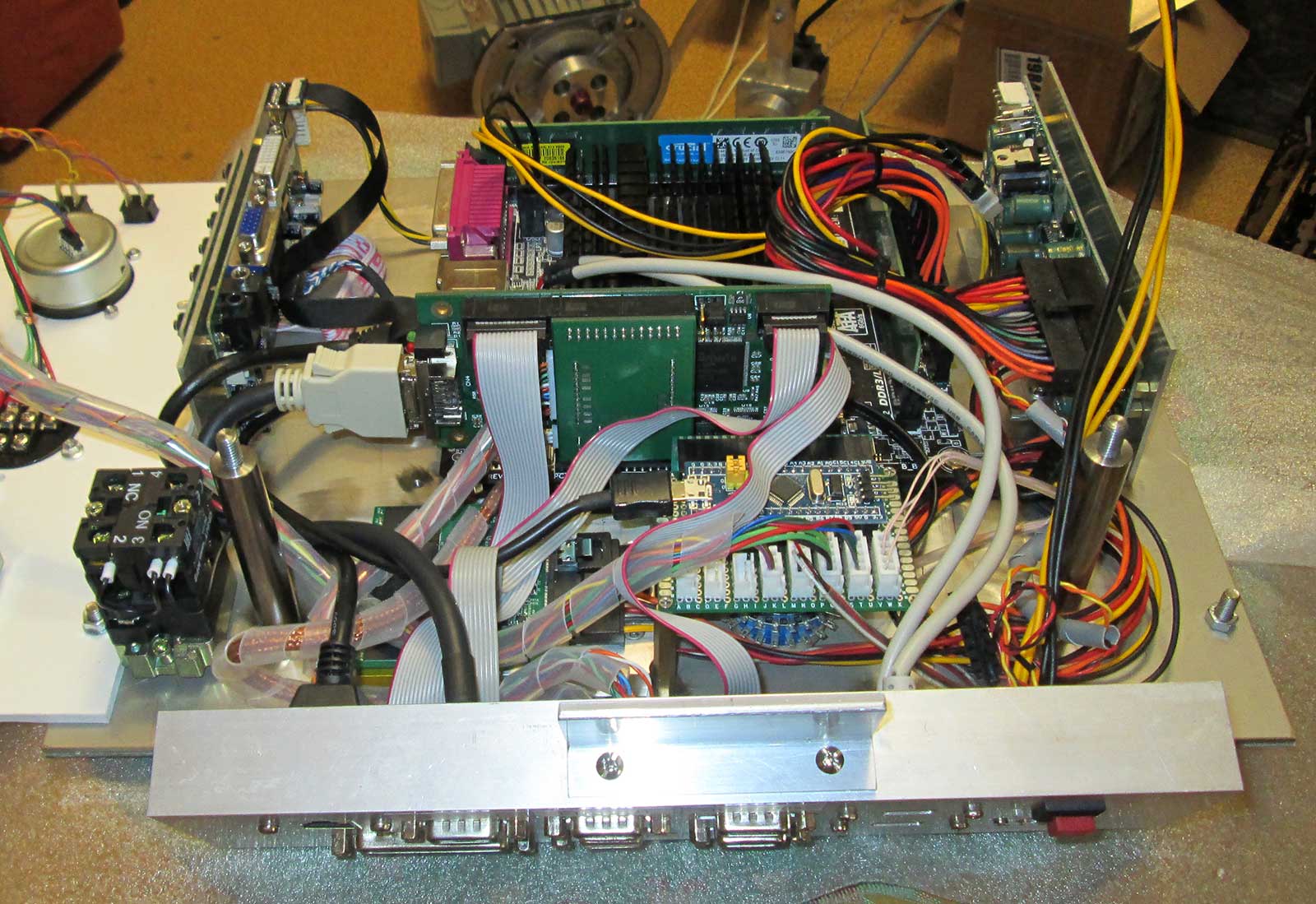

i did a membrane keyboard controller using a STM32 as a USB HID. it emulates a standard keyboard plus a bunch of other keys which were handled by hal_input comp. rotary encoder and analog joystick can switch between being a mouse with a wheel and linuxcnc's MPG and joystick. 24-pos rotary switch is handled by an ADC. drives a chain of RGB addressable LEDs. also has a few hardware buttons for cycle start/stop etc...
if someone interested can share the code, but it is a bit more than a little messy, i think...
