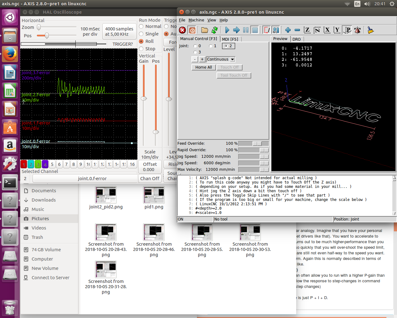

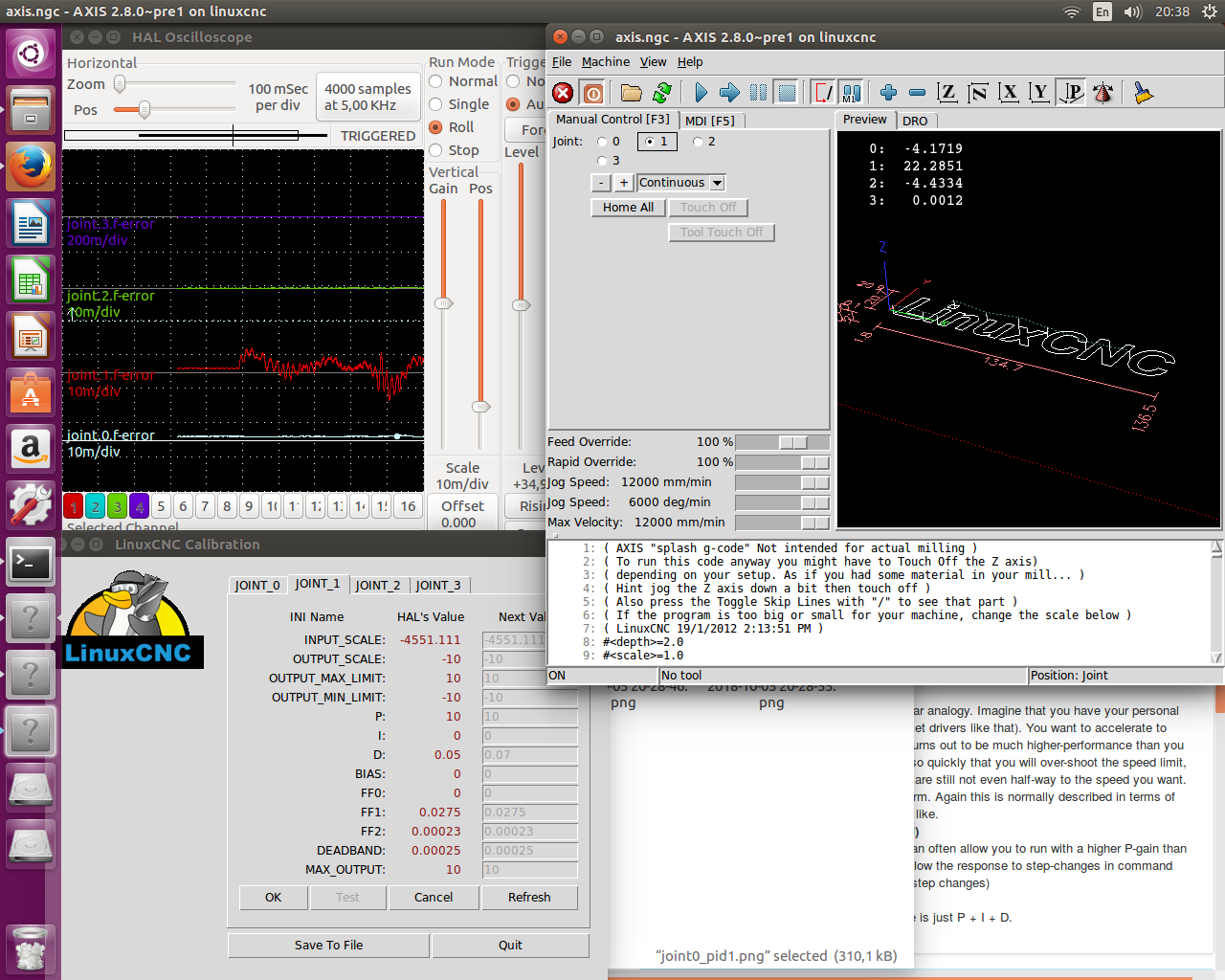

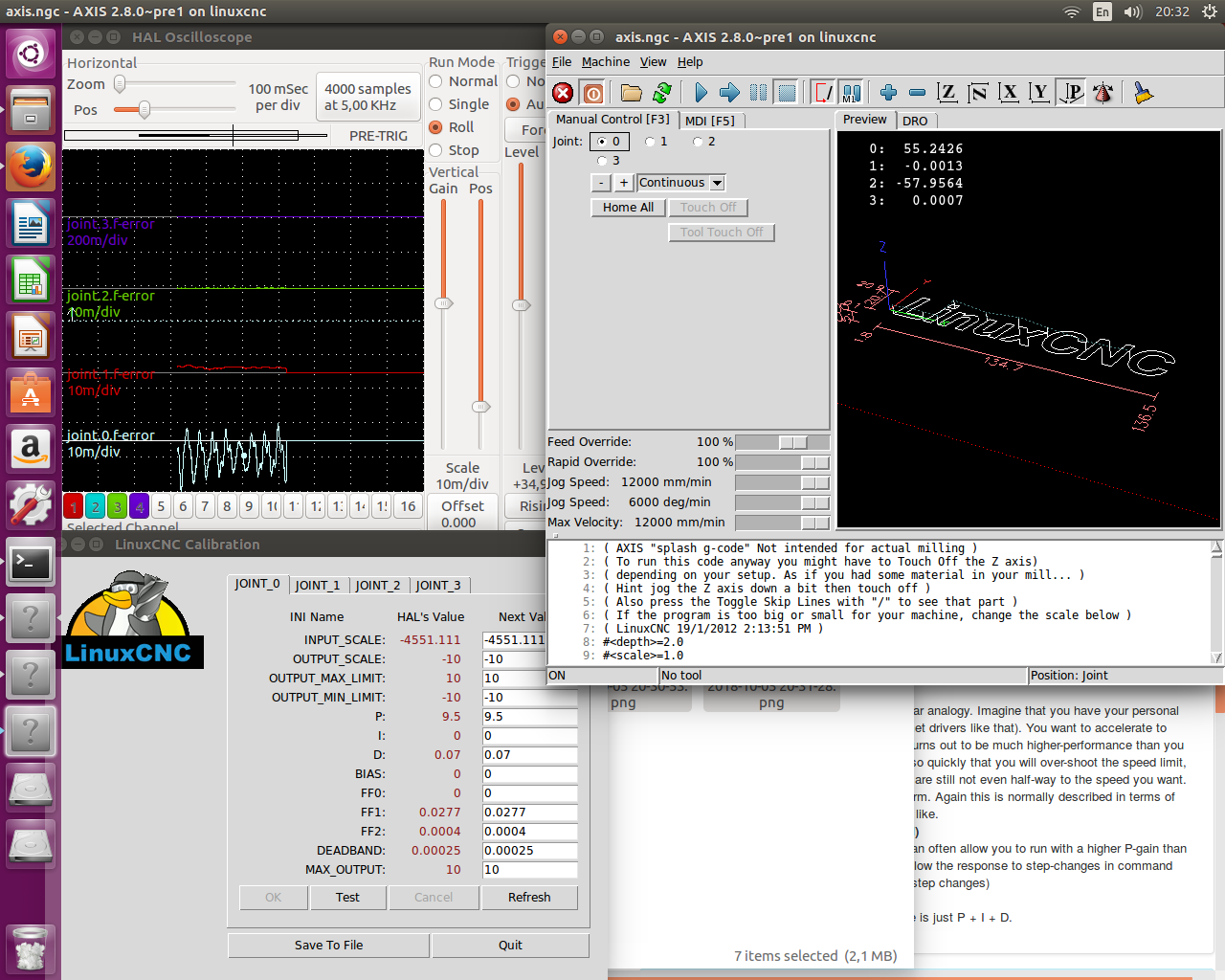

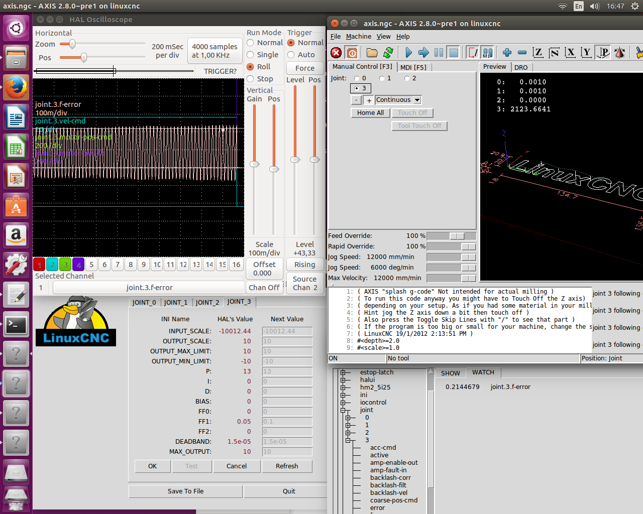

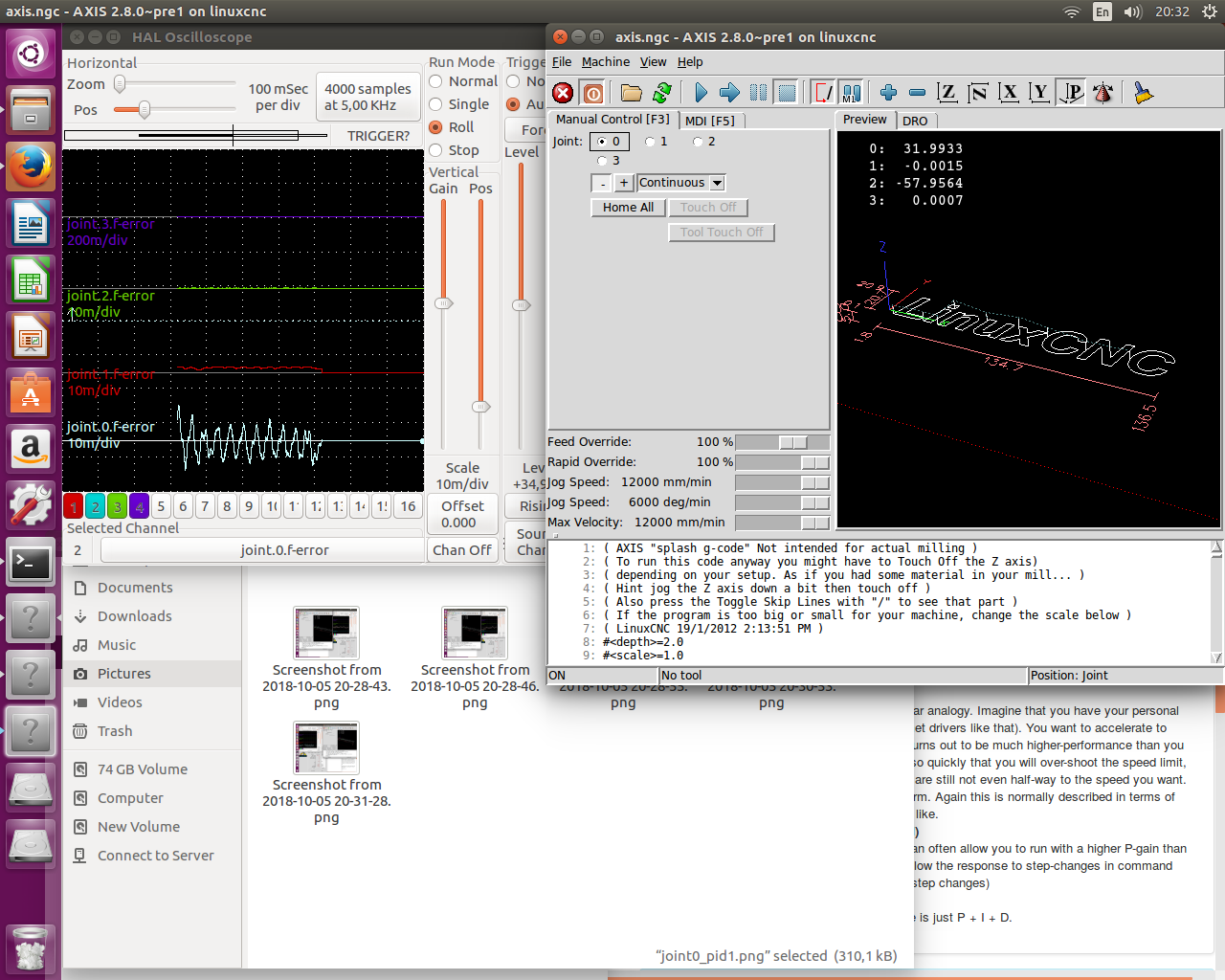

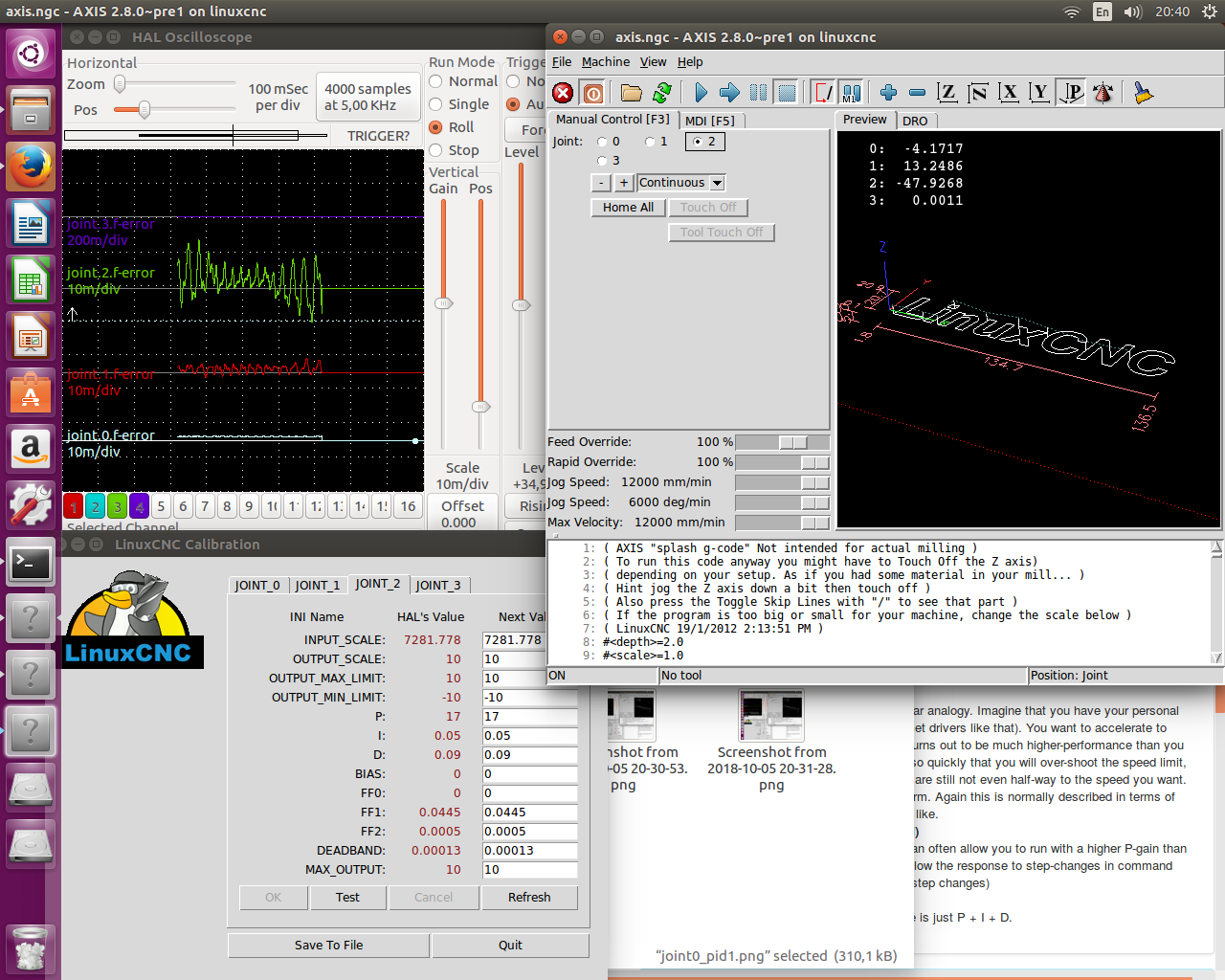

04 Oct 2018 10:02 #118435
by thang
Replied by thang on topic AC servo running slow at 0V analog

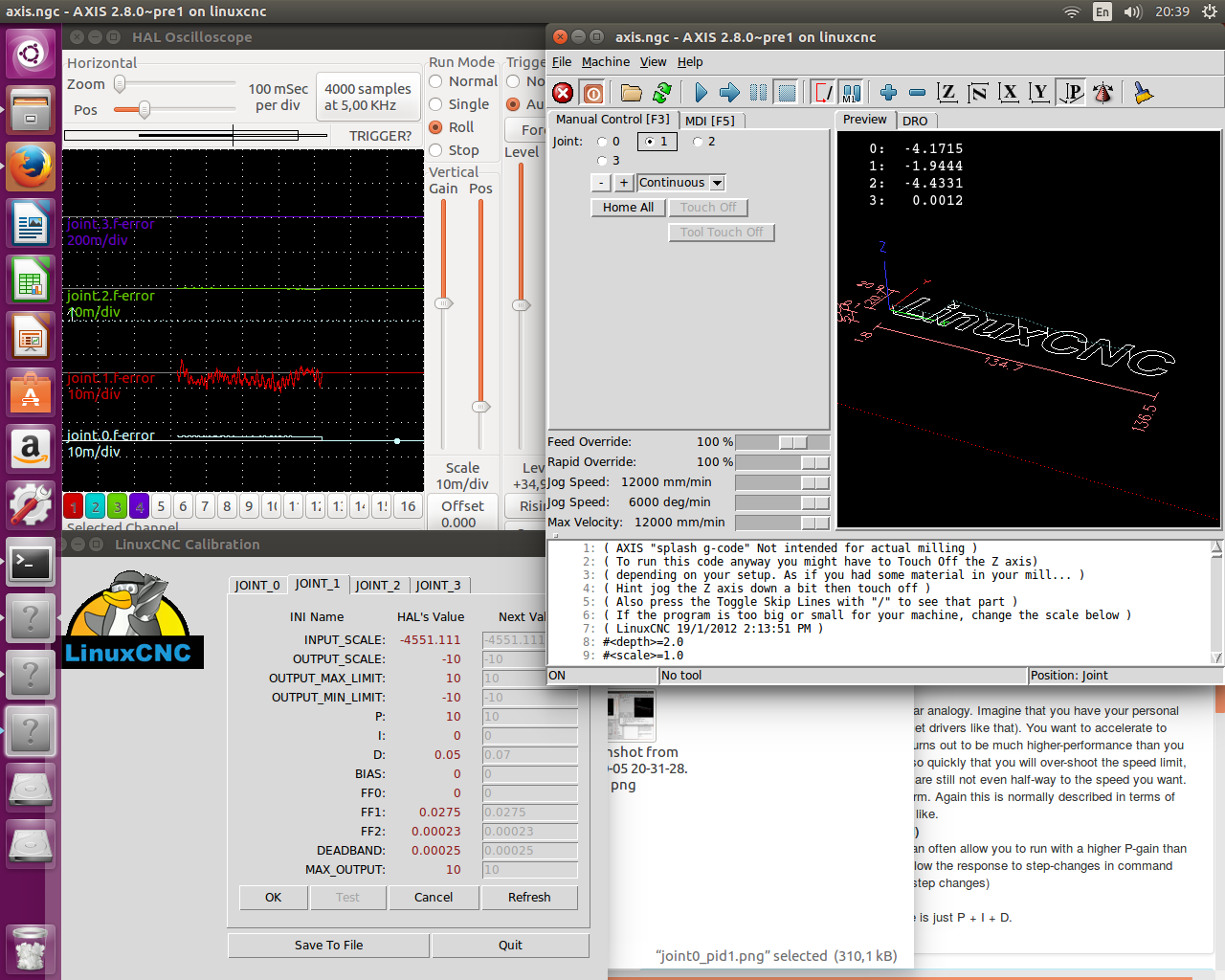

There are somethings i disturbance when i use velocity mode:
+ Should i use auto tuning function of AC servo driver as 1st close loop?
+ Using max velocity to tuning ?
About tuning PID, first i increased maximum P without oscilation, then i set FF1 but this is the best result i got ( i was using auto tuning inside driver). Any recommend for me to increase accuracy?
- Posts: 19888
- Thank you received: 4647
05 Oct 2018 12:32 #118471
Replied by andypugh on topic AC servo running slow at 0V analog
A little bit of D might kill that oscillation. (and I mean a tiny bit, start with 0.0000001 and take out the zeros one by one)
Otherwise it looks like the P is too high.
- thang
- Posts: 196
- Thank you received: 11
05 Oct 2018 15:17 #118475
by thang
After decreasing servo-thread from 1ms to 250us, making some changes, i got better result but i'm still not satisfied. I will try your recommend in tomorrow.
But i still want to refer your experience, should i use auto tuning inside AC servo driver for 1st close loop? I use this for tuning torque then i use 2nd close loop on linuxcnc to control position, I dont want to manual tuning torque because i cant estimate it, my machine is an arm robot
