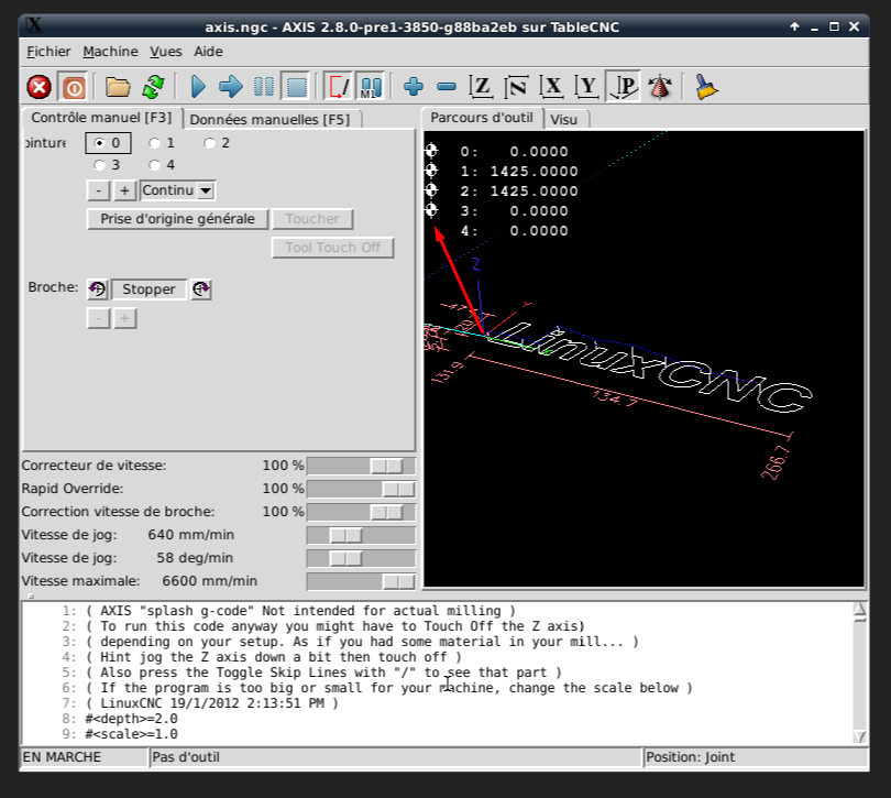

Hello
I have a 4-axis machine, with two driver / motor / endstop on the Y axis, and LinuxCNC 2.8 (On official LinuxNC 2.7 ISO).
When I start the machine, the user interface displays 0/1/2/3/4 joint for XYYZA, when I do homing it turns into X / Y / Z / A.
All is well, all works!
When I add the line
#INCLUDE XHC_HB04.inc
in the [HAL] section of the file machine.ini,
And after activating this patch manually : github.com/LinuxCNC/linuxcnc/commit/cb93...515812f48d79bf09bcbf
The machine after the homing remains lock on the joints 0/1/2/3/4 and not XYZA.
There are small targets that indicate that the origins have been found.
I would specify, that before I used the handwheel with this same machine but without the kinstype = BOTH and with linuxcnc 2.7
Do you have a solution ?

machine.ini
# Generated by stepconf 1.1 at Mon Sep 10 13:20:12 2018
# Si vous modifiez ce fichier, il sera
# écrasé quand vous relancerez Stepconf
[EMC]
MACHINE = TableCNC
DEBUG = 0
VERSION = 1.0
[DISPLAY]
DISPLAY = axis
EDITOR = gedit
POSITION_OFFSET = RELATIVE
POSITION_FEEDBACK = ACTUAL
ARCDIVISION = 64
GRIDS = 10mm 20mm 50mm 100mm 1in 2in 5in 10in
MAX_FEED_OVERRIDE = 1.2
MIN_SPINDLE_OVERRIDE = 0.5
MAX_SPINDLE_OVERRIDE = 1.2
DEFAULT_LINEAR_VELOCITY = 11.00
MIN_LINEAR_VELOCITY = 0
MAX_LINEAR_VELOCITY = 110.00
DEFAULT_ANGULAR_VELOCITY = 1.00
MIN_ANGULAR_VELOCITY = 0
MAX_ANGULAR_VELOCITY = 10.00
INTRO_TIME = 5
INCREMENTS = 5mm 1mm .5mm .1mm .05mm .01mm .005mm .001mm
PROGRAM_PREFIX = /home/blumax/linuxcnc/nc_files
[KINS]
JOINTS = 5
KINEMATICS = trivkins coordinates=XYYZA kinstype=BOTH
[FILTER]
PROGRAM_EXTENSION = .nc,.tap G-Code File
png = image-to-gcode
gif = image-to-gcode
jpg = image-to-gcode
py = python
[TASK]
TASK = milltask
CYCLE_TIME = 0.010
[RS274NGC]
PARAMETER_FILE = linuxcnc.var
[EMCMOT]
EMCMOT = motmod
COMM_TIMEOUT = 1.0
BASE_PERIOD = 100000
SERVO_PERIOD = 1000000
[HAL]
HALFILE = TableCNC.hal
HALFILE = custom.hal
POSTGUI_HALFILE = postgui_call_list.hal
[TRAJ]
COORDINATES = XYZA
LINEAR_UNITS = mm
ANGULAR_UNITS = degree
DEFAULT_LINEAR_VELOCITY = 1.00
[EMCIO]
EMCIO = io
CYCLE_TIME = 0.100
TOOL_TABLE = tool.tbl
[AXIS_X]
MAX_VELOCITY = 110.0
MAX_ACCELERATION = 500.0
MIN_LIMIT = -0.001
MAX_LIMIT = 838.0
[JOINT_0]
TYPE = LINEAR
HOME = 0.0
MIN_LIMIT = -0.001
MAX_LIMIT = 838.0
STEPGEN_MAXACCEL = 625.0
SCALE = 33.3767964377
FERROR = 1
MIN_FERROR = .25
HOME_OFFSET = 0.000000
HOME_SEARCH_VEL = -25.000000
HOME_LATCH_VEL = 14.980467
HOME_SEQUENCE = 1
[AXIS_Y]
MIN_LIMIT = -0.001
MAX_LIMIT = 1425.0
[JOINT_1]
TYPE = LINEAR
HOME = 1425.0
MIN_LIMIT = -0.001
MAX_LIMIT = 1425.0
SCALE = 33.2805316344
FERROR = 1
MIN_FERROR = .25
HOME_OFFSET = 1425.000000
HOME_SEARCH_VEL = 25.000000
HOME_LATCH_VEL = -15.000000
HOME_SEQUENCE = 2
[JOINT_2]
TYPE = LINEAR
HOME = 1425.0
MIN_LIMIT = -0.001
MAX_LIMIT = 1425.0
FERROR = 1
MIN_FERROR = .25
HOME_SEQUENCE = 2
[AXIS_Z]
MAX_VELOCITY = 29.6875
MAX_ACCELERATION = 100.0
MIN_LIMIT = -0.001
MAX_LIMIT = 340.0
[JOINT_3]
TYPE = LINEAR
HOME = 0.0
MIN_LIMIT = -0.001
MAX_LIMIT = 340.0
STEPGEN_MAXACCEL = 125.0
SCALE = 320.0
FERROR = 1
MIN_FERROR = .25
HOME_SEARCH_VEL = -5.000000
HOME_LATCH_VEL = 1.562500
HOME_SEQUENCE = 0
[AXIS_A]
MAX_VELOCITY = 10.0
MAX_ACCELERATION = 1200.0
MIN_LIMIT = -9999.0
MAX_LIMIT = 9999.0
[JOINT_4]
TYPE = ANGULAR
HOME = 0.0
MIN_LIMIT = -9999.0
MAX_LIMIT = 9999.0
MAX_VELOCITY = 10.0
STEPGEN_MAXACCEL = 1500.0
SCALE = 800.0
FERROR = 1
MIN_FERROR = .25
HOME_SEARCH_VEL = 0.00000
HOME_LATCH_VEL = 0.00000
HOME_IGNORE_LIMITS = YES
HOME_SEQUENCE = 3

I find a solution.
I do not know for that reason but it is enough to remove all the lines mentionanat "spindle" of the file xhc-hb04.tcl and the homing is done correctly!

Replied by dgarrett on topic Gantry homing witch XHC_HB04 HandWheel enabled.
Your photo showsindicating buildbot build number 3850 at commit 88ba2eb.
This commit was made on Sep 6.
Prior to this date, a number of commits were made to incorporate multispindle
functionality begining with commit e3caa92e1
Ref: github.com/LinuxCNC/linuxcnc/commit/e3caa92e1
This commit was followed by a number of updates and bug fixes:
So, the problem you observed may have been fixed by commits made
after your buildbot deb update.
For example, the commit: "5e6943032 Wed Oct 3 07:20:14 2018 -0700 ..."
made changes to the library file xhc-hb04.tcl that could affect your
configuration.
Ref: github.com/LinuxCNC/linuxcnc/commit/5e69...db73e96919e946a389c0
Users of buildbot debs for the master branch may encounter some instability.
It is a good idea to update with consideration of commits made since your
last update especially when substantial changes are made to the master
branch. Commits for the master branch are listed (in order) on github
at:
github.com/LinuxCNC/linuxcnc/commits/master
2.8.0-pre1-3850-g88ba2ebThis commit was made on Sep 6.
