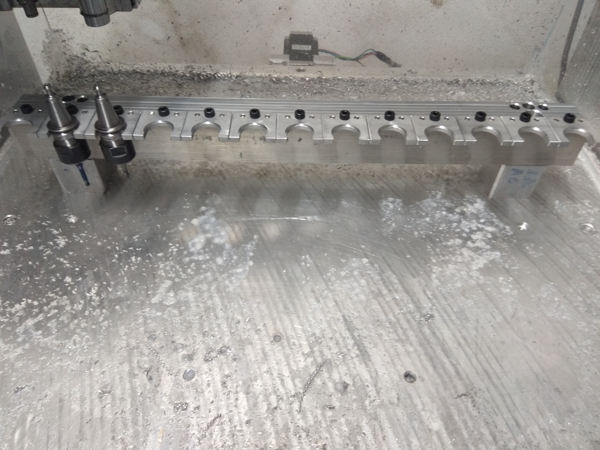

Hello,
I installed a fixed tool changer, how can i configure linuxcnc to change?
Best Regards,

Replied by tommylight on topic Fixed Auto Tool Changer
I think that can be done in gcode alone, but i never did it so i can not help more.
Remap should also work easily and using digital in/out for the pneumatic cylinder.
Writing a comp for it would be the best choice.
In theory that is the easiest tool changer to program in my opinion.
Write down how the procedure for a tool change should function, maybe we can help more.

I try to use the racktoolchange from simu but when i write T1M6 the start button of linuxcnc activate but it doesn't do nothing.
No one have rack tool change working?????

That should work nicely, but it is a simulator so you need to edit it to control the machine.
That implies editing the hal and ini files to point them to the outputs for your motor drives, and edit the positions and height of your tool rack.

Replied by andypugh on topic Fixed Auto Tool Changer
Not doing nothing is good. What things does it do?
It sounds like it is waiting for an input pin to trigger.
Or it might be that it simply isn't finding the G-code subroutine.
If you start LinuxCNC from the command-line you might see an error report there. (to start LinuxCNC from the command-line, just type "linuxcnc")

I do "T3 M6"
and get this output:

and linuxcnc stays with start icon on forever.

I suspect that LinuxCNC is setting the "tool prepare" pin, and your toolchange system is not asserting the "tool prepared" pin.
For a rack toolchanger this probably just wants to be a HAL short-circuit.

How to check if it's that or not?
14 Nov 2018 09:56 #120657
Halmeter would show you if the tool-prepare pin is going true.
Looking at your HAL file would tell you if there is anything to then set the tool-prepared pin.
