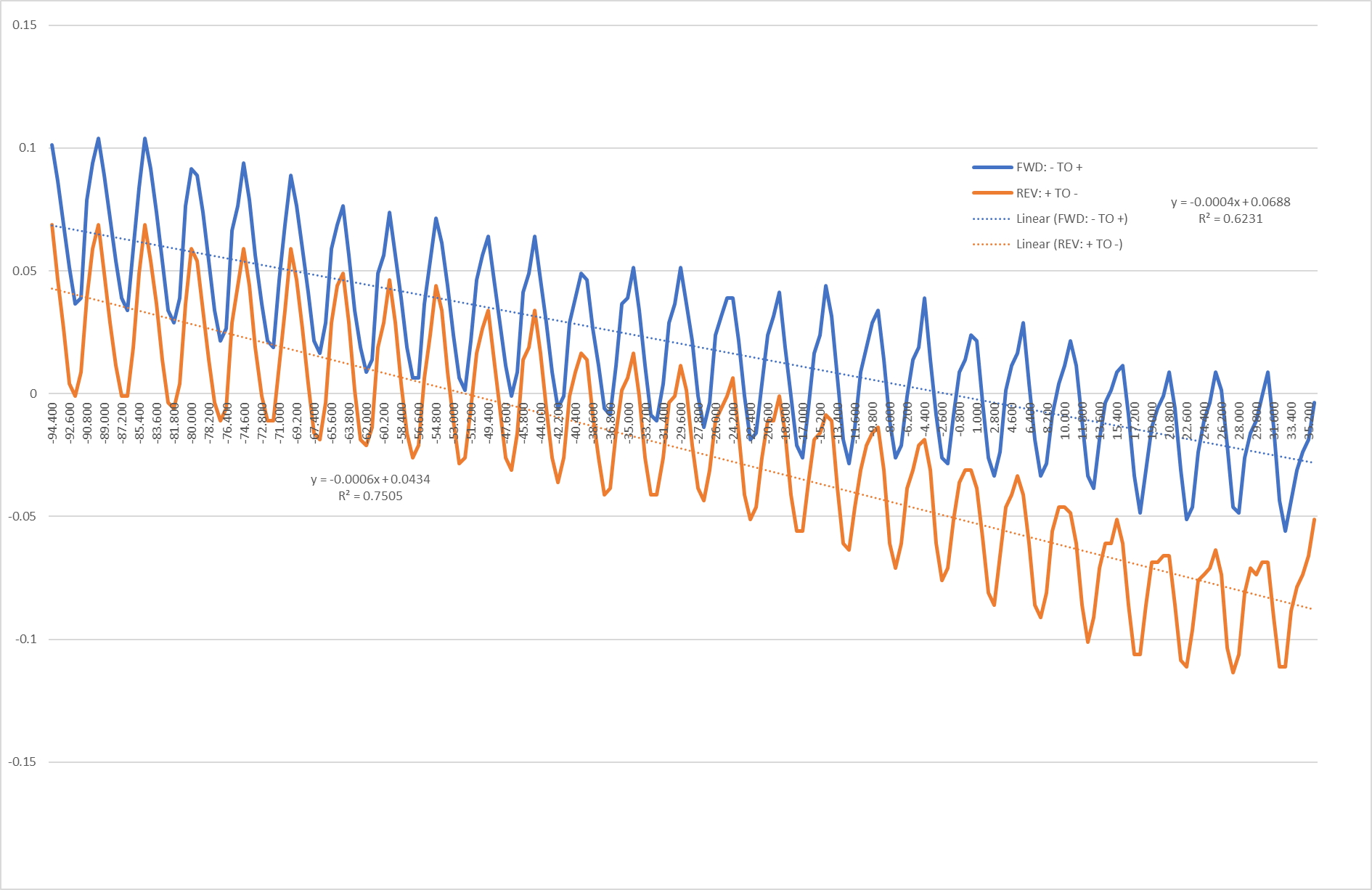

19 Feb 2020 05:42 - 19 Feb 2020 06:01 #157812
by Nitram
Replied by Nitram on topic How to map a ball screw?
Hello.
I just wanted to provide feedback to users regarding the ballscrew mapping I have done.
My lathe has C7 rolled ballscrews and by the process of ballscrew mapping and creating a compensation file, I think I have a achieved a significant improvement in linearity and accuracy.
One thing to note, the reference measuring device for the ballscrews are permanently mounted glass scales which read the axis position directly i.e. reading head mounted to the movable axis itself, scale mounted on the machine. That said, the results can only be as good as the resolution and linear accuracy of the scales themselves, but I think it is reasonable to assume that they are far better than the C7 ballscrews and backlash free.
Firstly, the G Code to write positions to a file. Note that the machine derived X axis position comes from the machine's calculated position and in this case, the glass scale position comes from Analogue input 00. The file created is saved into the config folder. I have opened the file using the LOGAPPEND command, and placed keywords at the start ("forwards") when the axis is moving int he positive direction and "reverse" to differentiate for the compensation file. Using LOGAPPEND, the G code can be run several times and glass scale position averaged for better results as each sucessive run will be appended onto the end of the existing data in the file, with the keywords enabling the user to identify where each new data set starts and where the axis reverses itself for the return run.
Make sure the X position values are the same for the forward run and the reverse run. This will enable you to place the actual (glass scale) position alongside the nominal (machine axis) position for both forward and also reverse (nullifying backlash). Divide the extreme travel of the axis by 256 to determine the increment of successive position. The comp file can only handle 256 data points. It is best f the data points are not "in harmony" with the natural pitch of the screw as this could cause missing a latent cyclic trend in the ballscrew. In other words if you have a 5mm pitch ballscrew, do not set the increment to any round multiple of 5mm. In the example G code below, with 10mm pitch ballscrews, a sample was taken every 0.6mm.
Before running the G code, ensure that the backlash in the .ini file is set to zero.

Note that this is where the keywords (start/forwards/reverse) are important, so you can decipher the data. The first part of the file sampled the data points forwards, the second part of the file (after the reverse keyword) sampled the same data points with the axis running in reverse.
Excel is your friend here to now construct the comp file. Note that sometimes excel/word/other programs will put latent unwanted characters into a file. These may have to be replaced with the find and replace function (eg. in word the hidden "line end" character may have to be copied into the "find and replace" function of word, replace it with nothing and thus be deleted from the file. Another good way is to copy from Word into a pure text file, which do not usually have such latent characters).
You will need to create the comp file with the following format:
Nominal position <space> actual forward position <space> actual reverse position
Noting that what we have measured directly from the glass scales IS the actual forward and actual reverse position listed alongside the nominal position. Thus it should be pretty straight forward to copy and paste the three data columns alongside each other to make up the comp file.
Name the comp file anything you wish. In my case I chose the suggested and unexciting x_comp.comp
Save the file into your config folder.
Adjust your .ini file to reflect the inclusion of a comp file for that axis
e.g.
COMP_FILE = file.extension in my case x_comp.comp
COMP_FILE_TYPE = 0 defines the type of comp file, in this case per the "nominal forward reverse" syntax (as mentioned above)
Remembering to "comment out" the backlash settings with the # symbol... # BACKLASH = <whatever your setting is>.

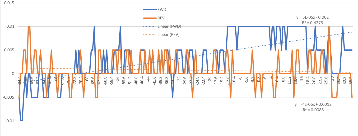

Both before and after this process, I graphed the results. The graphs are attached and are best viewed as "wide" as possible because they are rather "long" in ratio to their height.
In the "before comp" graph, one can see a gradient in the linear line of best fit. This indicates that according to the glass scales the ballscrew has a general trend of shortening up. Further, this is reflected both in the forwards (blue) measurements and the reverse (orange) measurements. Additionally, one can see that approx. 5mm intervals there is a cyclic peak/trough. Remember this is a 10mm pitch ballscrew so this is not surprising and speaks to the fact that data samples should _not_ be a multiple of the pitch to help identify these cyclic trends. Also note the difference between the forward and reverse lines at the same nominal data point. The difference being backlash.
Refer now to the "after comp" graph. This is the G code sampling program run after the installation of the comp file. Note that the vertical axis divisions are much finer than on the before comp graph so don't let that fool you. One can clearly see that the lines of best fit are now MUCH more linear, meaning that the effect of the ballscrew "shortening up" has been removed, and secondly, one can see that the average of the two lines (forwards and reverse) are largely co-linear, meaning backlash has been largely removed along the entire travel. On average, actual position deviation from nominal has been reduced to being within .005mm at the vast majority of data points along the axis length.
Whilst this is a fairly long winded post, the actual doing of this procedure is only about 2 hours (subject to how fast you run the feedrate in the G code test). I hope it serves to illustrate the power and flexibility of a comp file and Linuxcnc in general. Furthermore, I think that it has improved the accuracy of the C7 rolled ballscrews in my lathe immensely!

After implementing compensation in the system, the results are fine like i said. But when i do some movement like going forward from a point and returning to that point(the point is any point between positive and negative limit), i am not able to see exact same point. Some difference exists, and i think it is about backlash. It looks like backlash still exists in system.
I am really wondering about this, have you tested your system like mine? Are you getting same results like me? For me, i might understand compensation file's purpose wrong. It is not fixing backlash in little steps. It fixes it in whole path. I mean going to 0 from 40 then going to 40 from zero. What is your recommendations or ideas?
Thank you.

Andy, grateful if you could expand on this assumption. As per experience or theoretically? Reason I ask is because I run *.comp type 1 on all axis and getting near industrial accuracy on a low-grade XYZ stepping driven milling machine with X0.054, Y0.065, Z0.071 backlash. Test part attached, features validated on the CMM at the company, certificate output = 0.004mm (max). Further down is a 20pts back & forth motion validation from a 1um calibrated glass.
Could the difference be that the compensation was acquired 255 times using a zigzag pattern? e.g. 2, 0, 4, 2, 6, 4, 8, 6, 10, 8.... ....
Replied by Mecanix on topic How to map a ball screw?
But backlash can never be properly compensated for unless the cutting forces are always in the same direction.
Last edit: 12 Mar 2024 14:20 by Mecanix.

Interesting. Compensation for X & Y was measured with the table preloaded. As in, having the usual and heavy fixturing/clamping gears (+10%) that it normally sees during production. That solved the non-linear backlash error part.
In my case anyway, and regardless of the force/direction/cutting method, that backlash is applied when motion reverse and translates snugged. Confirmed with the parts I've made so far. Also confirmed with "joint.0.backlash-corr".
Thinking about it though, you're right, might be a whole different story for those feather light machines, particularly those on linear rails...
