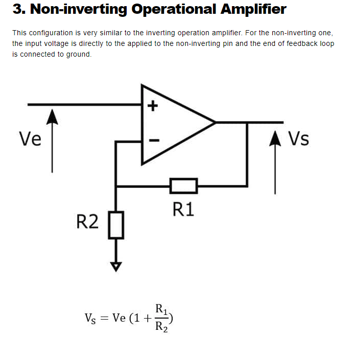

30 Mar 2019 14:35 #129969
by 3D-Master
Replied by 3D-Master on topic Pololu G2 current sense output for Spindle load meter?
i breadboarded it but it doesnt seem to work (no reaction to when i try to stall the motor, except when i touch the motor housing i see a little bit, but the Current sensing output does definately output correct). Either the opamp is defective or i wired something wrong.
5 V to the + pin (8), ground to the - pin (4), current sensing pin to non-inverted-input a (3) and output a (1) to my oscilloscope (negative of the oscilloscope to ground)

30 Mar 2019 18:16 #129985
Replied by andypugh on topic Pololu G2 current sense output for Spindle load meter?
An Op-amp always needs a pair of resistors to set the gain.
Nothing will happen without those.

30 Mar 2019 21:00 #129991
by 3D-Master
Okay i think i got it working. I wired the opamp according to this site: www.learningaboutelectronics.com/Article...g-op-amp-circuit.php and now i can see change with my oscilloscope. Is it normal that it is not a straight line but zigzag like? Probably can be filtered on the analog in i guess.
Thank you for your help
30 Mar 2019 22:33 #130002
If the input is smooth then the output should be smooth. It really should just multiply the input voltage by a gain factor.

30 Mar 2019 23:02 #130003
by 3D-Master
yeah i looked at the current sensing output and it is zigzag aswell (probably because of the pwm signal)
30 Mar 2019 23:20 #130006
Probably something most easily handles with a HAL lowpass.
