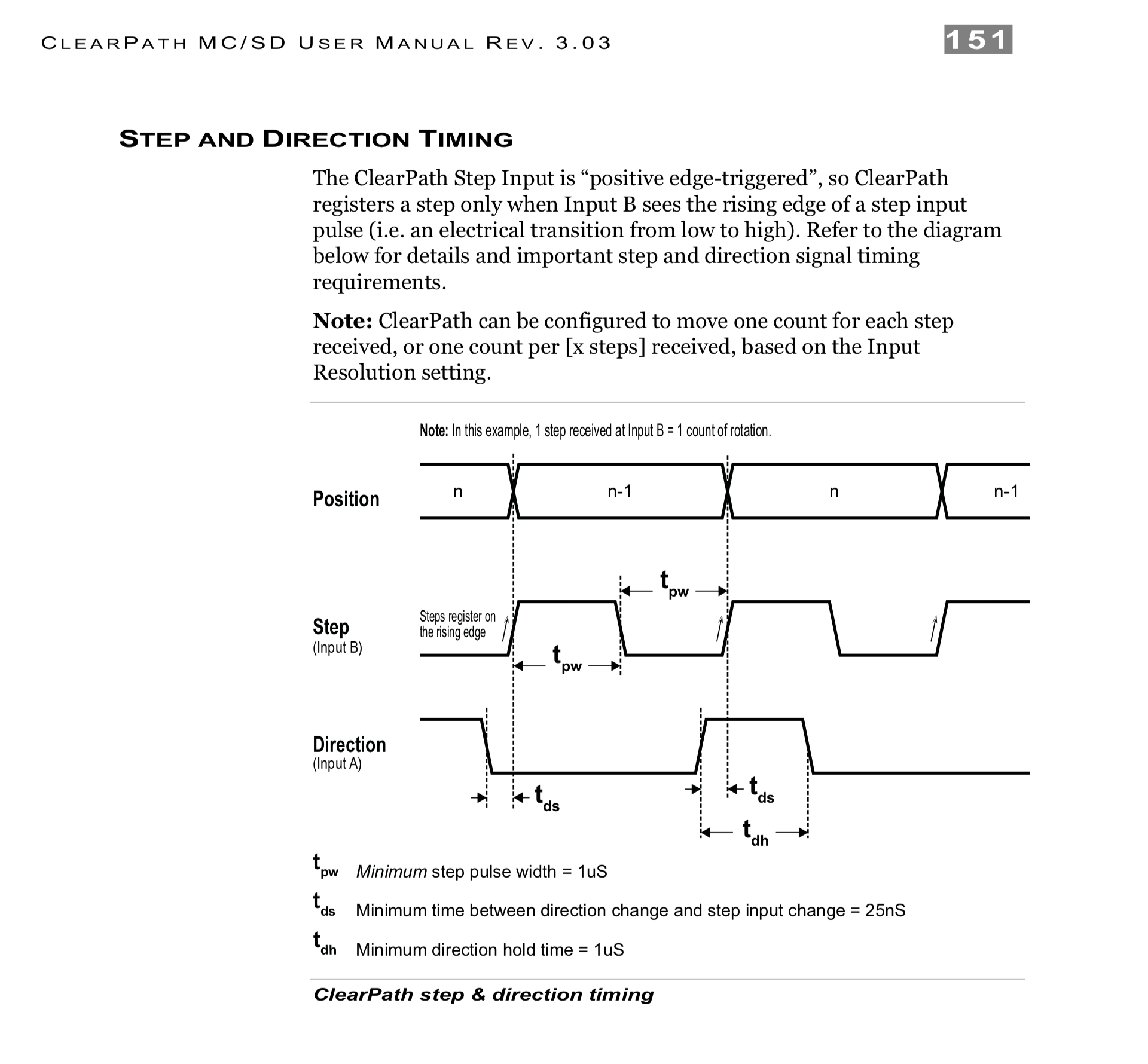

The important thing is that you set your minimum step timings correctly in your configuration and you shouldn't have any problems.
I would use:
Step Time=2000
Step Space=2000
Dir Hold=50000
Dir Setup=2000
These are double the specified minimums in the Clearpath manuals. If those timings are too restrictive for your machines performance (can't go fast enough) you could try 1500 and 30000, but I don't think I'd fully trust a whole lot less.

Clearpath User Manual
Relevant page:
The step pulse timing is specified separately for each axis in your .ini file like so:
I think DIRSETUP could be 25ns instead of 1200
As for getting the distance per step right, you simply enter pulses per unit (in. or mm) as the SCALE parameter in the .ini file:
I use inches, the motor is directly coupled to a 0.5" pitch lead screw, and the Clearpath motor is set to 3200 steps per revolution
Negative SCALE reverses the axis direction
6400 pulses move the axis 1 inch. Backwards.
Relevant page:
# these are in nanoseconds
DIRSETUP = 1200
DIRHOLD = 1200
STEPLEN = 1200
STEPSPACE = 1200I think DIRSETUP could be 25ns instead of 1200
SCALE = -6400Please Log in or Create an account to join the conversation.

Quite right. I had each timing value set to 200 ns...
Replied by thadwald on topic Which mode is best for new setups?
I believe Thadwald ran into trouble because he didn't bother changing the settings from his old config after upgrading.

what scale are these numbers in?
Step Time=2000
Step Space=2000
Dir Hold=50000
Dir Setup=2000
For instance Thad said 25ns instead of 1200, so is 2500 = 25ns?
And when he had 200ns was his setting 20000 instead of 20ns 2000?
Just trying to get a clear picture.
Step Time=2000
Step Space=2000
Dir Hold=50000
Dir Setup=2000

LinuxCNC's step timing numbers are all in ns so 2000 is 2000 ns or 2 us
There is no disadvantage is setting the direction setup and hold times quite large
( 10000 ns will work with almost any drive and has no real impact on performance )

OK thanks Peter. So Thad's issue was that he had these values way too small and this was causing his missed steps. I will try the suggested values:
Step Time=2000
Step Space=2000
Dir Hold=50000
Dir Setup=2000
Do you think this is a good starting point for my Clearpath servo motor or should I go higher?

The numbers are in nanoseconds.
Making pulses too short will cause the signals to fall outside the range of the Clearpath specs and it recognizes it as noise (my problem). Making them too long will impose a speed limit on your motor because the longer the pulses, the fewer of them you can send in a certain amount of time. With 4000ns step + space and 800 pulses per revolution on your motor, this speed limit is 18,750rpm.
The numbers will work fine.
