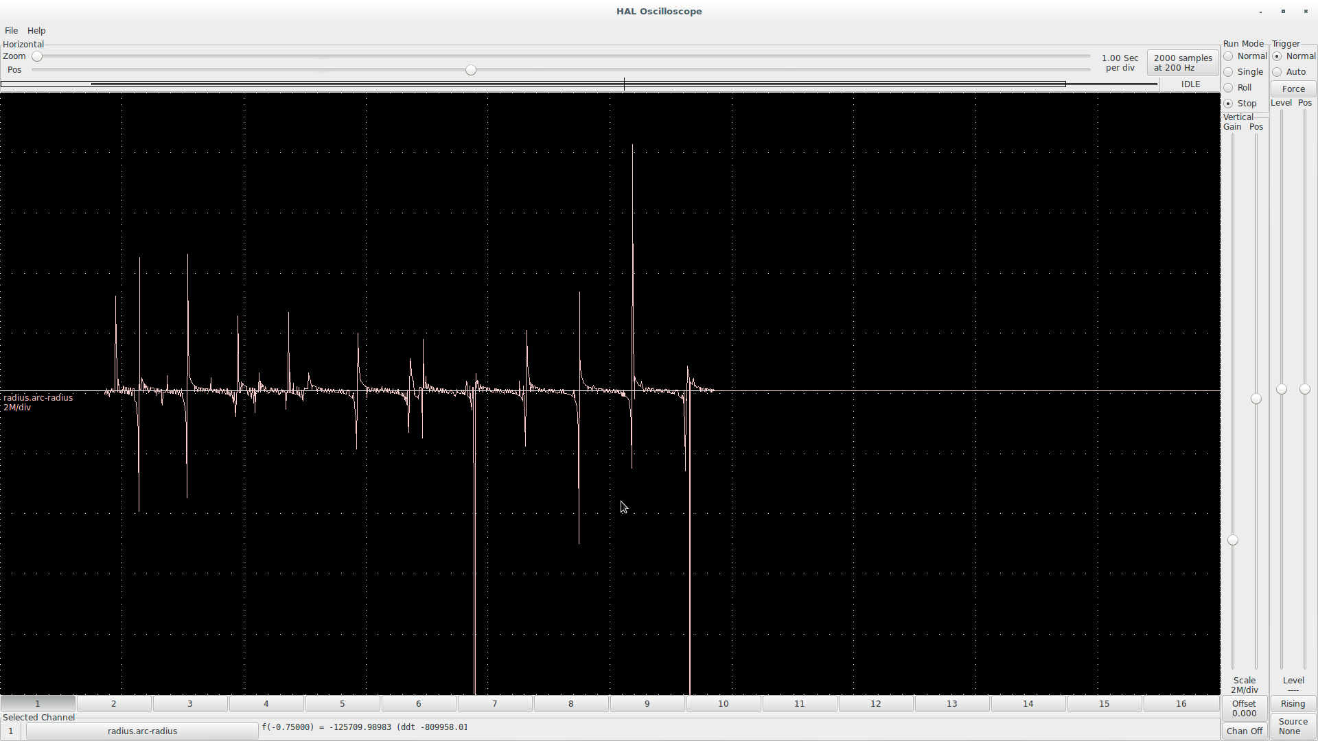

Replied by rodw on topic Can a component know the diameter of an arc its cutting
ANdy thanks. The calculated velocity agrees pretty much with motion.current-vel which remains constant (variance about +- 0.1mm/sec)
I started to play with Halscope but ran out of time.
Looks like we need to revisit the formulas somewhere or filter out the spikes somehow.
I think I have a logic error calculating the change in heading so I'll dig in hal scope a bit further

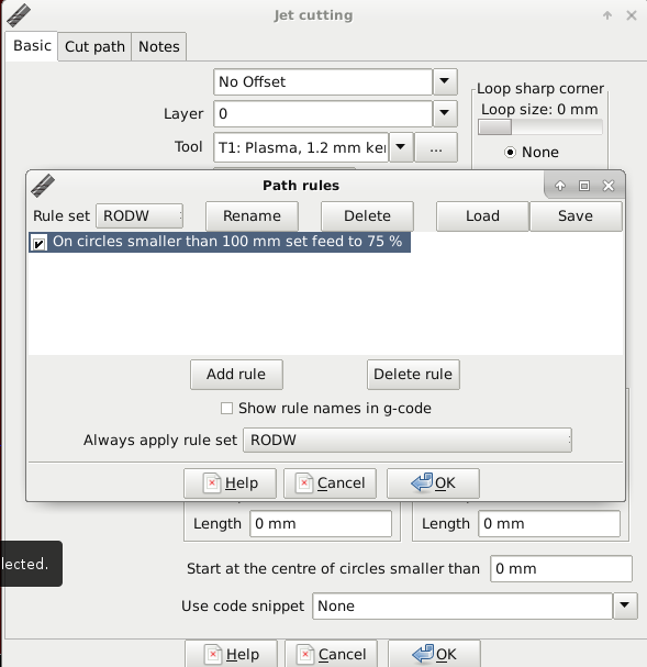

Yeh, I think there is an error in the way I calculate the difference between the heading rate of change but I've not found it yet as I ran out of time util tonight. All of Andy's other maths is working as it should I think so there is only one other factor to debug.
The idea I had was for LinuxCNC to apply something like Sheetcam's cutting rules automatically to manage hole and radius cutting as I have not had that much luck using the cutting rules. If the algoritihm had say material and thickness data available, it could become quite sophisticated in its approach. A linuxcnc version of truehole technology without resorting to a Hypertherm CAM system.
Anyway, it will be cool if it works!

Okey apply them.
And check this one for applying them global

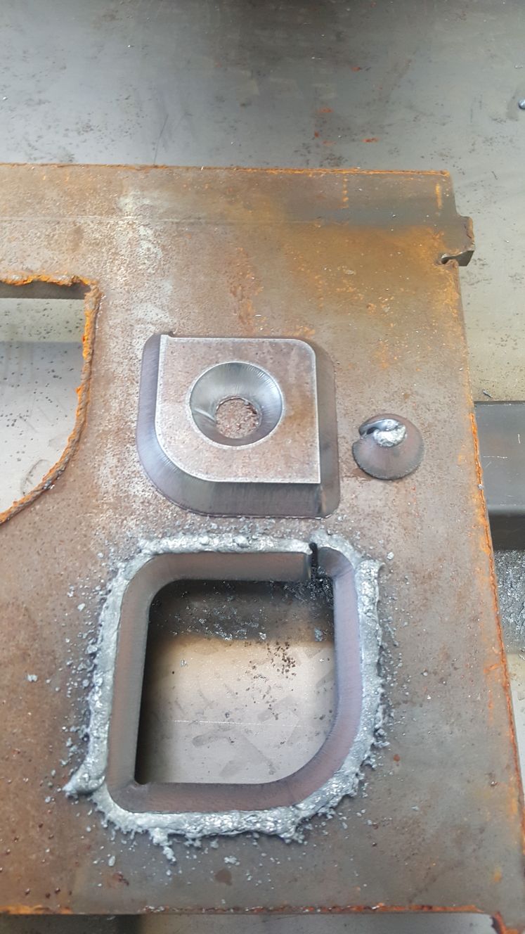

But when you want to do something like this to avoid some pierces
and you add a fillet on the entrance to the slot, you are dealing with arcs, not holes, I don't want to slow down on the entrance but I do on the arc for the hole. (Hole is cleaned out with a drill). And yes to be able to prototype on 16mm steel with the Thermal Dynamics 120 amp machine.
I was unable to get Sheetcam to exclude the fillet from the cutting rule. I could edit the Sheetcam POST but this is an interesting way forward.

Row if you cut this at 120 amps 700mm/min you are master kenobi but only with water table to avoid to much heat in the product what will be negative for accuracy. Will result in 1 to 5 mm material stretch at your product in worst case and will form dirty toxic smoke flue gasses for serrounding guys if no exheast blower is mounted inside the factory.
What you can do is make a liitle water table of sheet metal 70mm water height. Plate bottom into the water. Cut the same parts you shown. You will be amazed if you use my specs.
