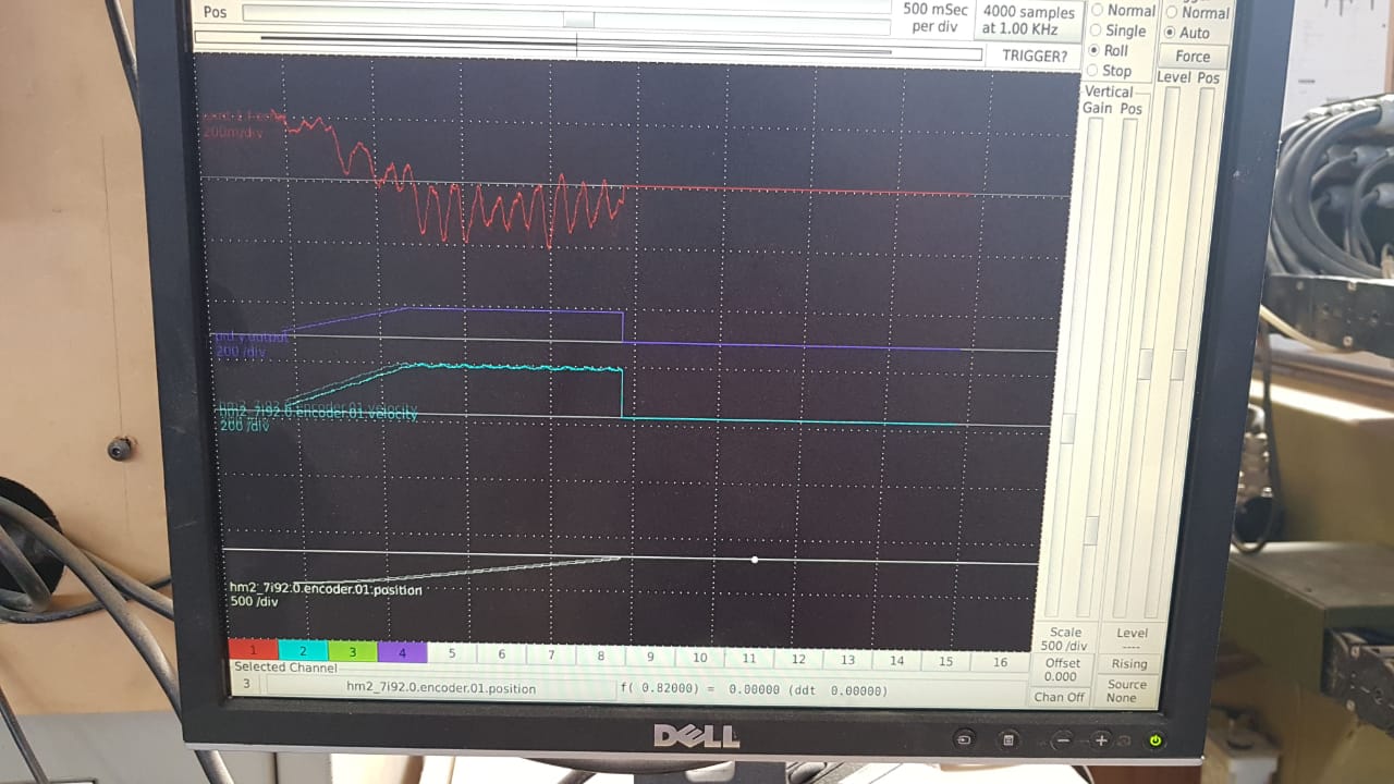

Hi, here are my hal and ini files.
I am unfortunately not at the machine for the next two weeks, but I will see if i can get my assistant to post the halscope graphs.
My graphs do however look similar to the one below.
Also I am basically using the machines original wiring (twisted, shielded) and have tried extra grounding wires to see if I can eliminate noise, but no real difference.

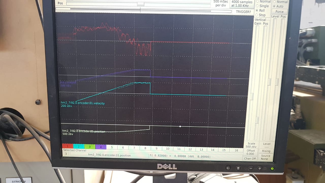

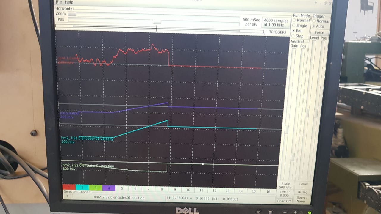

I got my assistant to send me some videos and pics if it would help at all.
And here are some youtube vids:
#https://www.youtube.com/watch?v=g8ef7SHEHwI&feature=youtu.be
I know the quality is not great, but it shows what I have been dealing with.
I could get the tuning better, but not much really and it never seems to be consistent.

- Posts: 18104
- Thank you received: 5328
22 Feb 2019 19:06 #126933
Replied by PCW on topic Need help with tuning Midi Drives with Metador Motors
If you look at the PID output in the plots, it does not seem that LinuxCNC is generating the oscillation (the PID output is almost flat relative to the velocity feedback), this suggests that the issue is with the drives velocity mode tuning, or some other motor/drive/tachometer problem.
