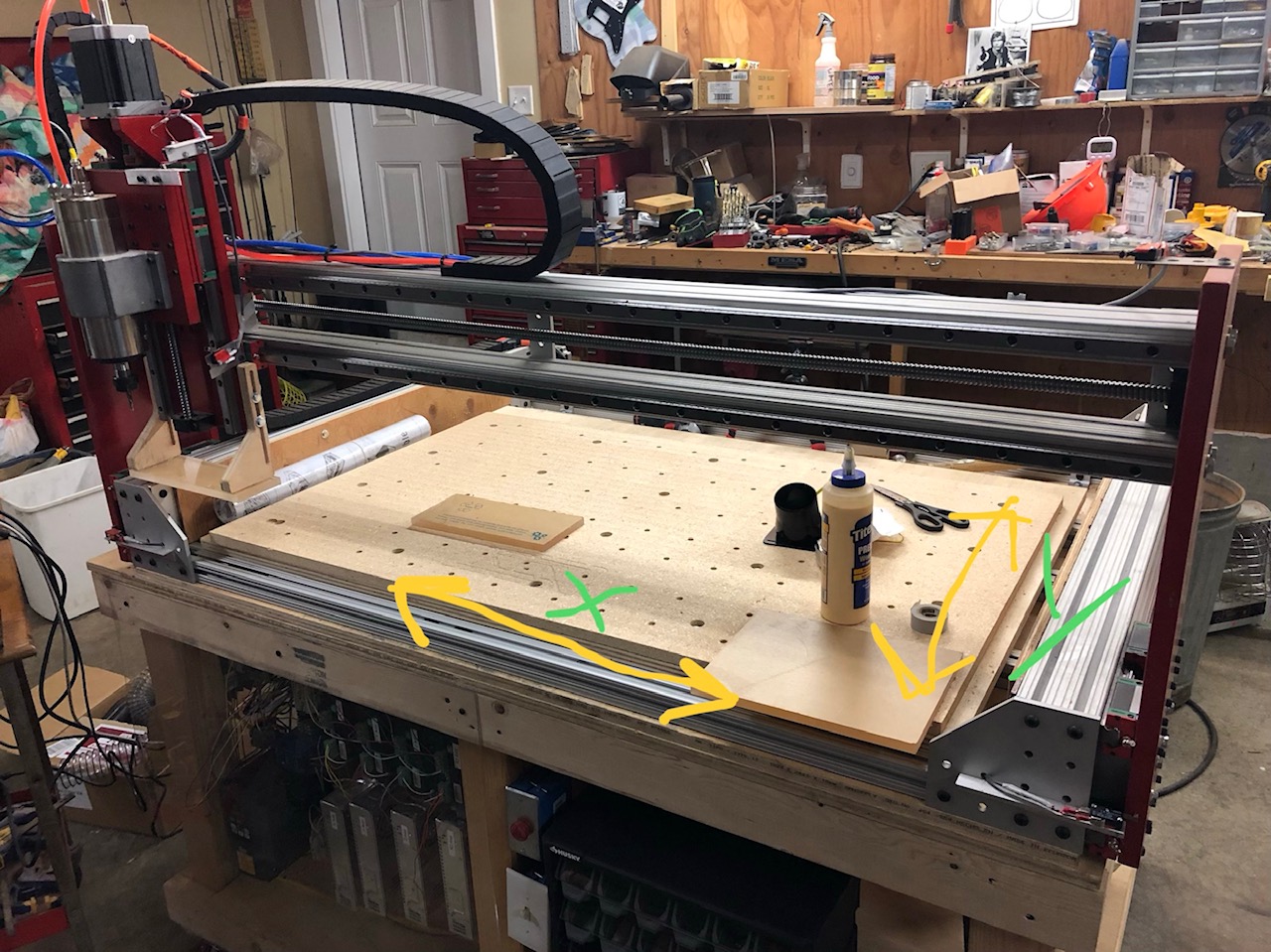

Hoping to get some help with an issue I'm having. I built a CNC with dual Gantry Axis and Single axis for Z and Y(?)
When I built the machine I thought that I had my XYZ Configuration correct....
Long Story Short I have a nice working machine that Homes and does not miss steps.
The problem is I set it up Dual X Axis motors (Forward/Revers) that travel the Gantry. and Y Axis that goes Left to Right.
Z Axis Up/Down.
This config is causing me headaches in Fusion 360 as the X and Y are opposite.
I've tried Post Processor Edits (Flipping X and Y) but this caused Radius issues...
I then thought I would just Re-Work my HAL and INI file to Change from XXYZ to XYYZ Config... Simple right?
I edited my Joints and cannot find anything wrong in my setup. With my XXYZ setup homing and everything works but as soon as I change my HAL and INI to my XYYZ edit Nothing Works....
No homing or Jogging on any axis. Nothing moves....
Any ideas? No Errors on start up. And When Homing it shows Z try to move in Program but No Movement....
INI and HAL Files Posted Lower with Pic of Machine for Reference.

02 Mar 2019 13:52 #127498
Replied by tommylight on topic XXYZ vs. XYYZ Changes - No Motion after Hal and INI Changes
Double post !
The first attachment is empty.
- pl7i92
- Posts: 1872
- Thank you received: 358
02 Mar 2019 14:04 #127504
by pl7i92
Replied by pl7i92 on topic XXYZ vs. XYYZ Changes - No Motion after Hal and INI Changes
why at all changing the INI
only the HAL needs to be chasnged in pinout
- Posts: 21980
- Thank you received: 7480
02 Mar 2019 14:07 #127505
Ini has to be changed !

I'm sorry about the double Post. I didn't think it posted. New to the Forum. It was waiting for Moderator. My Bad.
Thanks for the Reply's. Some how the files I attached were empty. Linux to Windows Issues I guess...
Anyway here are the HAL and INI files Before and After Trying to change from XXYZ to XYYZ.
I am just copying the text into the files to make the change and then it does not move. I can Paste the old files back in and it works normal.
In order of XXYZ.hal Working, XXYZ.INI Working, XYYZ.hal Non Working, XYYZ.IN Non Working
Thanks for your time and help.

- BobBobberton
- Posts: 8
02 Mar 2019 17:19 #127521
by BobBobberton
Replied by BobBobberton on topic XXYZ vs. XYYZ Changes - No Motion after Hal and INI Changes
I got this files posted now on this board. Thanks
I will post a pic of machine for reference.
- BobBobberton
- Posts: 8
02 Mar 2019 17:20 #127523
by BobBobberton
- BobBobberton
- Posts: 8
02 Mar 2019 18:09 #127526
by BobBobberton
Replied by BobBobberton on topic XXYZ vs. XYYZ Changes - No Motion after Hal and INI Changes - SOLVED!!!!
I found my problem finally.... I missed my enable output. Yenable was not recognized after changing to Y1 and Y2.
Changed to xenable and all was well in the World.
See below
*ORIGINAL*
setp parport.0.pin-01-out-invert 1
net spindle-pwm => parport.0.pin-01-out
net x1step => parport.0.pin-02-out
setp parport.0.pin-02-out-reset 1
setp parport.0.pin-03-out-invert 1
net x1dir => parport.0.pin-03-out
net x2step => parport.0.pin-08-out
setp parport.0.pin-08-out-reset 1
setp parport.0.pin-09-out-invert 1
net x2dir => parport.0.pin-09-out
net ystep => parport.0.pin-04-out
setp parport.0.pin-04-out-reset 1
net ydir => parport.0.pin-05-out
net zstep => parport.0.pin-06-out
setp parport.0.pin-06-out-reset 1
setp parport.0.pin-07-out-invert 1
net zdir => parport.0.pin-07-out
net estop-ext <= parport.0.pin-10-in
*******net yenable => parport.0.pin-14-out
net spindle-on => parport.0.pin-17-out
*WRONG*
net y1step => parport.0.pin-02-out
net y1dir => parport.0.pin-03-out
net y2step => parport.0.pin-08-out
net y2dir => parport.0.pin-09-out
net xstep => parport.0.pin-04-out
net xdir => parport.0.pin-05-out
