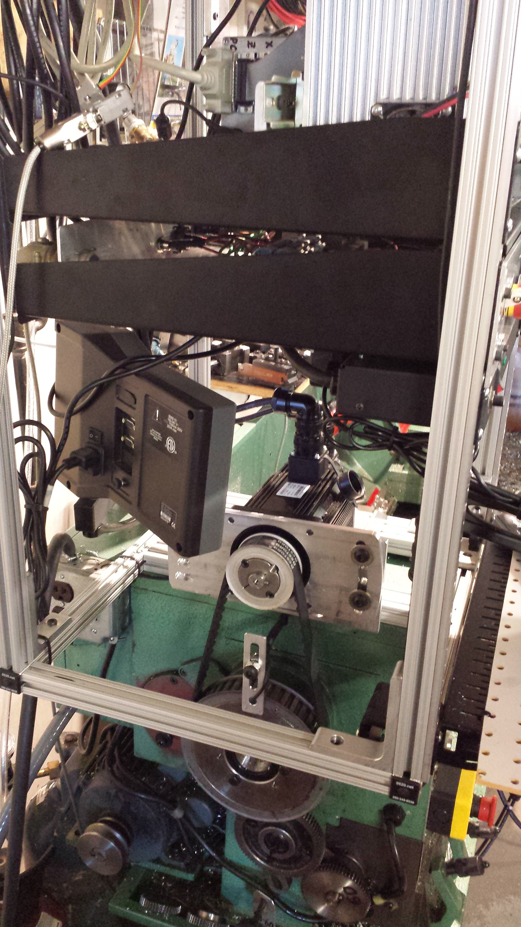

Yes, that's reasonable. Whatever you can signal in stepgen position-mode should be feasible to signal in velocity-mode.
If the motor is 600ppr, that implies 600ppr * 1200rpm / (60sec/min) = 12 kHz, which is typically a feasible base thread. Base thread rates are not the problem.
The China servo controller you're using appears to be configurable for quadrature step signals, which would double the top speed to 2400rpm (assuming you were using step/dir signals when you proved 1200rpm).
This should be solvable with a correct HAL configuration of stepgen.
Another feasibility constraint that should be preached about the servo-based spindle motor concept: Position-mode PID servos are theoretically limited to low inertia (some small multiple of the rotor inertia), low spring, and low backlash in the driven mechanism. If you encroach those limits the position will not be stable, and instead the resonance or hysteresis spoils the stability (the spindle won't hold still, or hold a steady rpm, it oscillates at a low resonant frequency). This is an inherent problem to PID and can't be tuned out. In your small milling machine the spindle inertia is not a worry. But if you try to do this on a lathe, position-mode PID servo control typically can't work because the spindle inertia is huge (massive chuck and pulleys with large diameters, and springy timing belts, are mandatory elements), well out of the servo stability envelope. This lathe spindle problem is inherent to lathes, where the concept is to spin the heavy work and workholder, and not the lightweight/compact tool, the inverse concept of a mill.
