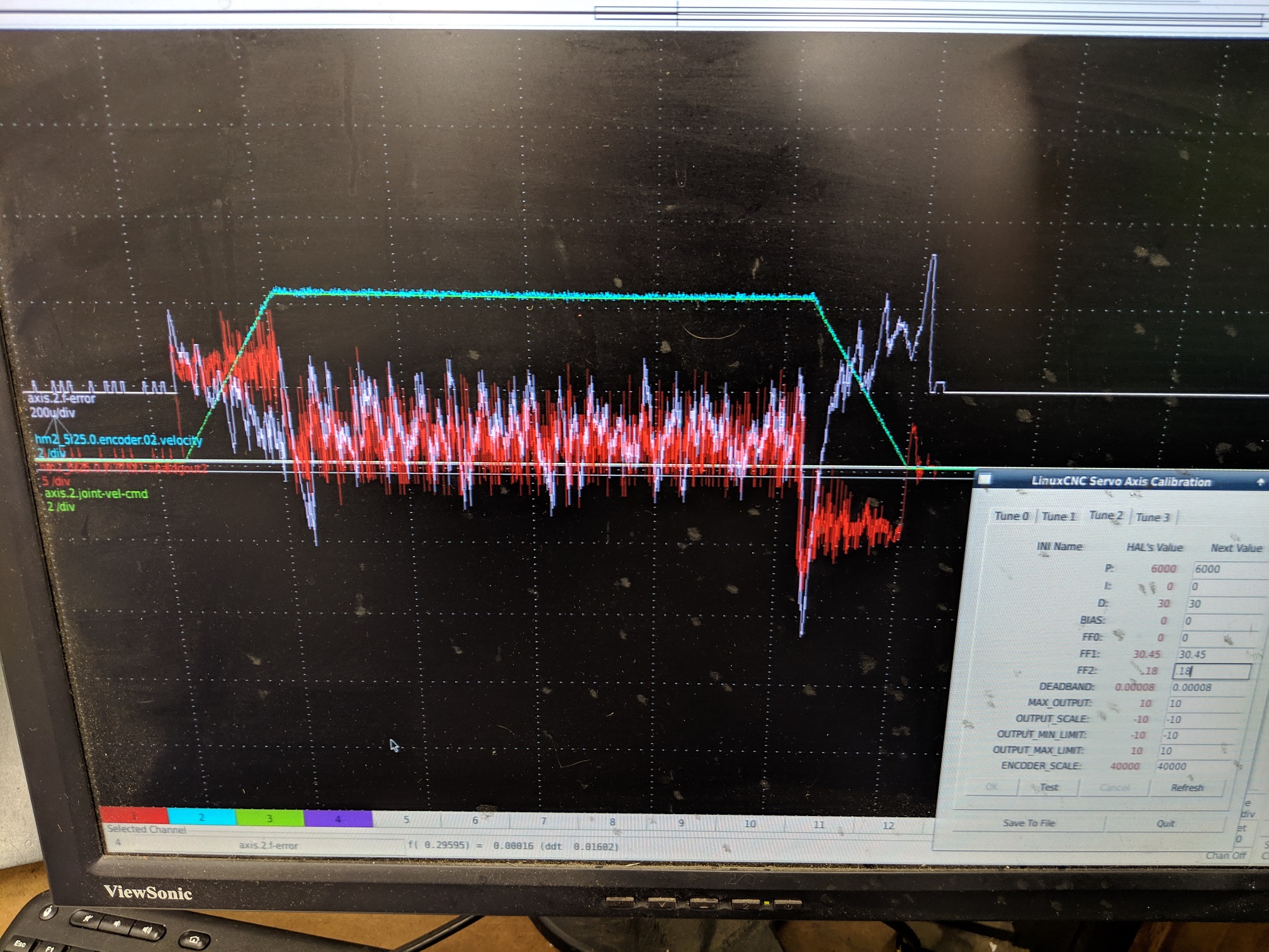

Here is a picture of my Z axis tuning plot and pid settings. Andy told me on the IRC a few months back that this was tuned tighter then he could have bothered. :laugh:
Im curious to see your error plot.

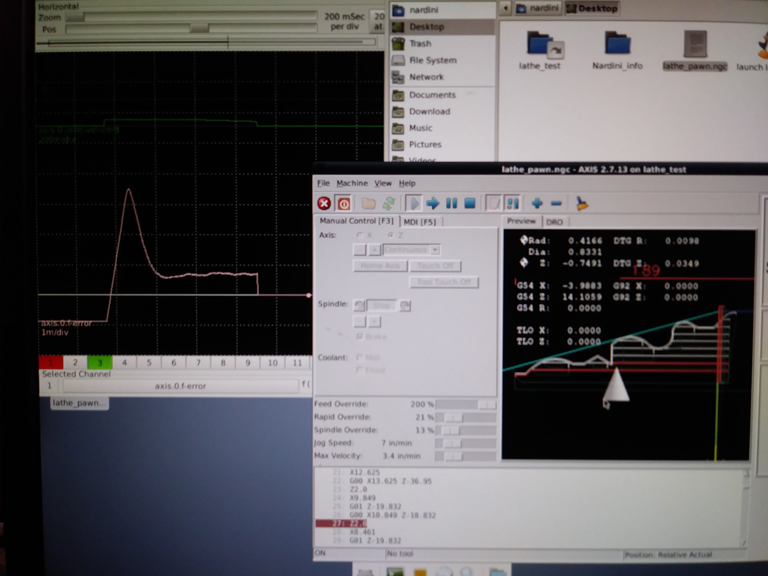

Here's the following error on the X axis. This is done by jogging with the "+/-" buttons in Axis.
Note the following error before and after the command... Before is above, after is below. Also, the overshoot at beginning and end are asymmetrical.

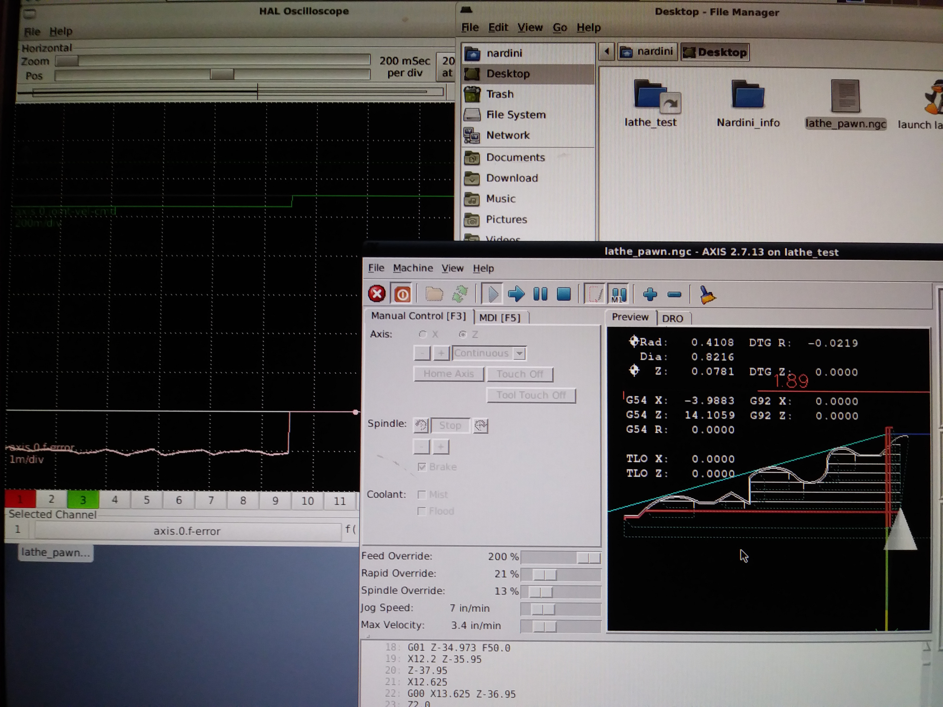

Hmm. I ran a modified version of the lathe_pawn example, and the following errors there are quite significant.
I'm at a bit of a loss as to what I should do here. Maybe scrapping this and going for the torque mode is the next step...

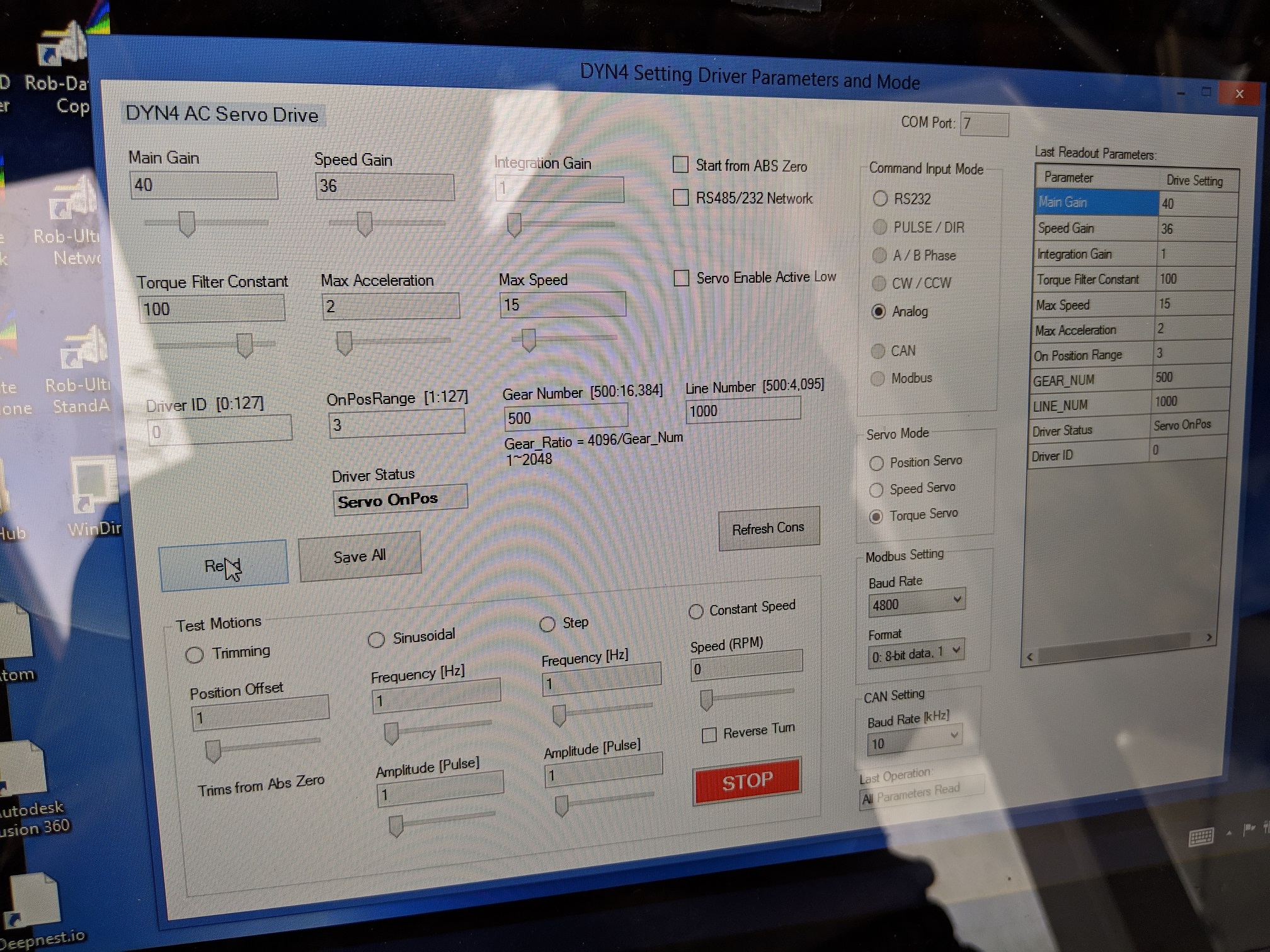

I asked DMM some questions regarding the issue. Followings is the reply:
Hello,
The tuning of the drive is all the same no matter the final operation mode.
I assume you already ran through the auto tuning from the program, correct?
If the motion is not ideal, you can let us know the problem and we can advise to adjust the Gain parameters manually.
You can also use the Test Movement in the parameters screen and set the movement to Step and increase the amplitude to maximum so the motor moves 45degrees at 1Hp. Then change the parameters while the motor is in motion so determine the best settings.
Normally for a lath the Integration Gain is set to 5 and does not need to be changed. Keep Speed Gain a bit lower than Main Gain and increase/decrease these two parameters until the motion is stable. For example, start with Main Gain at 10 and Speed Gain at 8 and increase until the movement is rigid.
I really don't dig the concept that the tuning is the same for separate modes. Really, the target market for these is probably those who will utilize the step/dir or serial command capabilities.
I'm going to attempt to tune up the "Torque" mode and see if I have better luck there.

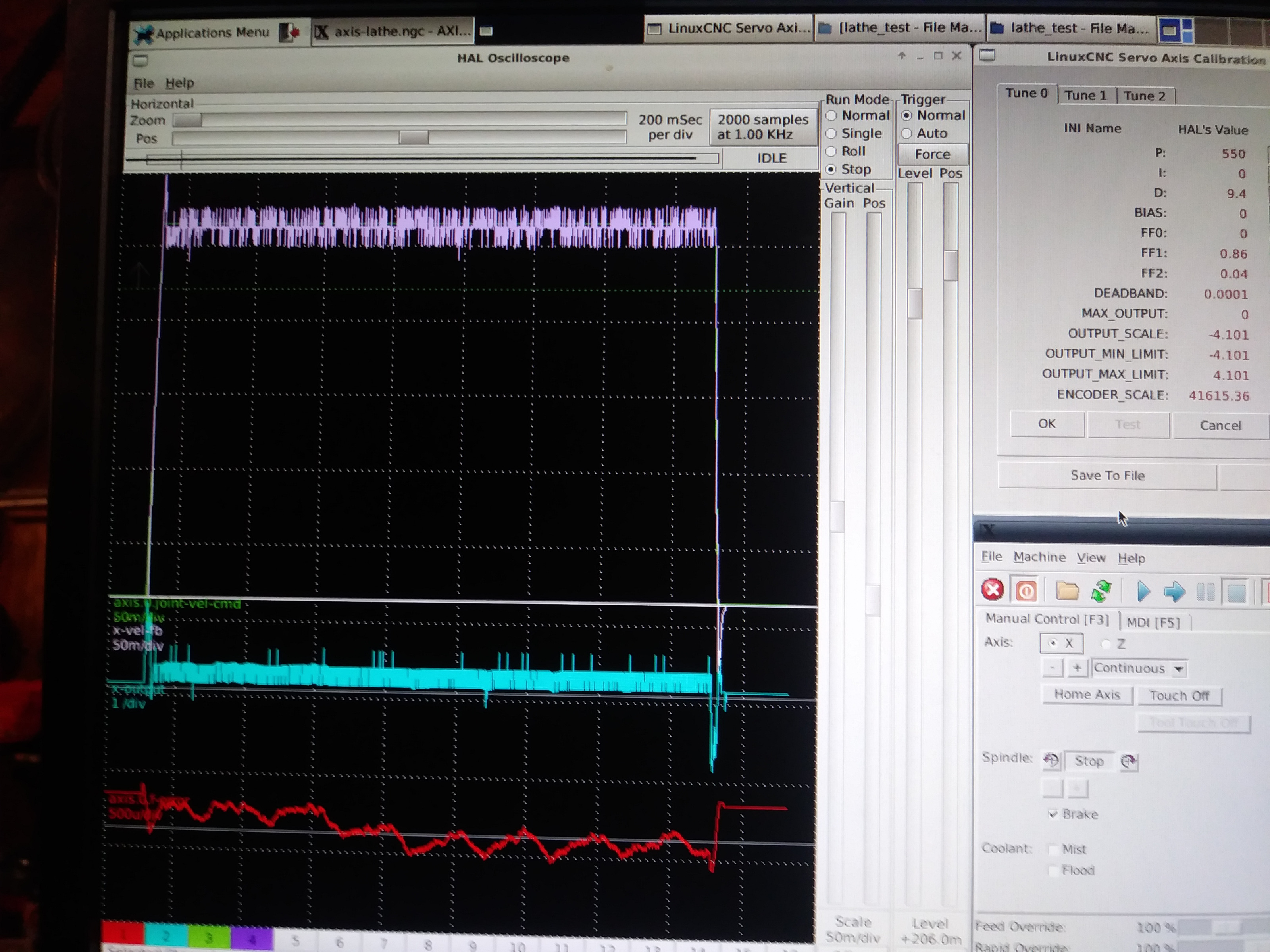

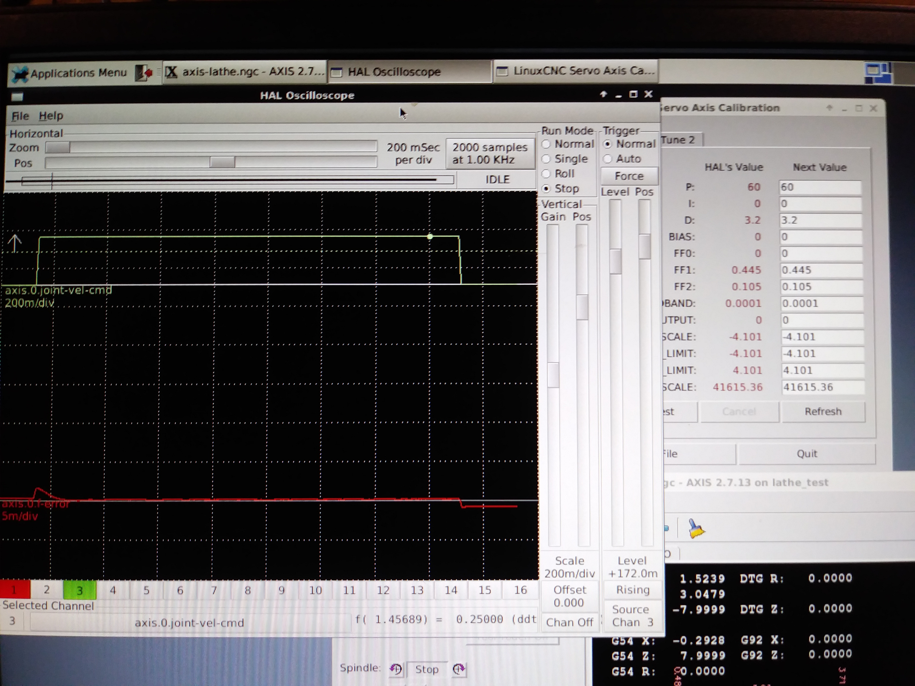

I set up the X axis as torque mode, and so far it's gone a lot smoother.
Attached is how far I've gotten in LinuxCNC. One thing that is persistent in all is the flatline f_error both before and after jog motions. Am I missing something here? Is it a tuning issue or an artifact of jog motions vs MDI?
(purple = vel-fb, overlayed on green = joint-vel-cmd, blue = output, red = f-error)
