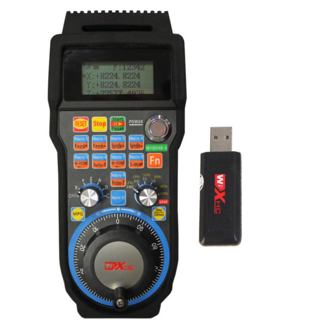

Hello everyone,
Can i seek a help for configuring this hand wheel ?
I am fine if not all the functions are working, i just want co ordinate display and Jog Axis and Speed Selector with handwheel.
If any leads in 2.7.14 version ?
i tried to install as per this wiki link wiki.linuxcnc.org/cgi-bin/wiki.pl?Using_...Wireless_MPG_Pendant
i am not able to install this two components, throwing invalid IP address in terminal.

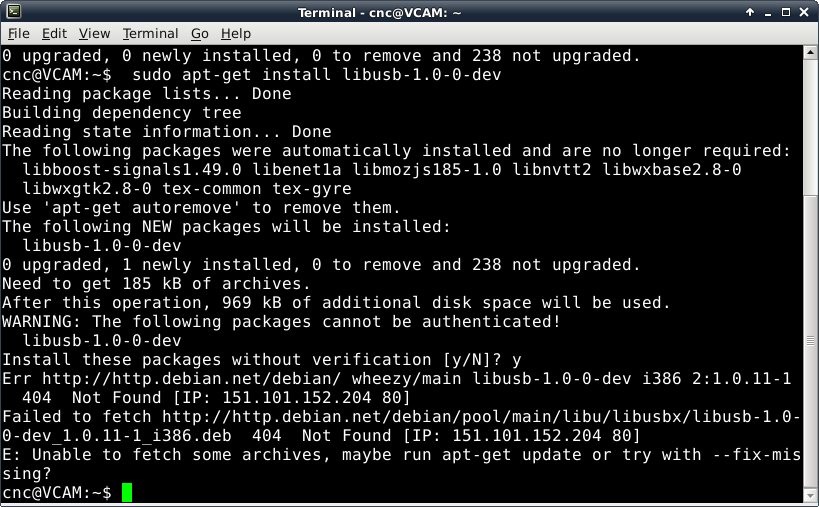

15 Apr 2019 11:30 #130899
by marq_torque
Replied by marq_torque on topic Difficulty in configuring WHB04B-4
This is ss of error when i try to install "sudo apt-get install libusb-1.0-0-dev"

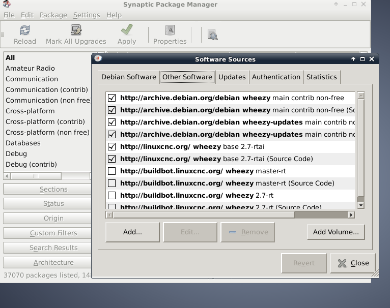

16 Apr 2019 01:37 #130955
Replied by tommylight on topic Difficulty in configuring WHB04B-4
You need to run
sudo apt-get update
before installing as it looks like the sources list has not been updated and the old servers are not in use any more.
sudo apt-get update

17 Apr 2019 14:59 #131052
by marq_torque
I Tried that but always failed with above error. i tried in diffrent system and fresh installation also but failed. Showing above IP error.

23 Apr 2019 19:31 #131681
by marq_torque
Brilliant as always Andypugh it worked for this "libusb-1.0-0-dev" problem .... tonns of thanks
