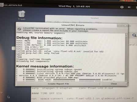

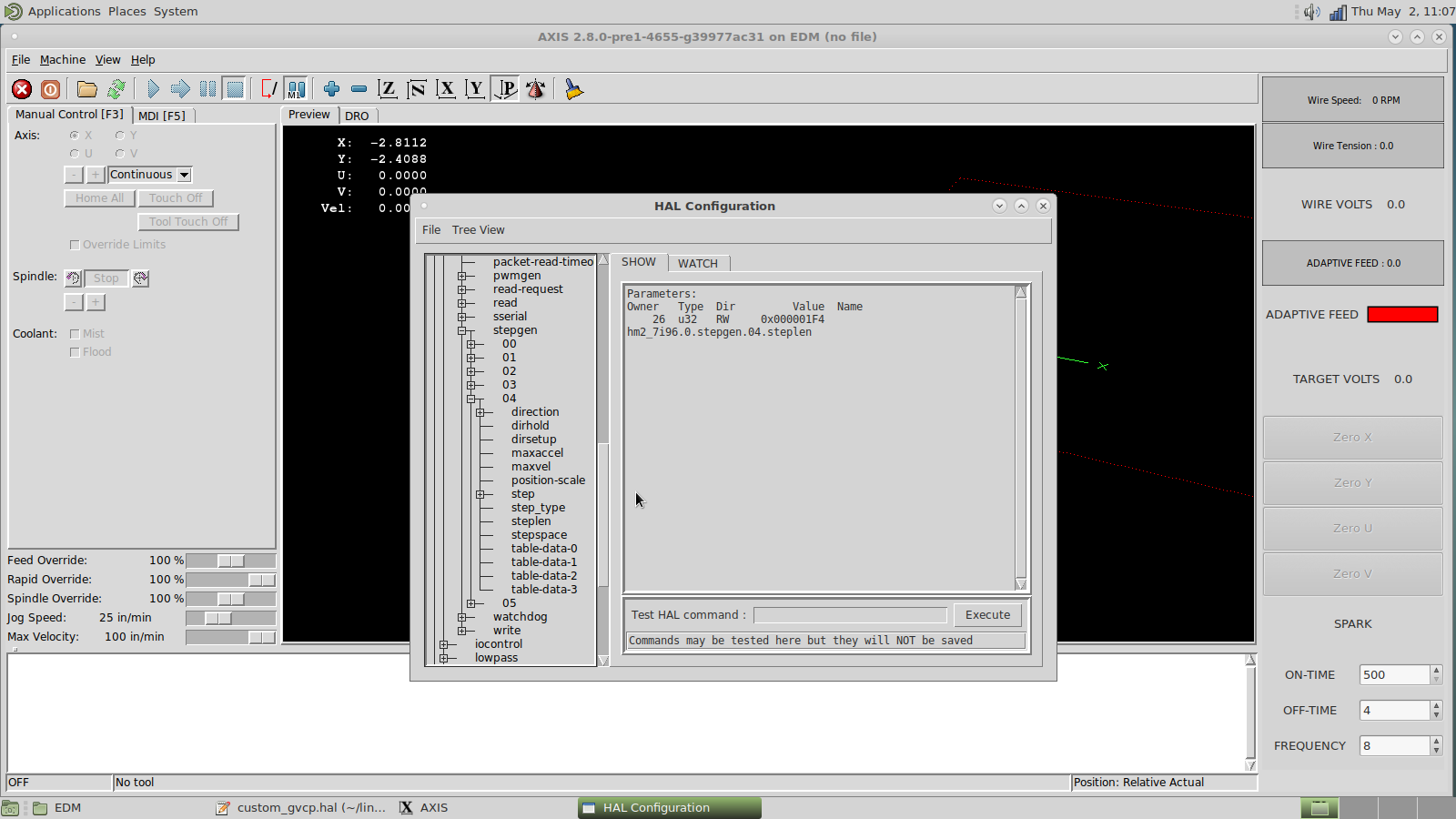

error photo

It's better to copy and paste the text if possible, I can't quite read the error photo but it might be a type error like trying to use a float where it should be u32 etc.

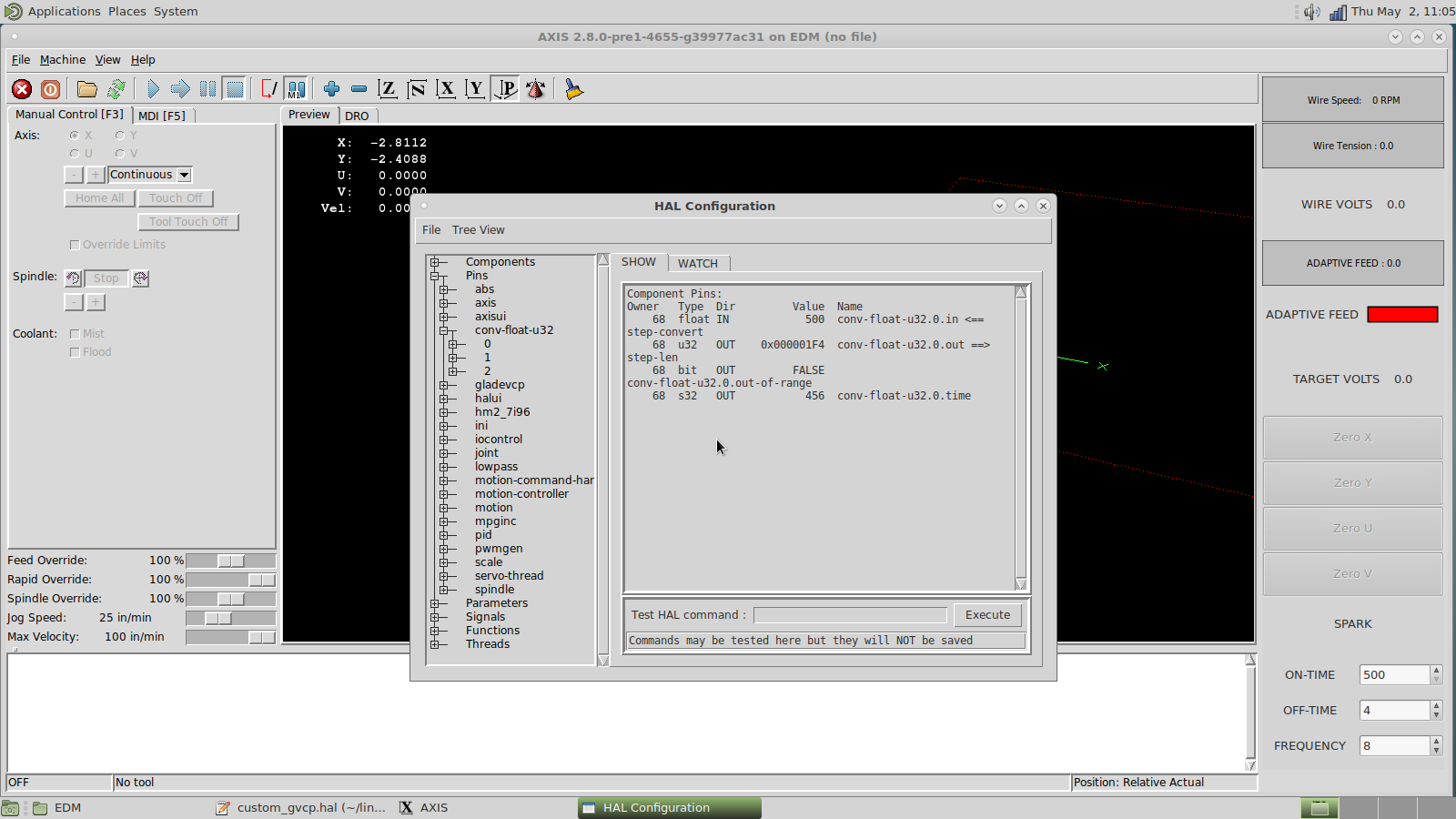

yes , I've done that and found a comp called conv-float-u32 to convert the float to u32. It doesn't seem to do the job or I'm implementing it wrong. If I comment out the error line and run and read the hal I can see that it does convert to u32 . but I still get the error that the value ' conv-float-u32-0-out ' is invalid for U32

No way to guess what the problem is unless we can see the hal line, the input value and the exact error.
linuxcnc.org/docs/devel/html/man/man9/conv_float_u32.9.html
But I'm going to guess anyway that the input value is not in the range of u32. An unsigned 32-bit integer has a usable range of zero to 4,294,967,296.
JT

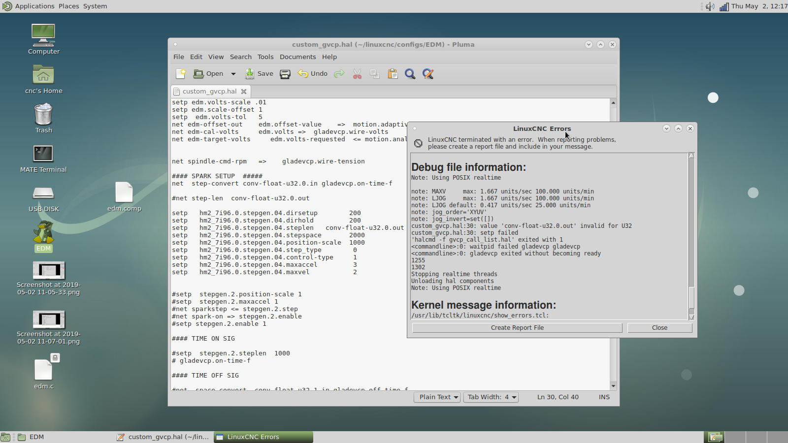

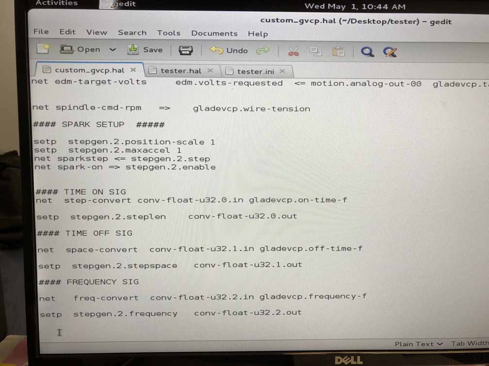

I'm getting the same error as you testing here so I'm assuming you can't set a pin using the output of a function probably because the hal file is read before the thread is run.
JT

Setp takes a numerical value.
It makes no sense to use setp in the way that you are.
All that you need to do is use "net" instead of "setp" and to create a new signal name to link the result.
net signal1 some-pin conv_float_s32.in
net signal2 conv_float_s32.out some-other-pin

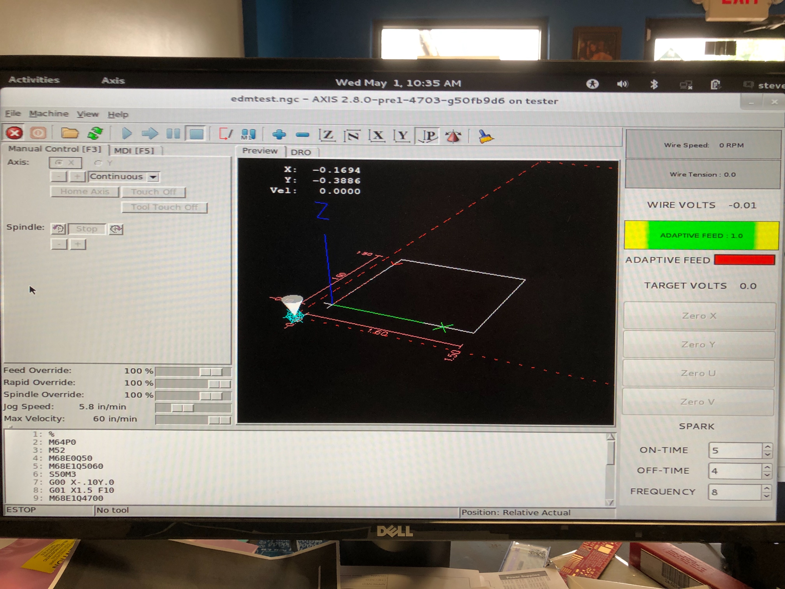

So I've tried that and get a error that steplen pin does not exist. Could you give me a example how would you go about connecting a gladevcp spinbox to a spepgen steplen parameter? What I'm trying to do is control the length of the on time on a stepgen to control my mosfet board in my wire edm spark box. And then us velocity to control the frequency in which its happening. The times can be anywhere from 40 milliseconds up. Right now I have a arduino doing that. I'd like to have linuxcnc do it all if possible.
